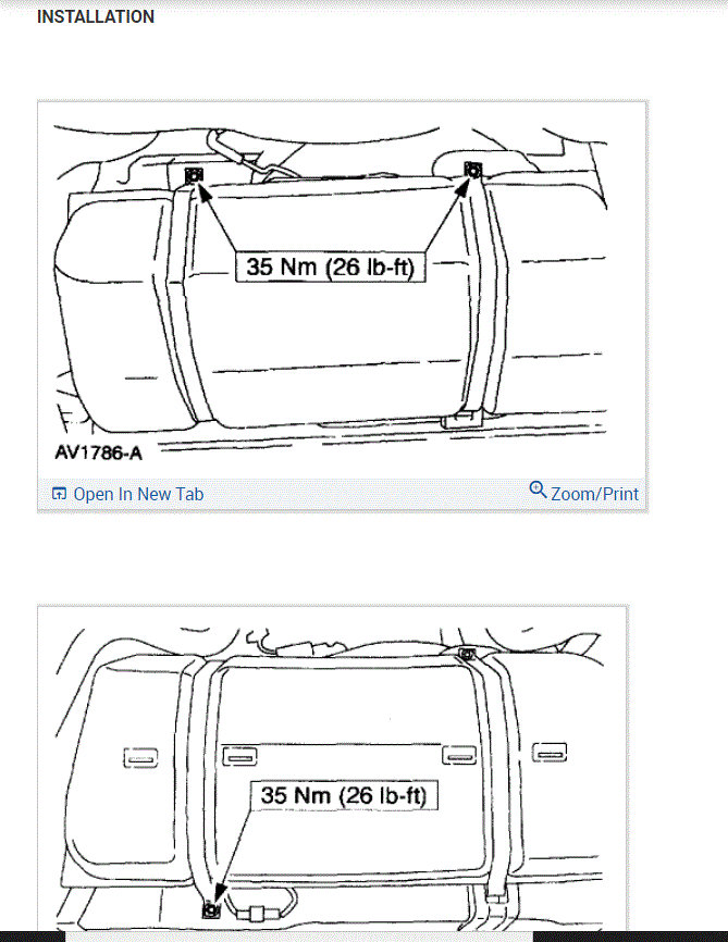

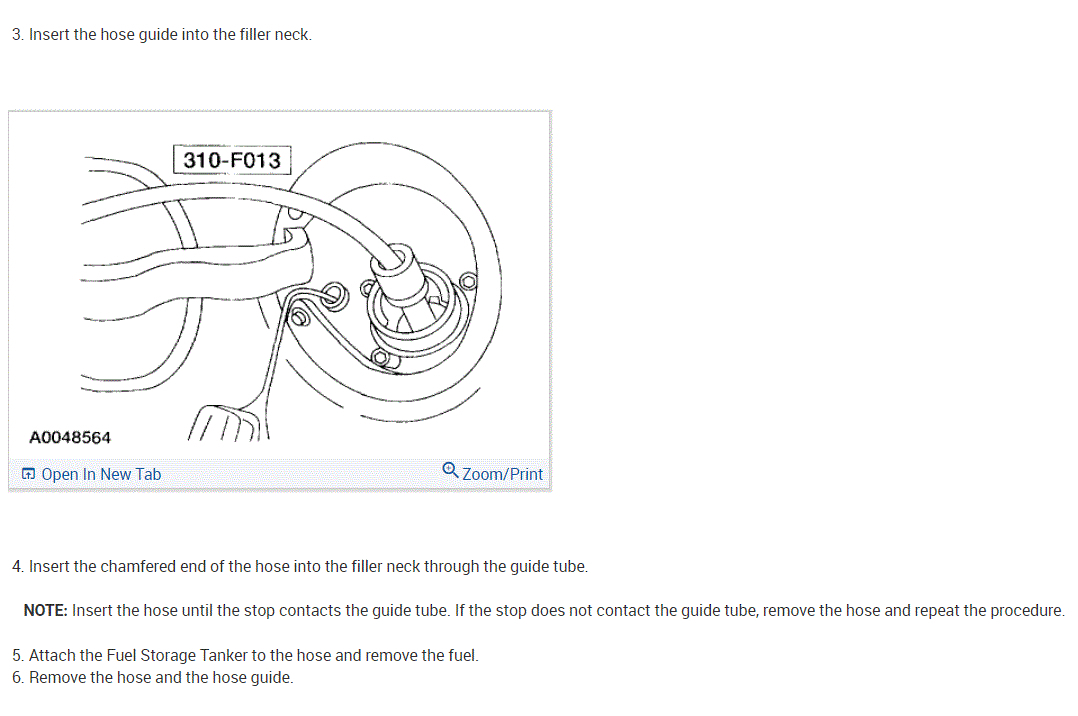

I need to replace the fuel pump but the tank is filled. I can't get a tube down into the tank so as to siphon the fuel out. Any ideas on how i could remove the fuel before i drop the tank?
