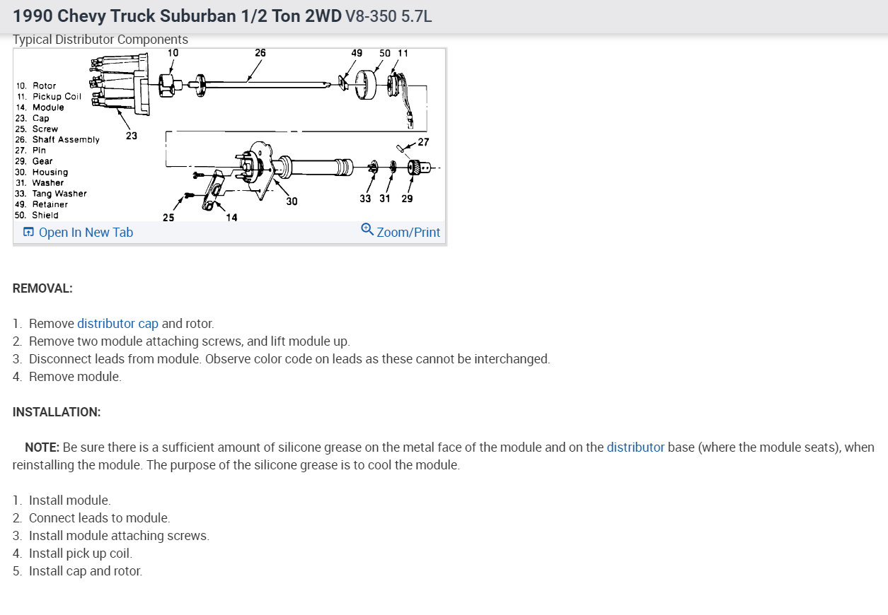

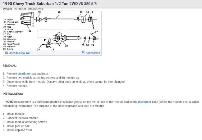

Yep, the electronic spark control module controls the injector pulse, this is where I would start here is the location in the diagrams below. Also, have you run the codes? Please follow this guide to run the codes:
https://www.2carpros.com/articles/buick-cadillac-chevy-gmc-oldsmobile-pontiac-gm-1983-1995-obd1-code-definitions-and-retrieval-method
Check out the diagrams (below). Please let us know what you find.

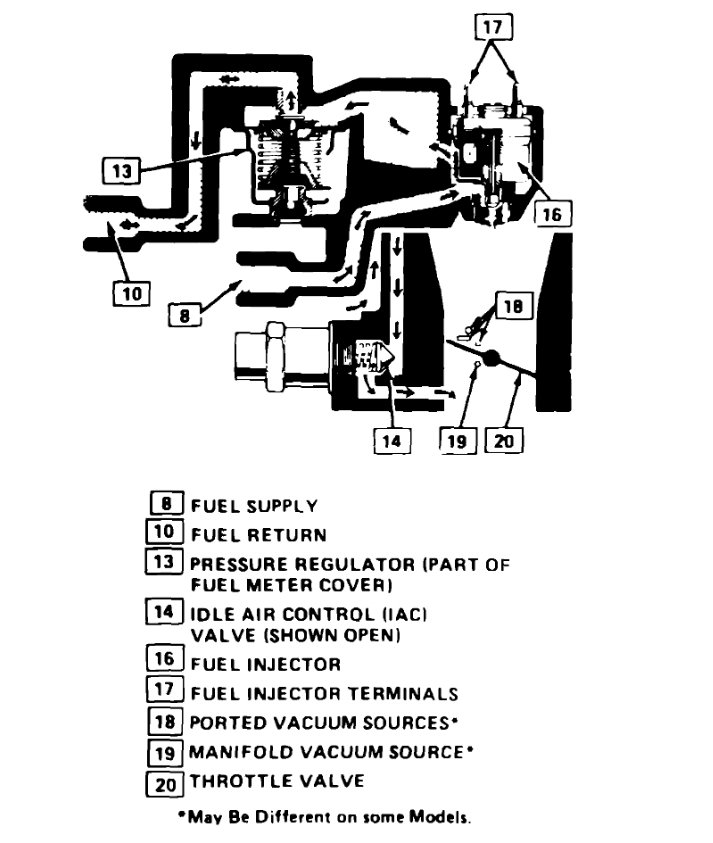

Only the pump can cause low pressure from the tank. There is however a fuel pressure regulator inside the fuel injection throttle body. Check out the diagrams below. Did you use an AC delco pump?
