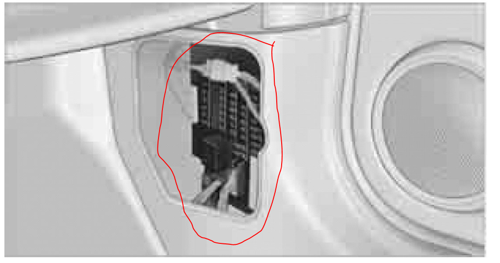

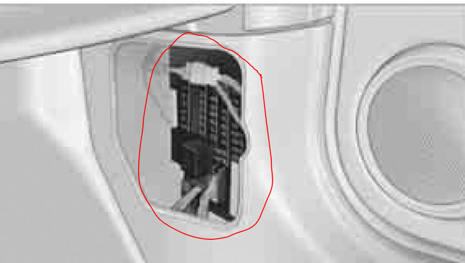

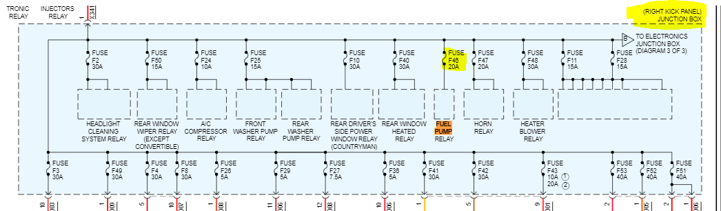

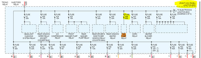

I only found one fuse, #46 for the fuel, 20 amp, good on both sides. Checked rear fuel tank pump on rear passenger side under the seat. No power, only 2 grounds with ignition on, and a 3rd that gives me beeps and .2 oe .3 without stating what it is, and sometimes i touch it and it gives me nothing, maybe this is the signal wire, the 4th gives neither power nor ground. Could not see a relay, diagram in back of cover shows pictures of fuses ok ly, there is only one relay on bottom part of fuse box. Can you find out where the relay is? Has to be a relay or a fuse box issue since am not letting power. No fuel comes out of front, no sound from pump, switched it with my friend's pump and same results.
