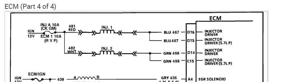

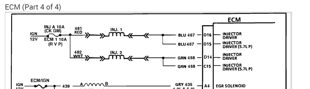

If you have fuel pressure to the throttle body injectors, either there is a wiring issue, or the ECM has failed. Each fuel injector is a solenoid-operated device controlled by the ECM. If you look below, you'll see that the ECM is what controls the injectors.

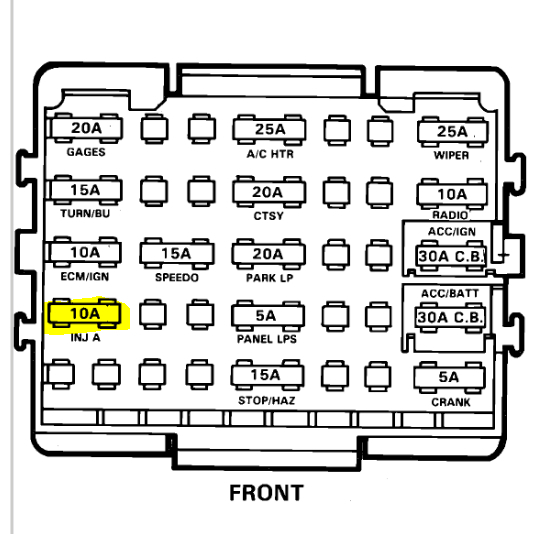

First, check the inj A fuse. See pic 2 for the location. When you check the fuse, also confirm there is power to and from it.
