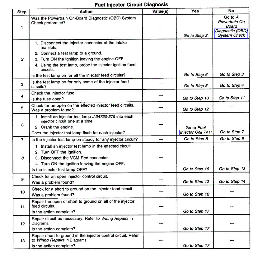

If you have fuel pressure and the ECM is new and doing the same thing, we likely have a wiring issue. Take a look at the diagnostics below for the injector circuit and let me know if you are comfortable performing the tests.

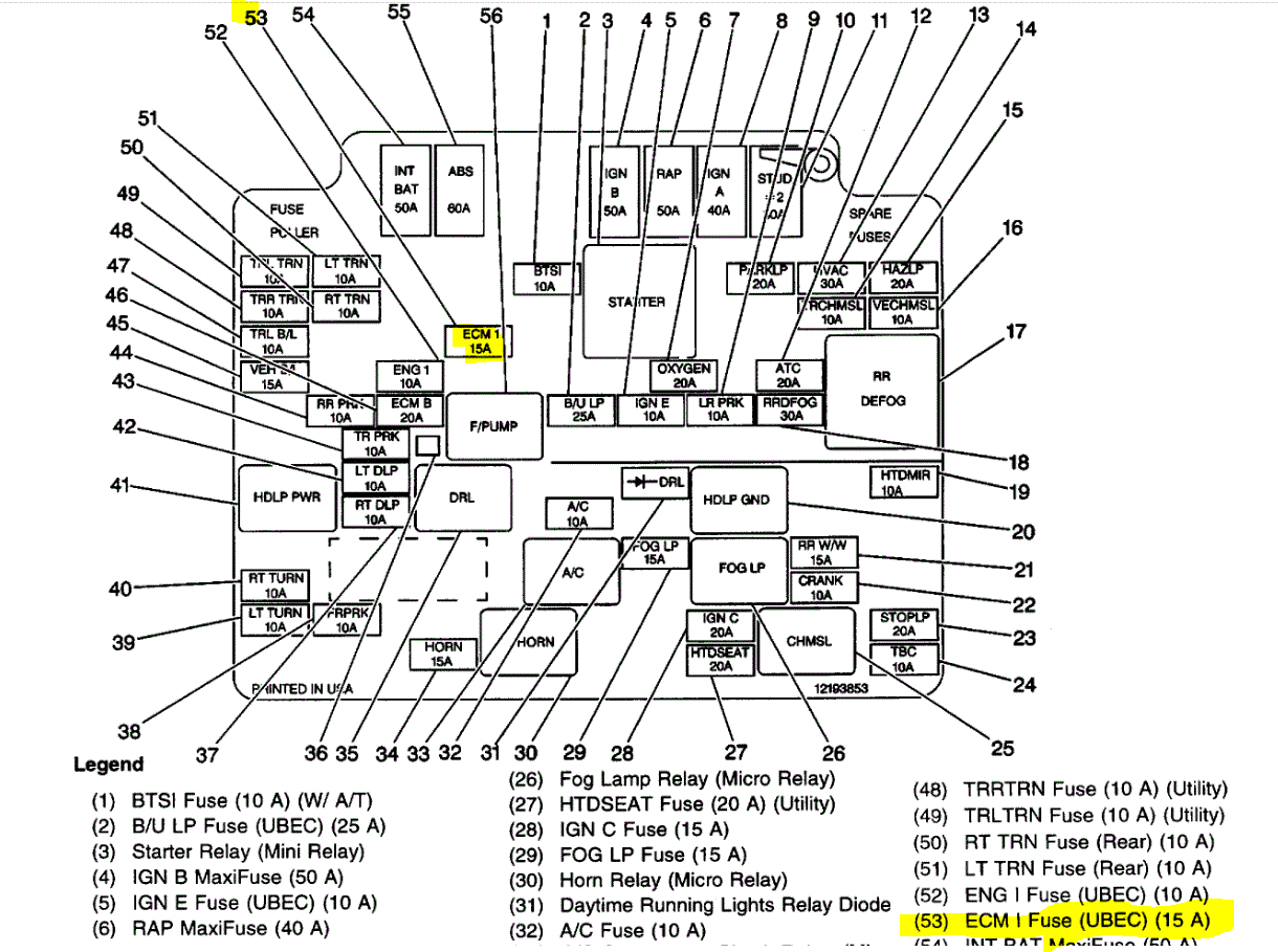

Before starting the diagnosis below, take a look at pic 3. Check the fuse indicated as powering the fuel pump relay (ECM1 fuse) and confirm it's good. Additionally, if the fuse is good, confirm there is power to and from it. Here is a link you may find helpful.

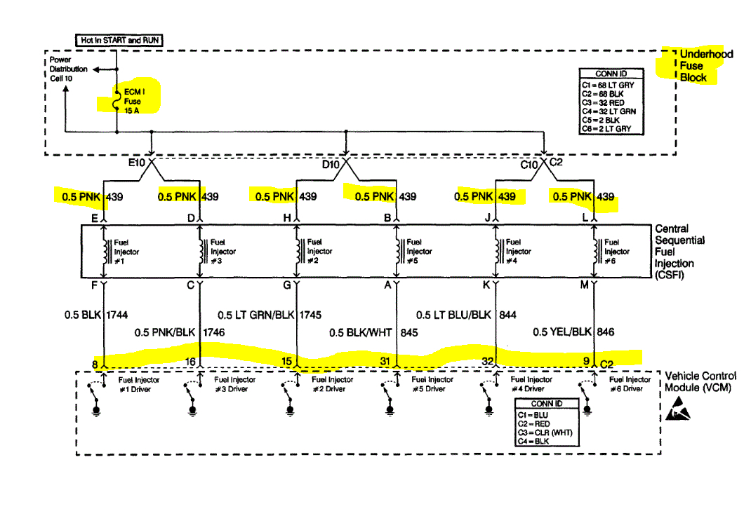

If the fuse is good and has power, go to any of the injectors and locate a pink wire at the connection. Each injector will have one that supplies 12v at all times to each injector when the key is on. A ground path is provided via the ECM. See if there is power to the pink wires.

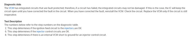

See pics below/Pic 4 shows the fuse location in the under-hood fuse box.
