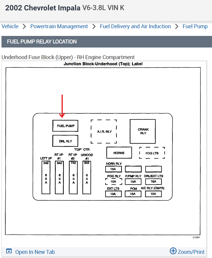

Is the fuel pump an AC Delco unit? If not, this can be the problem but let's swap out the fuel pump relay to see if anything changes, here is the location. Check out the images (below). Let us know how it goes.

So, I left it for the length of my shift which was 12 hours. Went in the morning and tried to start it and it started up no problem. It was a little hard starting and then it was fluttery I'll say when it did start but I drove it home and had no issues.
Nov 3, 2024 at 9:05 PM
Okay, the problem may come back or maybe you had some bad fuel which has worked its way out. Let me know if you need me again.
