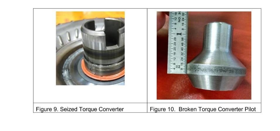

Hello again,
A common issue with these that I have found is the torque converter hub. The torque converter seizes and breaks the hub. That will give you no forward or reverse.
Image (Click to enlarge)

Thank you makes sense. can hear something engage when i put it in gear. I appreciate your help.Will pull gearbox and let you guys know what i found.
