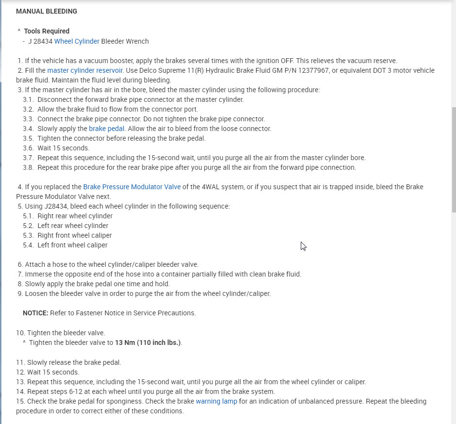

Okay. How are you bleeding them? Manual or pressure bleeding?
How long have you bleed them? Is the fluid in the master cylinder dropping at all when pumping them?
I attached the manual bleed procedure. Just review it and see if there is anything that you may be missing even though this is pretty straight forward. Thanks
Mar 16, 2021 at 10:12 AM

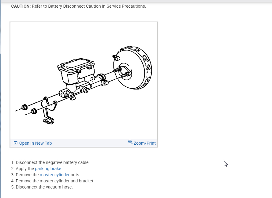

It sounds like the master is defective or it is not bled correctly. here is a guide to help you recheck your work:
https://www.2carpros.com/articles/how-to-replace-a-brake-master-cylinder

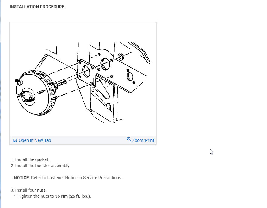

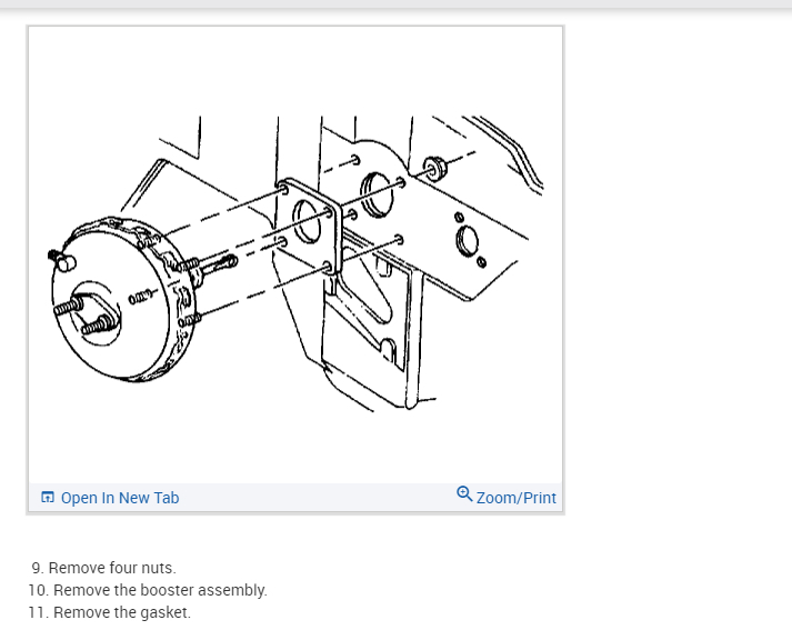

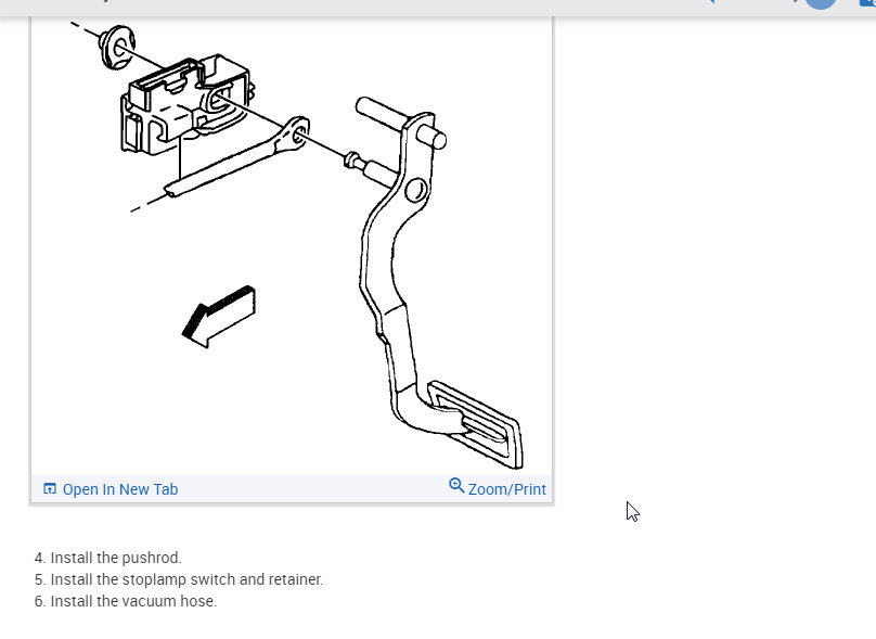

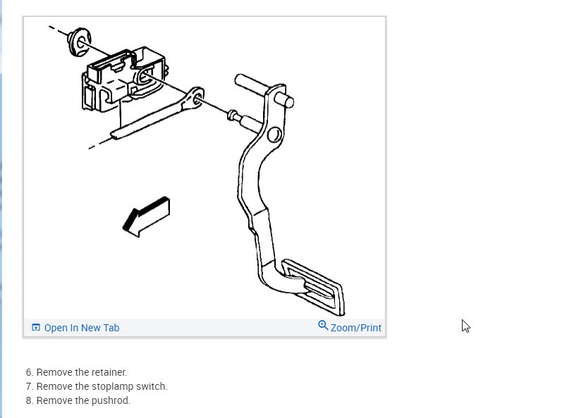

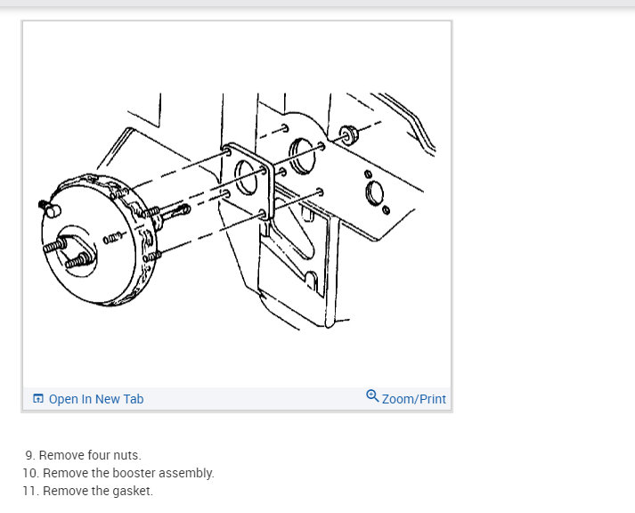

If you are lacking assistance, this sounds like the brake booster has failed. The booster is what provides the braking assistance so more than likely you have a leak in the diaphragm.
You can either rebuild it or it would be easier to replace it. Here is the procedure to do this:
