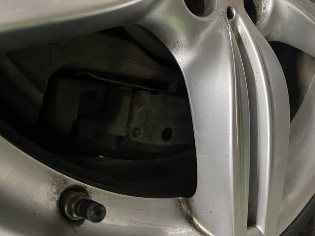

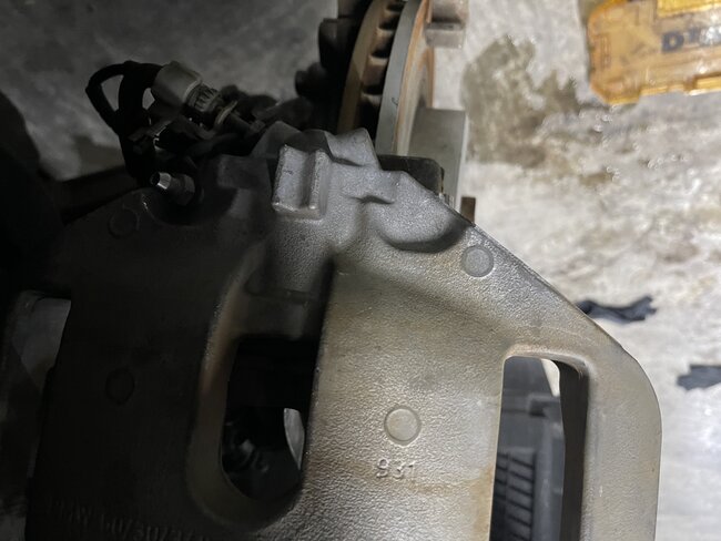

I suspect the previous owner changed the rotor and maybe the caliper on that side thinking it was the issue. But whenever i opened the bleed bolt on the caliper nothing came out. I opened the 10 mm line where the caliper hose connects to main one and nothing came out when i pressed on the brake. While in the air if i press the brake the wheel doesn't stop, no wonder why it pulls to the right when i brake the whole driving. The last picture us for the caliper from the other side. I can't tell if the caliper is new on the side with the issue, but i tried to press it back i faced resistance and stopped after i pushed it just a bit.

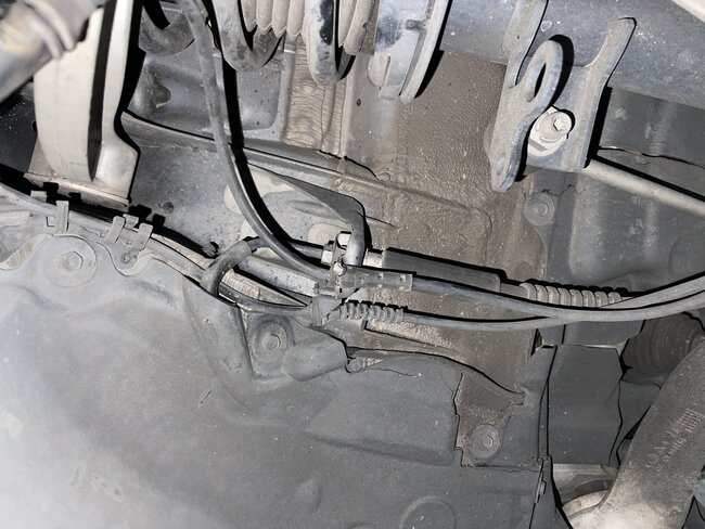

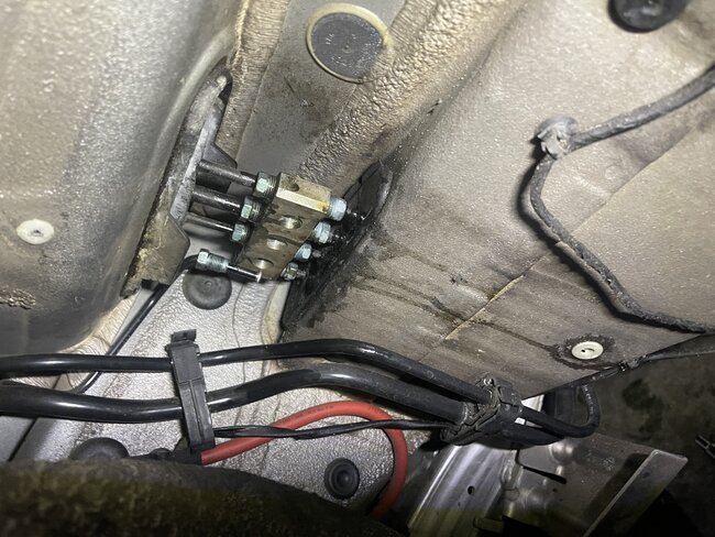

I opened the lines from above and below this bracket all but one have fluid coming out, none from the last one neither from above it nor below it. Possibly the ABS module.

Well, it won't be the master cylinder as it feeds both front brakes and one works. So, it's either the ABS module or the line is blocked. I would probably go to the ABS unit, disconnect the line and see if you can push air through it. If the lines are clear, then I would test the ABS unit and hope it's something simple as those units are expensive.

I also pushed air from where the caliper line becomes metal to the bracket before the abs and it's clear. I am removing the abs pump assembly; they are $50 used so I will swap it and code it and also flush the line like you mentioned. The fact that all sides respond to the scanner except this one tells me it may be in the ABS module.
