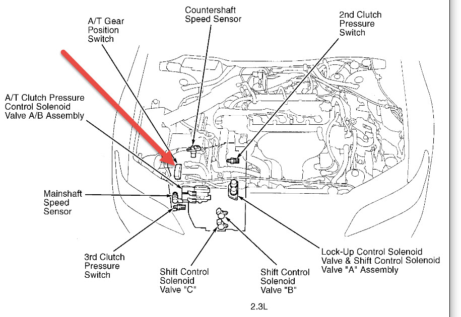

https://www.2carpros.com/articles/automatic-transmission-problems
Check out the diagrams (Below). Please let us know what you find. We are interested to see what it is.

That diagram is helpful. It is going take me a while to try all the solenoids and sensors, but this definitely is useful information. Need to let the snow stop before I am working on this again, but will post the results when I get them.

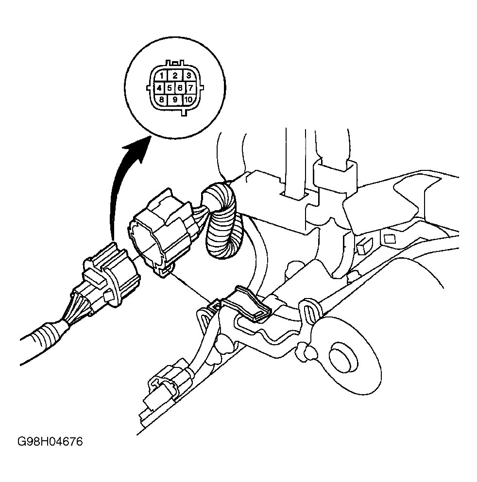

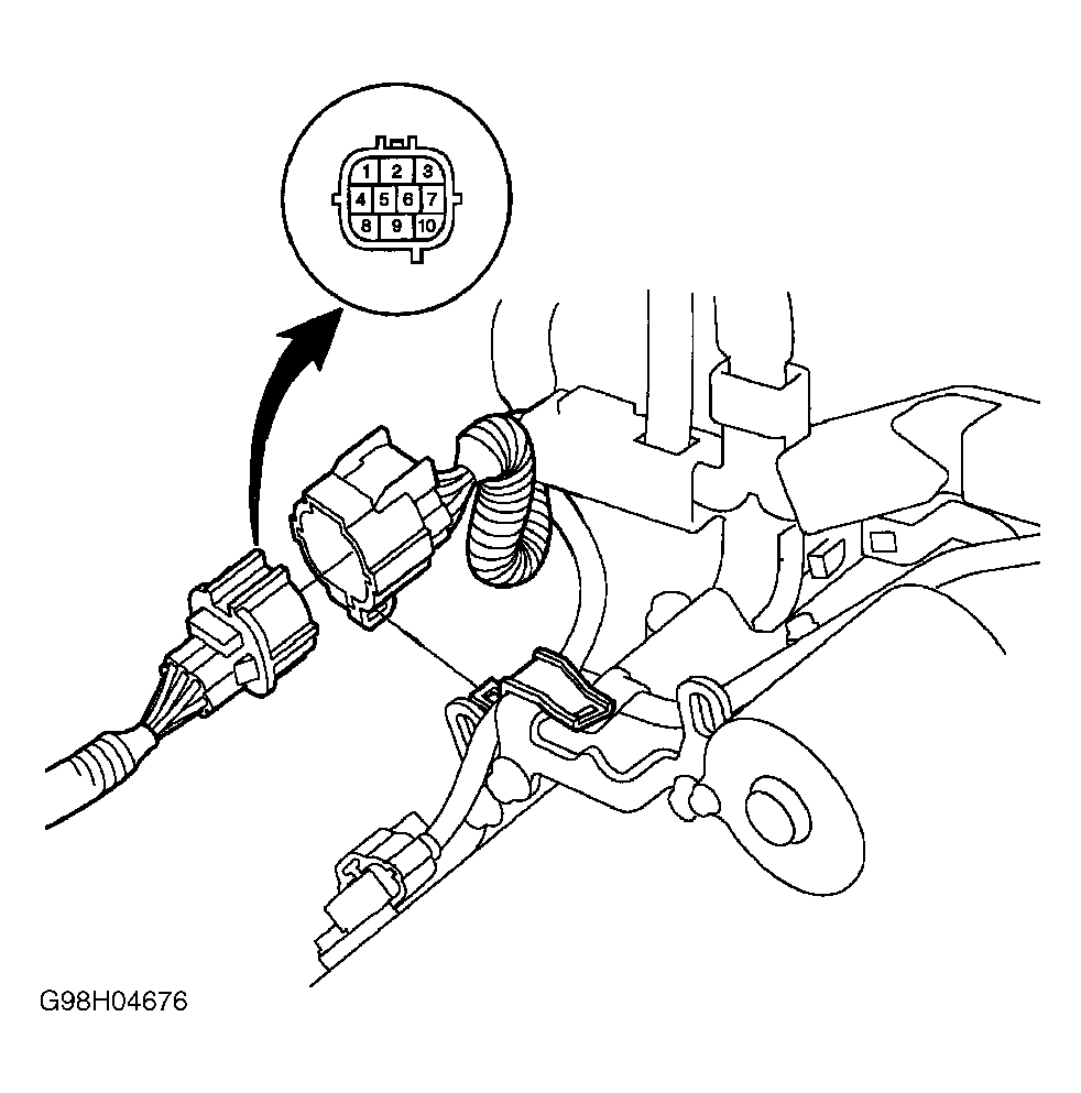

The codes say circuit malfunction. There are a lot of other transmission codes that indicate that the internal solenoids are not working. In this case the codes are not for internal transmission parts but for the external control circuits.
As such you will want to verify the actual wiring harness for damage first. When the problem happens does the gear indicator for first gear stay lit?
Look at the picture. Put the car in first gear and check for continuity between pin three (red wire/white stripe which changes to black at the connector and is a ground connection that goes to the engine at the left front) to pin four (brown wire which tells the indicator and PCM you want first gear).
Follow the harness and be sure that wire is not near the exhaust or engine block or has been damaged. Inside the car it has a splice that sends a signal to the dash gear indicator and goes to pin fifteen in the D connector on the PCM, (it will be next to a blue wire and a green one in the sixteen pin connector). If that wire is intermittent you would lose first gear. Heat causes expansion so if it was broken inside the insulation it could open when hot. (Easy way to test it would be to run a bypass wire from the wire on the transmission to the PCM connector)
Now if the wire tests out okay the issue will almost have to be inside the PCM.
All of the above should sort out the electronic codes.

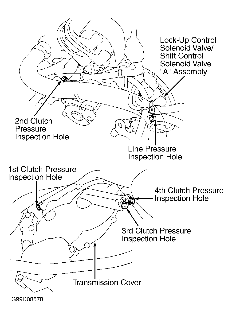

To check the mechanical parts you need a pressure gauge that reads to at least 300 psi.
Look at the second picture. With the engine and transmission warm.
Connect a pressure gauge to the line pressure test port. Start the engine and bring it up to 2000 rpm. Line pressure should read 120-135 psi. with the transmission in Park or Neutral.
Low pressure usually points to a bad pump or torque converter.
Shut down and remove the gauge. Connect it to the first clutch inspection port.
Start up and bring it up to 2000 rpm again. With the transmission in first gear the pressure should read the same as the line pressure test.
If it does not you have a problem with the first gear clutch, first gear accumulator or a transfer port is blocked.

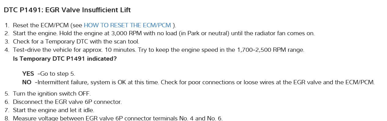

For the 1491 EGR code. Great diagnostic from Honda. It is a .pdf file.
www.driveaccord.net/forums/attachment.php?attachmentid=14258&d=1218558434
