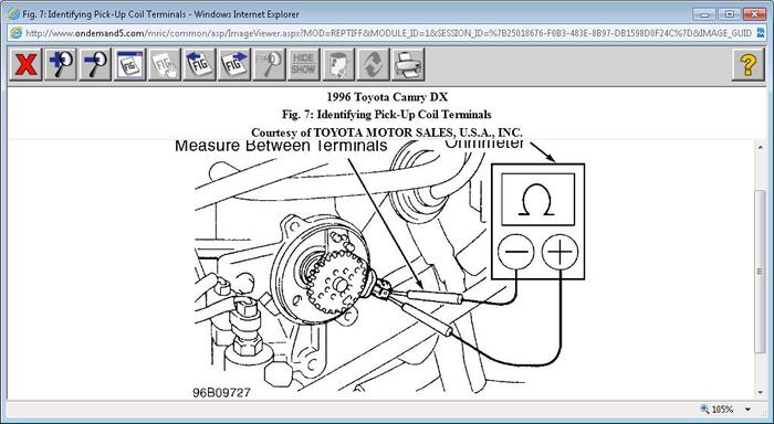

The crankshaft sensor is reading around 1400 Johns of resistance, which is supposed to be in range. I checked the wiring and distributor and both are in working order. Would a broken solenoid on the trans keep it from starting? I think its the lockup solenoid that I found was broken when I was tracing wires.

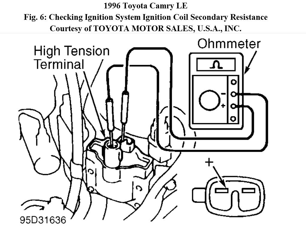

KHLOW2008
  • 41,814 POSTS

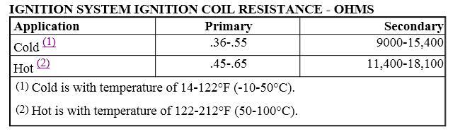

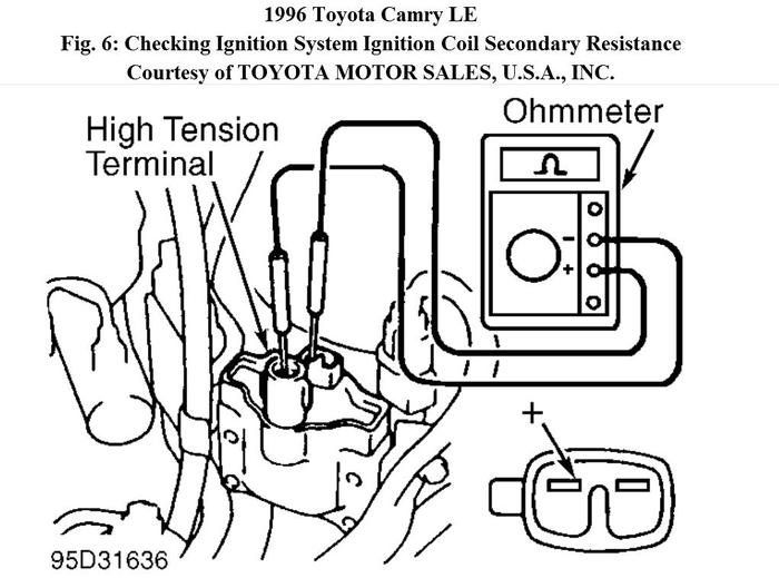

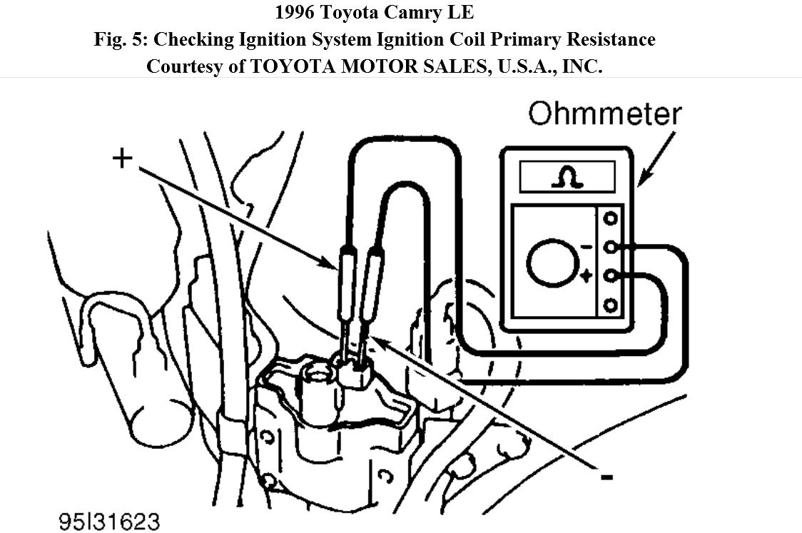

Try checking the ignition coil resistance.
IGNITION COIL RESISTANCE
1. Disconnect wiring from ignition coil so ignition coil is isolated from system. Using ohmmeter, check ignition coil primary resistance between ignition coil positive (+) and negative (-) terminals. See
Fig. 5.
2. Check ignition coil secondary resistance between ignition coil positive (+) terminal and high tension terminal (coil wire tower). See Fig. 6. Replace ignition coil if resistance is not within specification.
Feb 22, 2021 at 9:59 AM (Merged)
BPATRICK
  • 6 POSTS
Coil checks out as well. I appreciate the help so far.

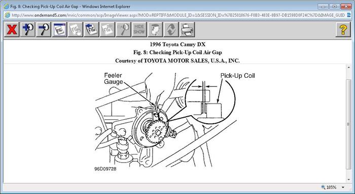

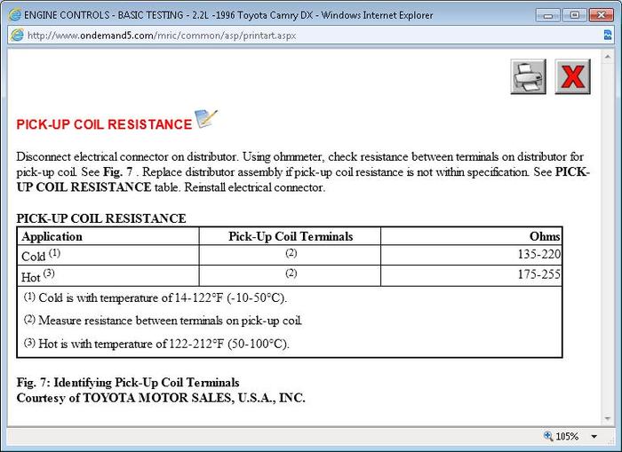

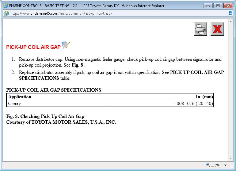

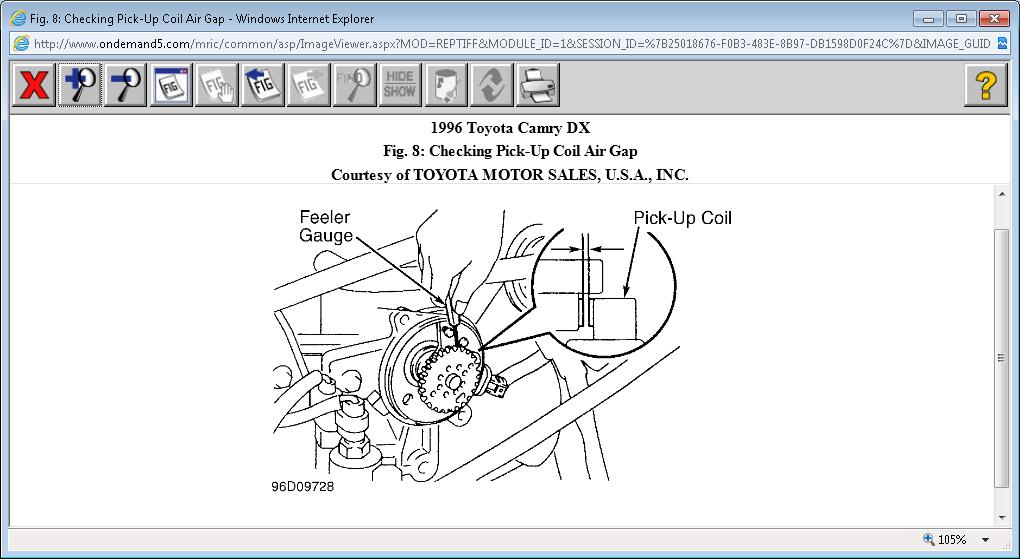

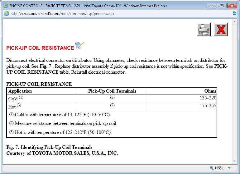

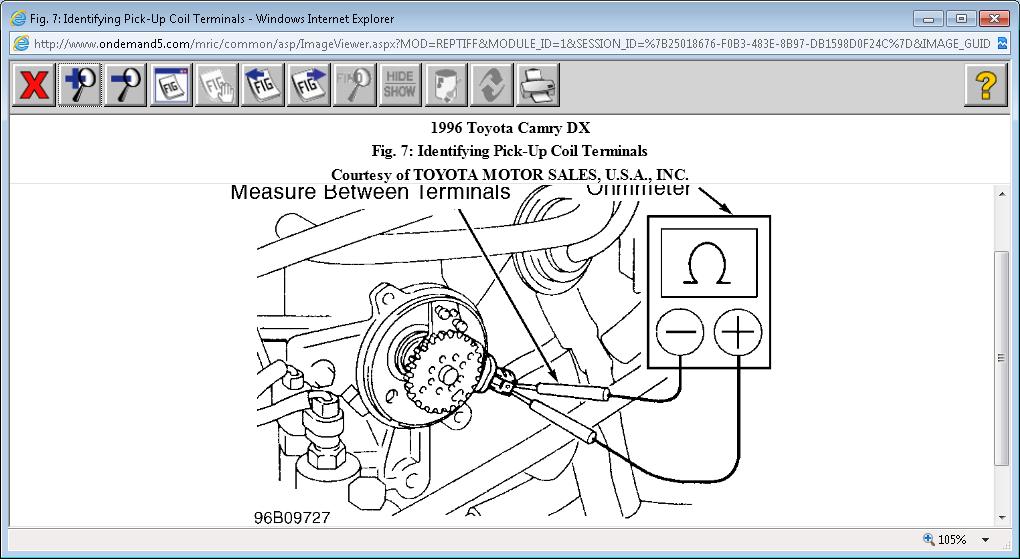

SATURNTECH9
  • 30,869 POSTS
I posted how to test the pick up coil and how to check the air gap on it.

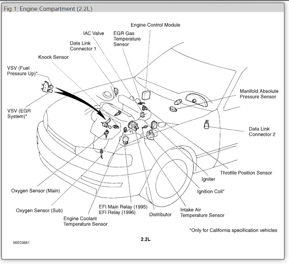

1995 Toyota Camry DX 2.2L 5spd manul I've tried looking online as well as all over my engine. I can't find the ignition coil anywhere. can you guide me as to where it is located?
https://www.2carpros.com/forum/automotive_pictures/411849_P9260678_1.jpg
Feb 22, 2021 at 10:08 AM (Merged)
RASMATAZ
  • 75,992 POSTS
The coil is inside the distributor

Its not the gas, stations go through way to much to have bad gas problems anymore. I sounds like you have an EFI relay that is going out which supplies power to the ECM I just fixed a car just like this which had the same problem in the shop the other day.
Here is a guide to show you how to check the relay
