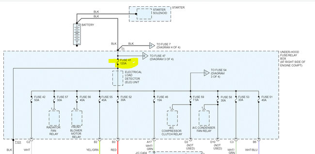

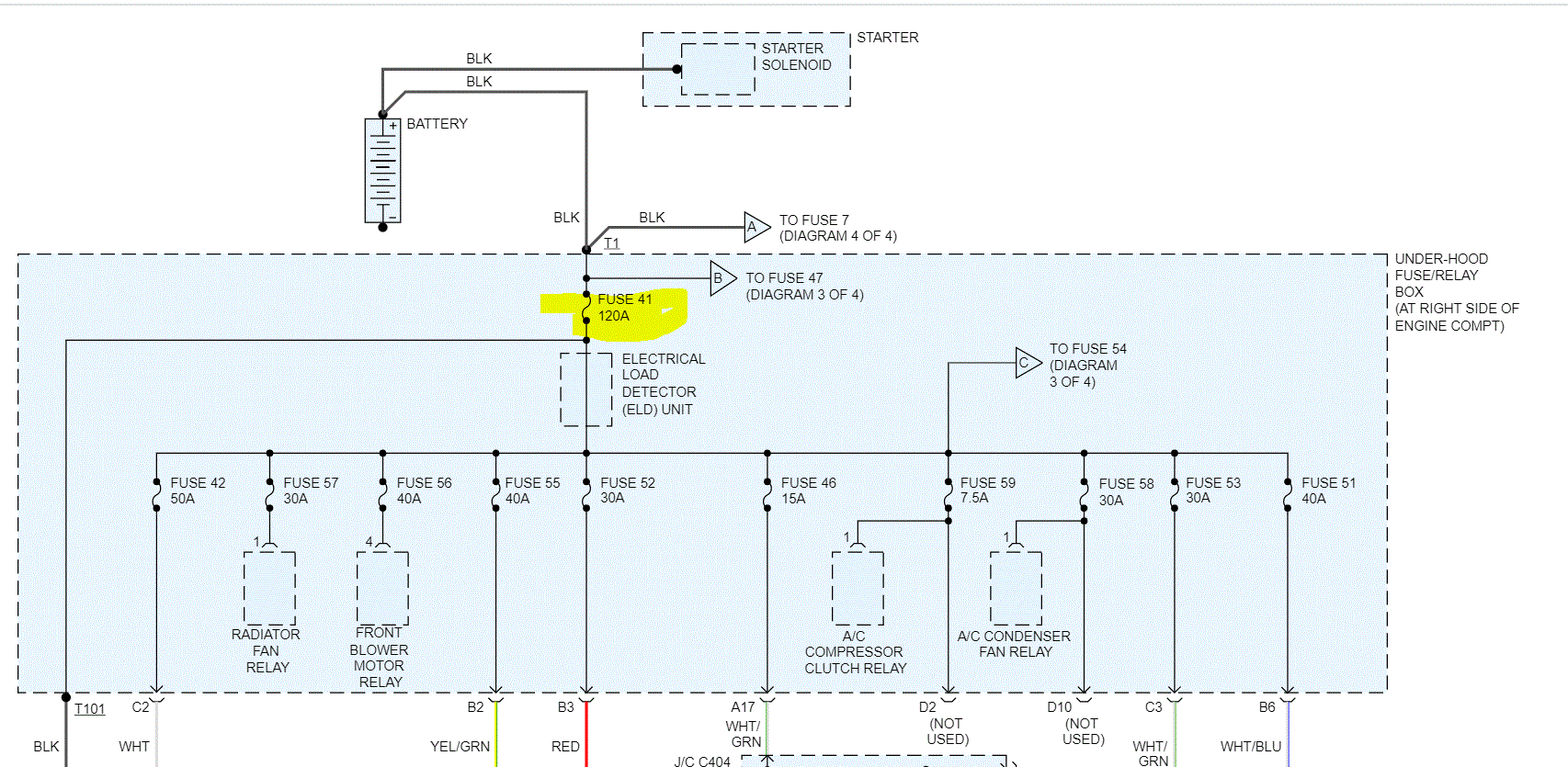

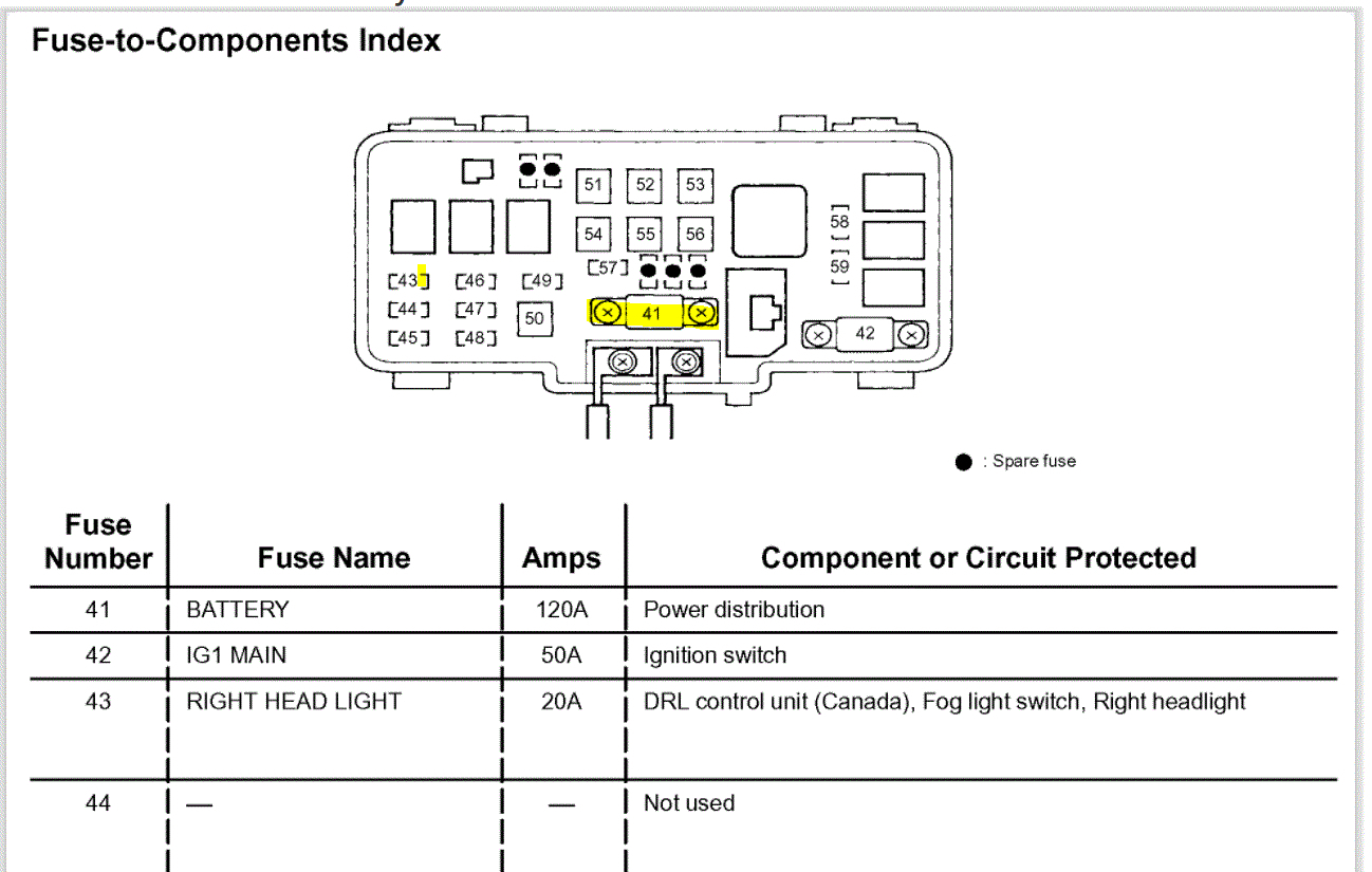

There is a 120 amp power distribution fuse in the under hood fuse box. I need you to check if there is power in and out from it. I attached two pics below.
Let me know what you find.
