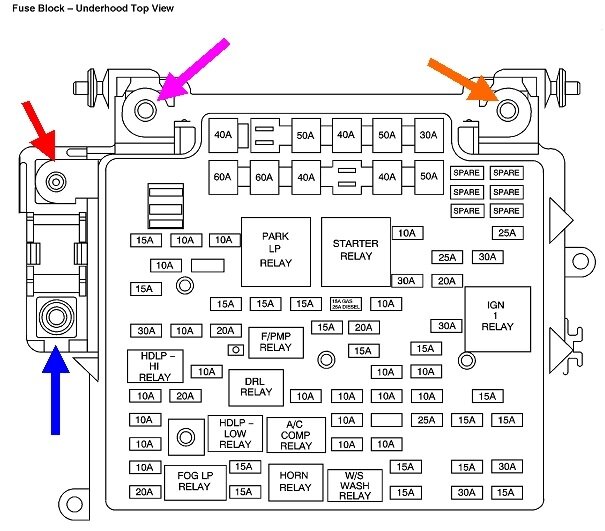

It looks like there's up to four nuts to check. All I have to go by is this drawing. I can't find any model listed with a 5.7L engine. This is for a 5.3L. They show two batteries. Am I seeing that right?

It is a 5.3L, my bad! I am thinking it was the small positive cable going to the fuse block. I disconnected it to be able to raise the fuse block and check the wires under it. Even though the connection was tight and looked free of corrosion, disconnecting it and reconnecting may have done it. So far so good. If it happens again, I'll go directly to that positive cable first. Is adding dielectric grease recommended to help prevent corrosion?

In your case, it looks like there can up to four nuts to tighten. I can't tell from the drawing, but a lot of manufacturers are doing that now where there's multiple fuses at those large connections.

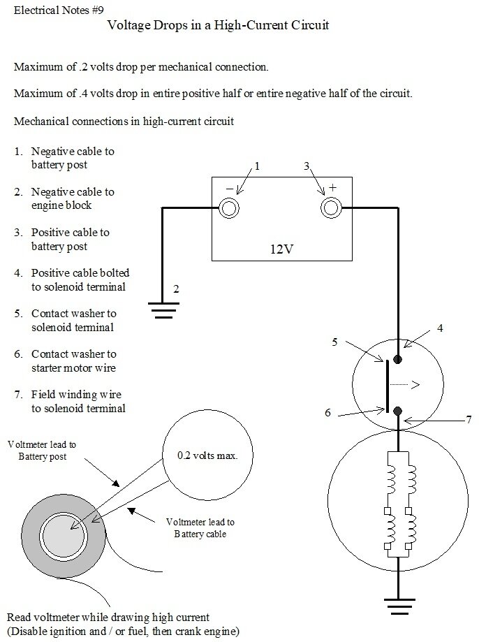

This is the same test we do in starter circuits, although those bad connections are usually easier to find. An older Ford or GM starter wants to draw up to 300 amps until it gets up to speed. Once spinning, that drops down to around 200 amps. With current that high, it takes far less resistance than we can measure to stop the circuit from working. A misguided continuity test will falsely show everything is okay. While we can't measure resistance that small, we can measure the RESULTS of that resistance. That is this voltage drop test. The industry standard is we're allowed up to a maximum of 0.2 volts per mechanical connection, and no more than 0.4 volts for the entire half of that circuit. The other half is the negative battery cable where it bolts to the engine. You have one mechanical connection between the battery post and the negative cable clamp, and a second one between the other end of that cable and the engine.
With older Fords, the positive half of the starter system was full of mechanical connections. Besides the one at the battery positive post and the one at the starter, that cable is in two pieces, each with an end on the starter solenoid. There's also two mechanical contacts inside the starter solenoid. Every one of those connections can have no more than 0.2 volts drop, and all six of them together can have no more than 0.4 volts drop in total. You have those two internal solenoid contacts too, but we can't get to them with the meter probe, so we don't count those in this test.
The drawing below is of a "Notes Page" I handed out in class. This is for starter circuits, but the idea is the same with fuse boxes.
