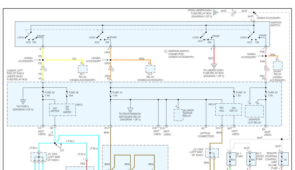

If everything checks out the ignition switch can be bad, here is a guide to help check it and the wiring diagrams below so you can see which wires to test for power:
