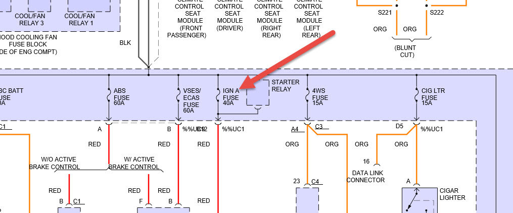

No electrical power to any system. No ign. pwr. no lights (interior or head lights) nothing.
Battery is charged, power can be found at under hood fuse block.
