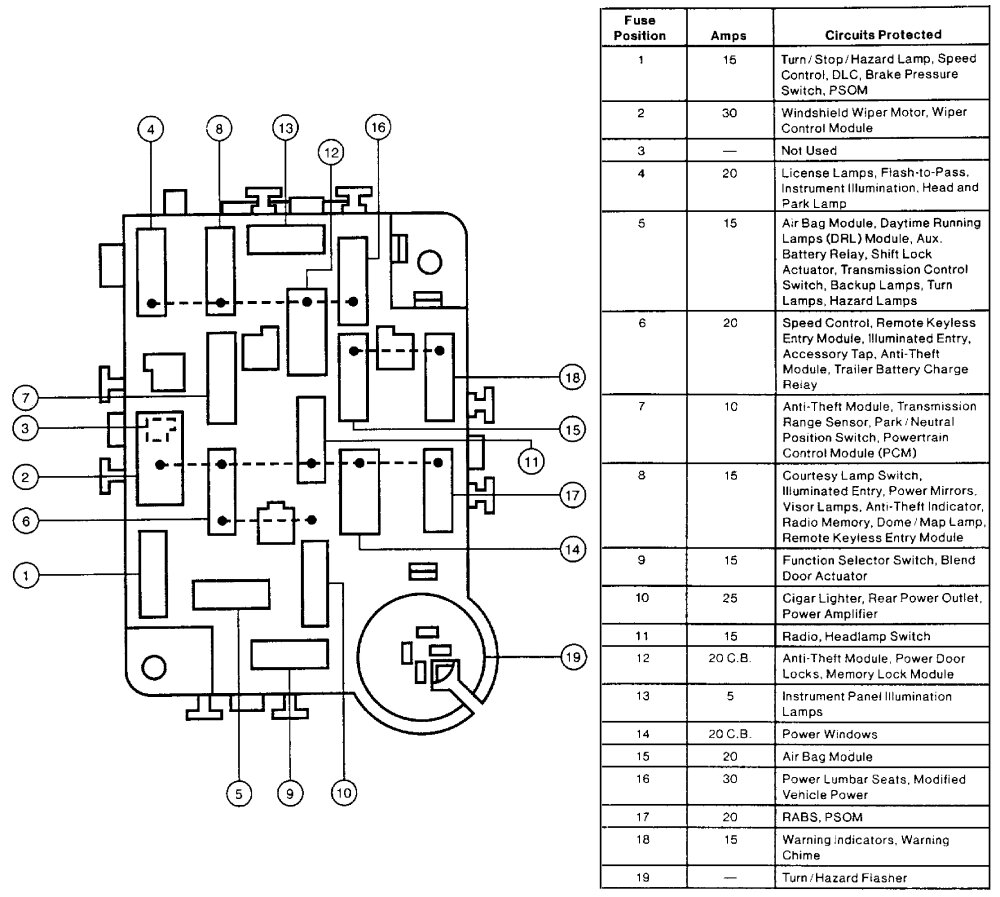

At first, I thought only the dash lights were out. Replacing the fuse didn't help. Then I realized I had no taillights/running lights. I found that a fuse had blown for the Running. I replaced the fuse and fixed it, until I pulled the headlights all the way on. The running/taillights went out again.
So, dash, running and taillights work until I turn on the headlights, then only the headlights are on.
I have brake lights, turn signals and hazards.
I've read several threads here and there with others having the same problem (different makes and models).
They've mentioned replacing the headlight switch, which didn't fix the problem. I don't want to spend that much money just to find out the same thing.
I hope you have other possible fixes.
