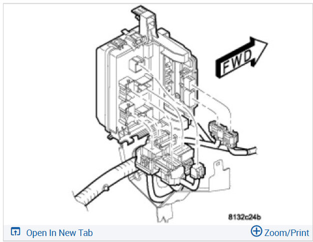

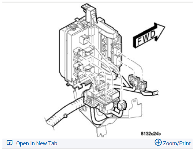

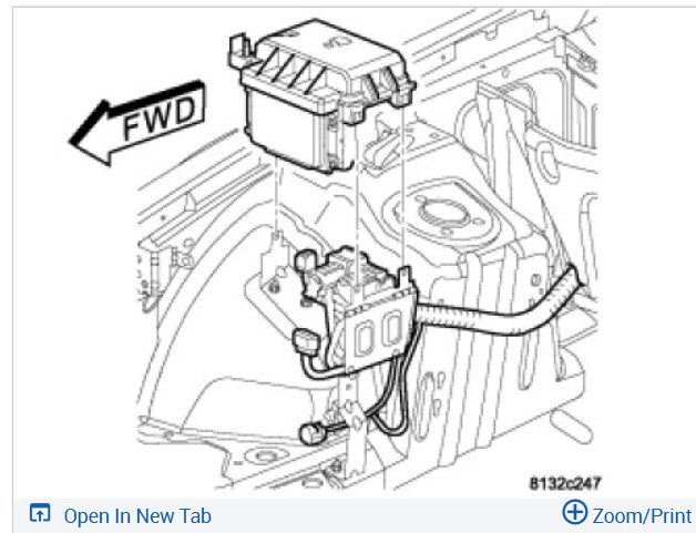

Sure, I can help, if would be better if I have a short video to look at of what the car is doing, you can upload it here in your response. I would start by making sure the battery is good and the connections at the battery are clean and secure as well, this guide can help:
If this is not the problem I have seen the wiring less ignition node or the TIPM, I see the TIPM powers the data link connector so I would start there, please check the wht/lt blu wire at the data link connector for power this guide can help (key on).
If there is no power replace the TIPM which is easy because it-self learns so there is no programming. Here is the location and a video to help with the data link issue.
https://www.youtube.com/watch?v=6Tlg3JmgNSQ
You can get a used TIPM from eBay FYI. Check out the images (below). Please let us know what happens.
