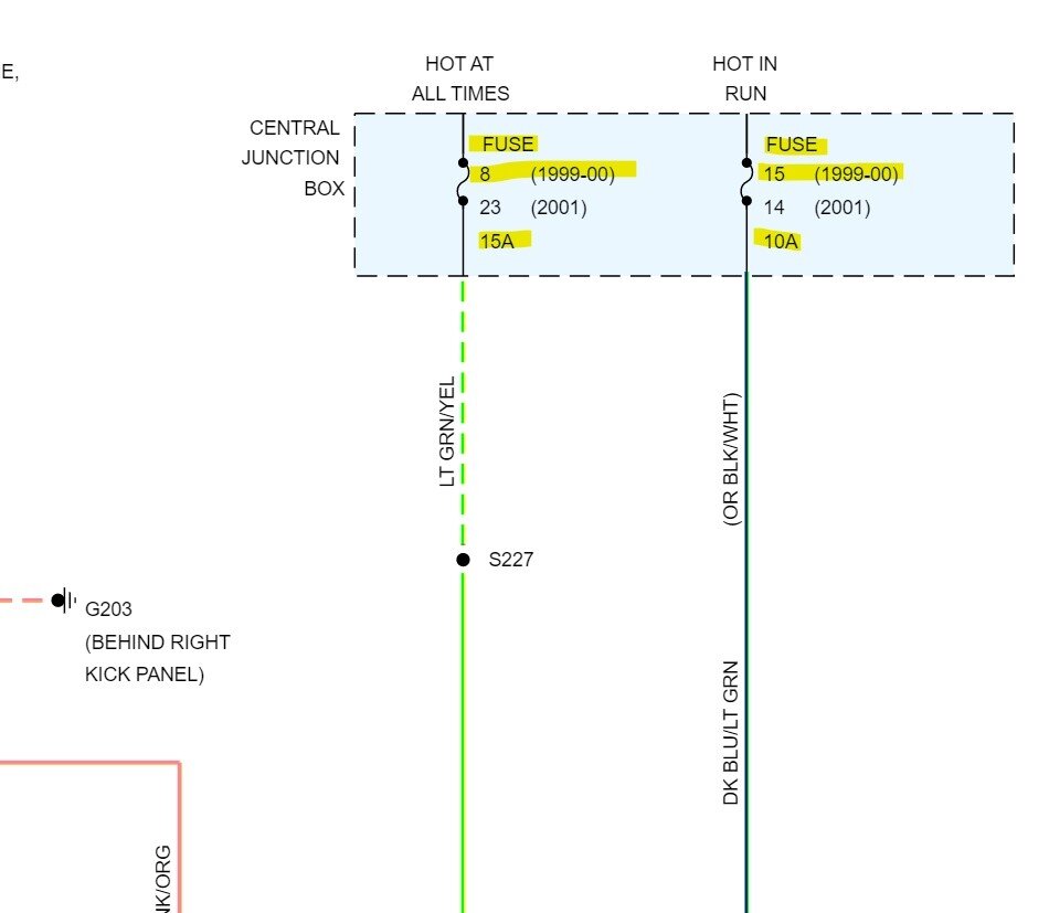

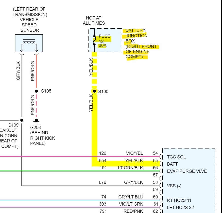

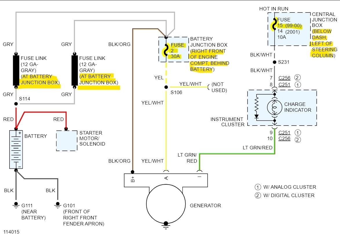

The 1st diagram below is the Cluster fuses, the 2nd is memory fuse for the engine computer it should have 12v all the time, the 3rd is the charging system fuses with 2 fusible links near the battery, they will be a thicker section of wire usually coming off of a power bus bar or directly off the battery. They are like a fuse, except a wire that burns instead if there is too much current flow (short to ground).
