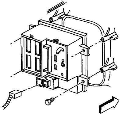

Sizzling noise is not a good thing, it is the sound of either a bad connection or a short.
All of those lights are on the same circuit and my bet is on a bad headlight switch.
They get hot and the contacts fail. Not real hard to change, you remove the trim panel over the drivers feet, then remove the dash trim and the switch is attached to the trim.
