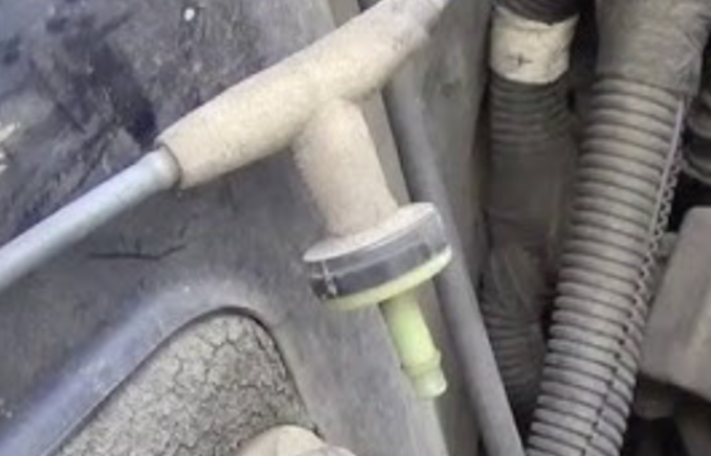

I have found the problem the hose has come undone from the manifold but there was like a filter like thing that came off to and I’m trying to find that part but can’t seem to find it.

It’s the vacuum line going to the manifold for the ac and cruise control it has a filter like thing on it and I lost it.

Oh, I see the "vacuum line" yes there is a filter that can go to the control solenoid.

Yeah there’s a line going to the manifold it had a filter like thing in the line but when I look online is a check valve, but I can’t find the part number at the parts store.

Not this line exactly but it is that filter thing though I looked up online trying to find it, but it says it doesn’t go on this jeep grand Cherokee Laredo 4.0 but ik it does.

Yes, that is a vacuum check valve. It feeds the HVAC and EVAP system control valves or solenoids. If you remove it the auto parts store can match it up.

It was lost it fell off down the road and I’m trying to match it, but the store says they don’t sell that for that one.

Okay, you may to visit a wrecking yard to find one.
