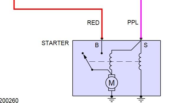

If the starter motor won't crank, have to check the starter motor wiring circuits. Usually two voltage circuits, one is battery voltage, hot all the time. The other voltage circuit goes hot with key in the crank position and is wired through the neutral switch. The starter grounds through the engine block. Any testing at the starter, make sure tranny is in park or neutral and the parking brake is set.

Starter wiring is fine. Don't think that would have any to do with the service brake system warning that happens every time. Plus the locking of the shifter probably not related and I know it has nothing to do with fuel pressure. changed out the brake switch but no change but will tinker abit more. Seems like the switch is linked to the shift interlock which makes sense. Started thinking if it might have some thing to do with the ignition switch? Think the key is in the service brake warning. Why would this disappear after cycling the keys? Is there an interlock in the ignition or am I off in left field. I will check my ground but seems a like a long shot.

You said, "it won't crank". If starter motor won't crank, what I posted about starter motor circuit, is right on the money.
Sometimes when people say it won't crank, they mean, it cranks good but won't start. I'm just trying to figure out exactly what your saying? Sometimes when you track down one circuit, it may well fix other issues?.
At the moment, if starter motor won't crank, I don't care about the brake service. I don't believe you said, the starter motor would crank? You do have shift interlock and the brake is part of that system.
I'm not trying to argue, just trying to understand. You can always get the starter motor to crank, by using jumper wire across switch side of relay, as long as there is voltage to switch side of relay. If you try that, just be sure the tranny is in park or neutral and the parking brake is set.
