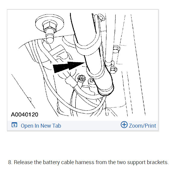

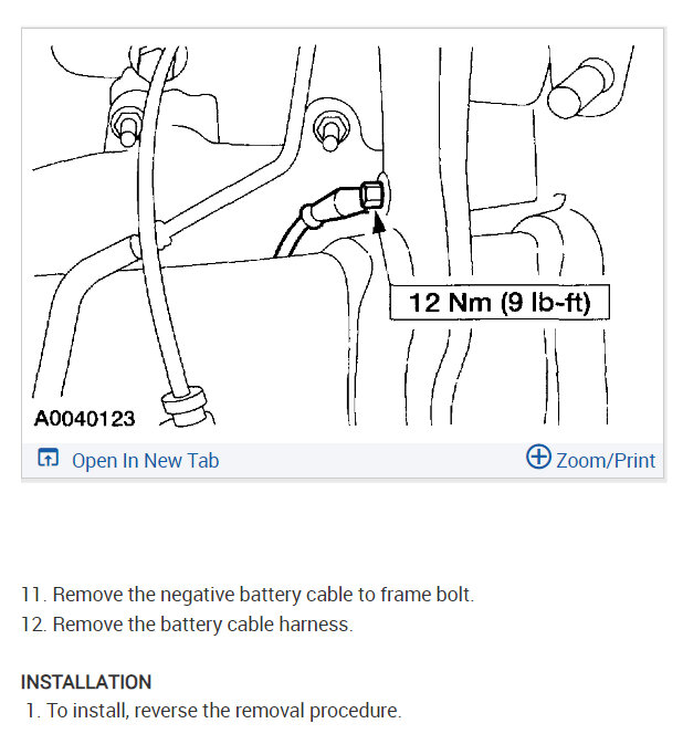

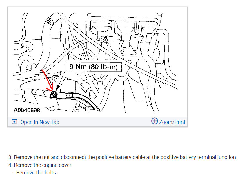

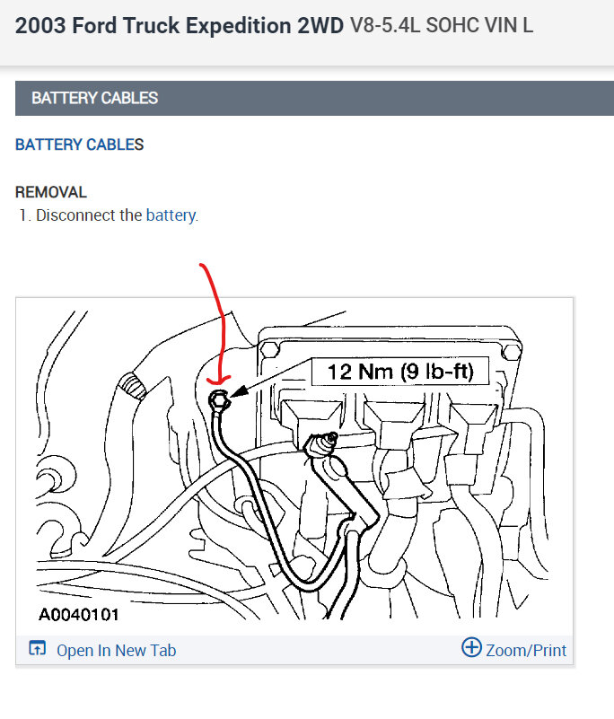

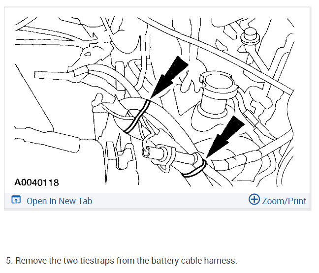

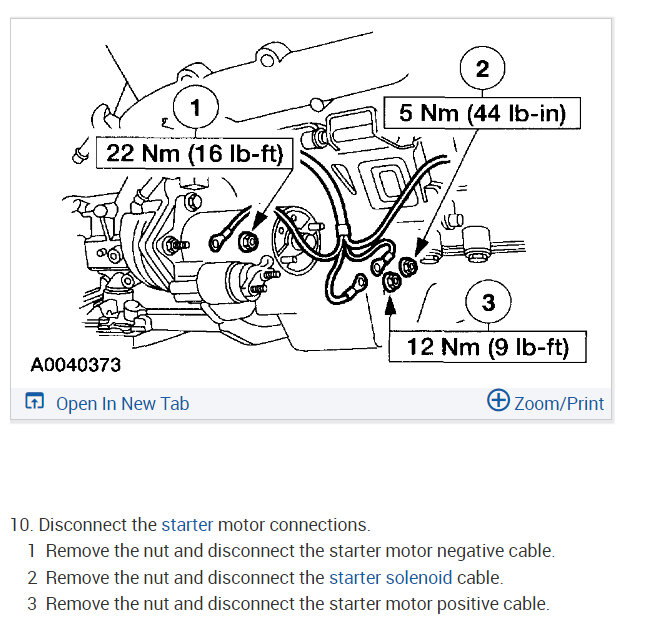

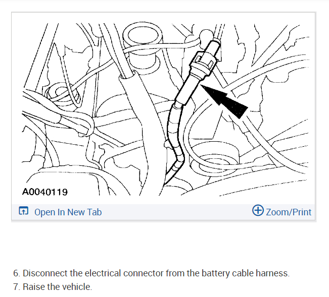

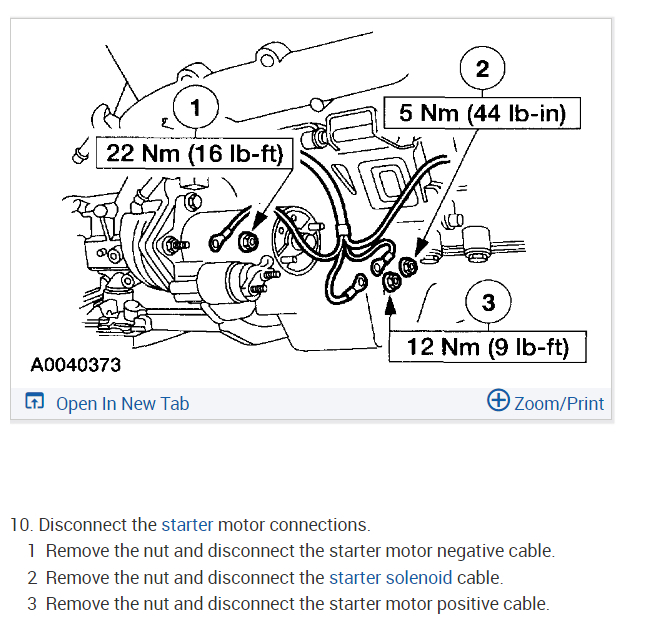

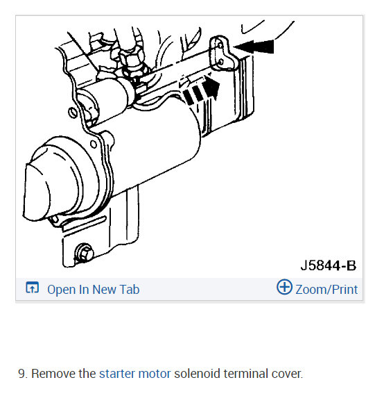

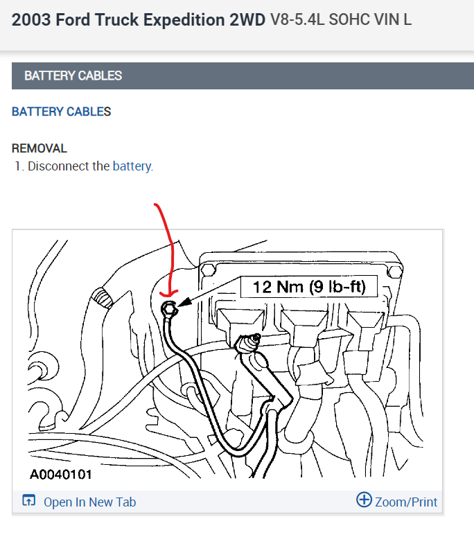

This sounds like a bad ground or positive battery cable. It could be a bad ignition switch as well. I would check the cable connection to make sure they are not loose or corroded.
This guide can help:
This sounds like low voltage, is the battery new? This guide can help test it without testing equipment:
Check out the images (below). Please upload pictures or videos in your response to the problem so we can see what's going on.
