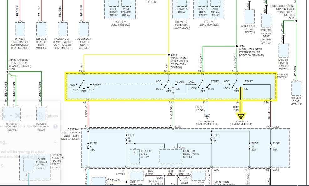

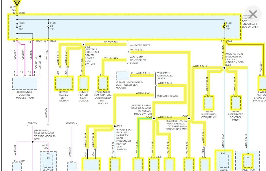

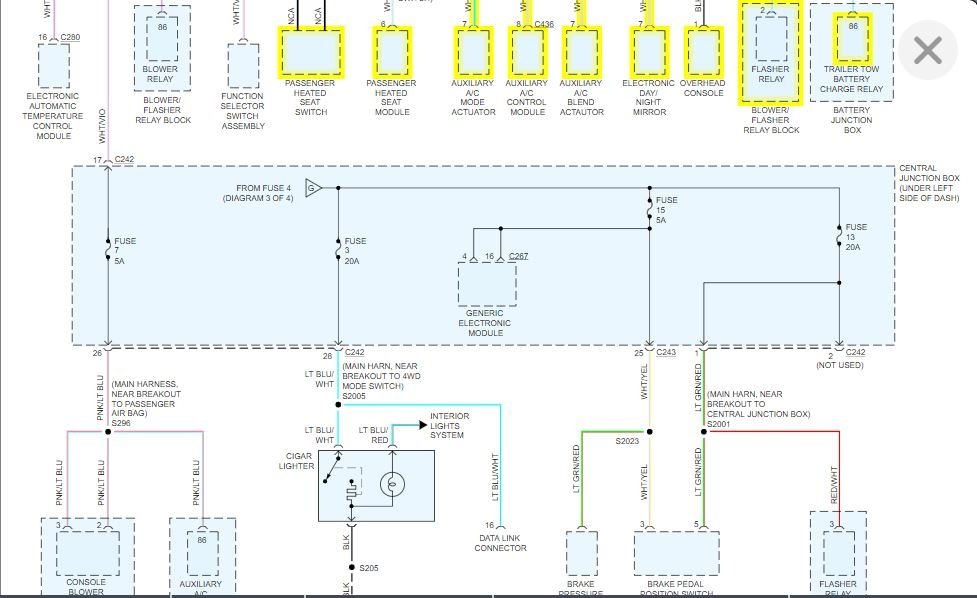

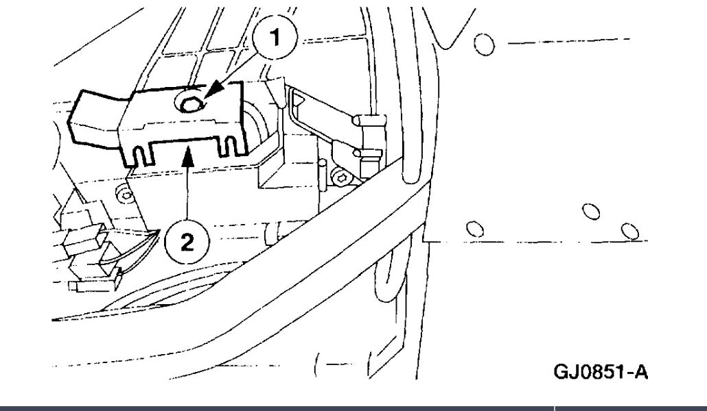

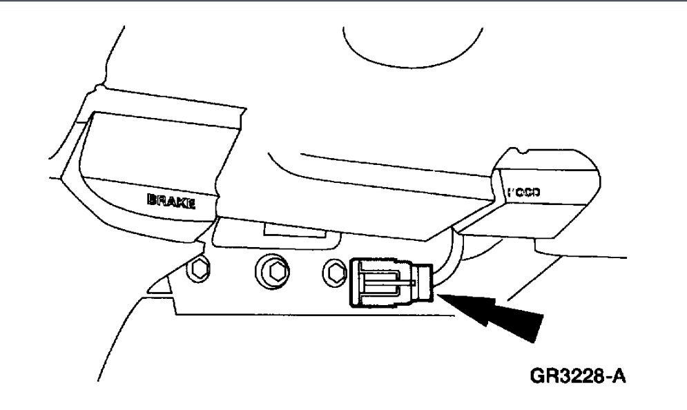

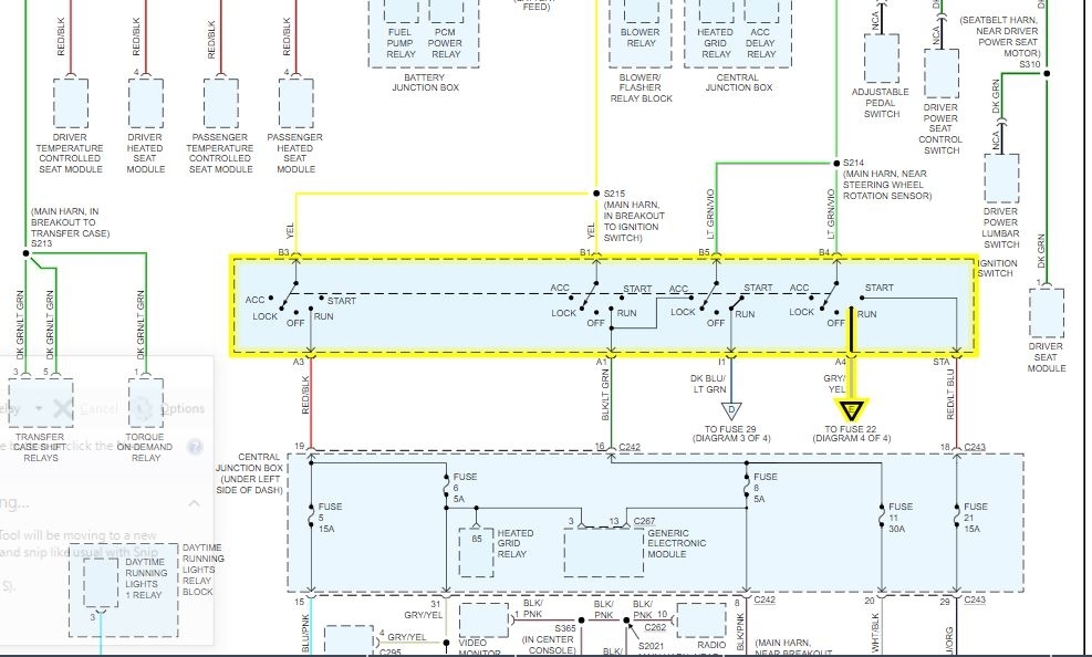

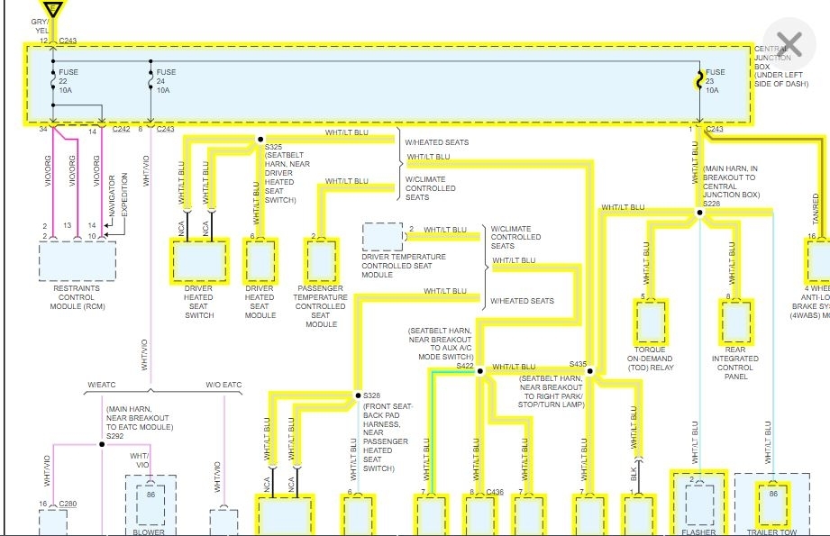

Okay, fuse 23 is fed from the ignition switch. I attached the diagram for you to view. I feeds fuse 22 as well.
It looks to be a bad ignition switch.

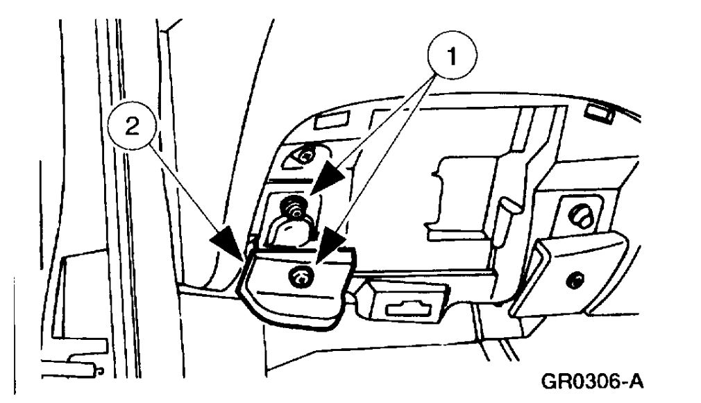

Removal
1. Disconnect the battery ground cable.
2. Remove the instrument panel steering column cover.
3. Disconnect the ignition switch electrical connector.
1 Loosen the bolt.
2 Disconnect the electrical connector.

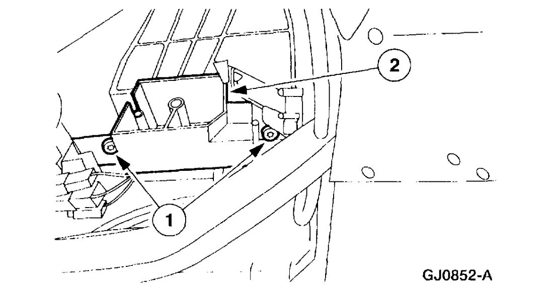

4. Remove the ignition switch.
1 Remove the screws.
2 Remove the ignition switch.

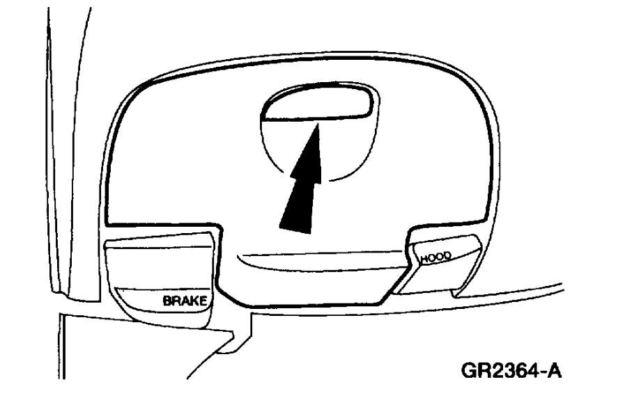

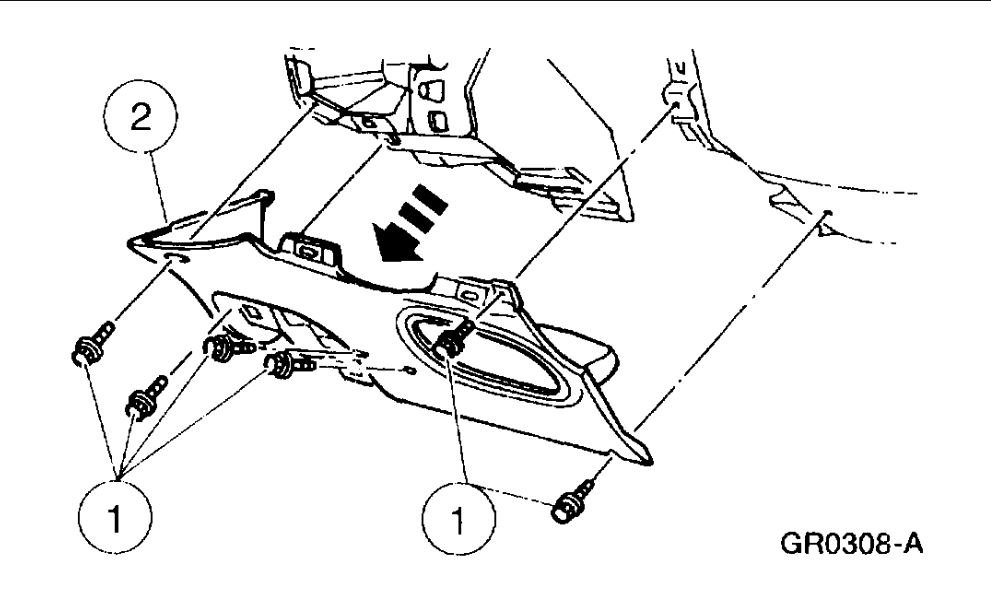

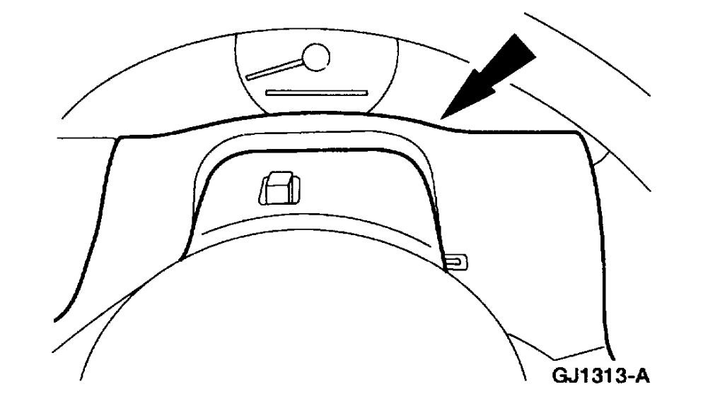

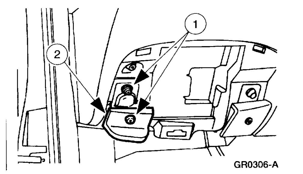

REMOVAL
1. Remove the upper steering column cover.
NOTE: On automatic transmissions, move the shift lever to the 1 position to make removal easier.
2. Position the electrical connector aside.
^ Release the push clip from the lower instrument panel steering column cover.
3. Pull the handle and remove the fuse door.

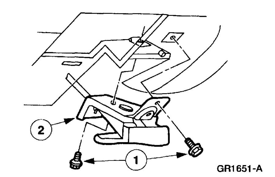

4. Disconnect the hood latch release handle from the lower instrument panel steering column cover.
2 Disconnect the hood latch release handle from the lower steering column cover.
5. Disconnect the parking brake release handle from the lower instrument panel steering column cover.
2 Disconnect the parking brake release handle.
6. Remove the lower instrument panel steering column cover.
1 Remove the bolts.
2 Remove the lower instrument panel steering column cover.

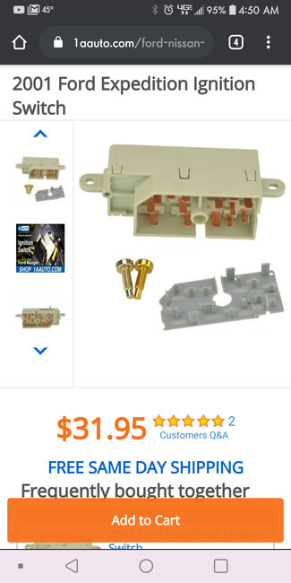

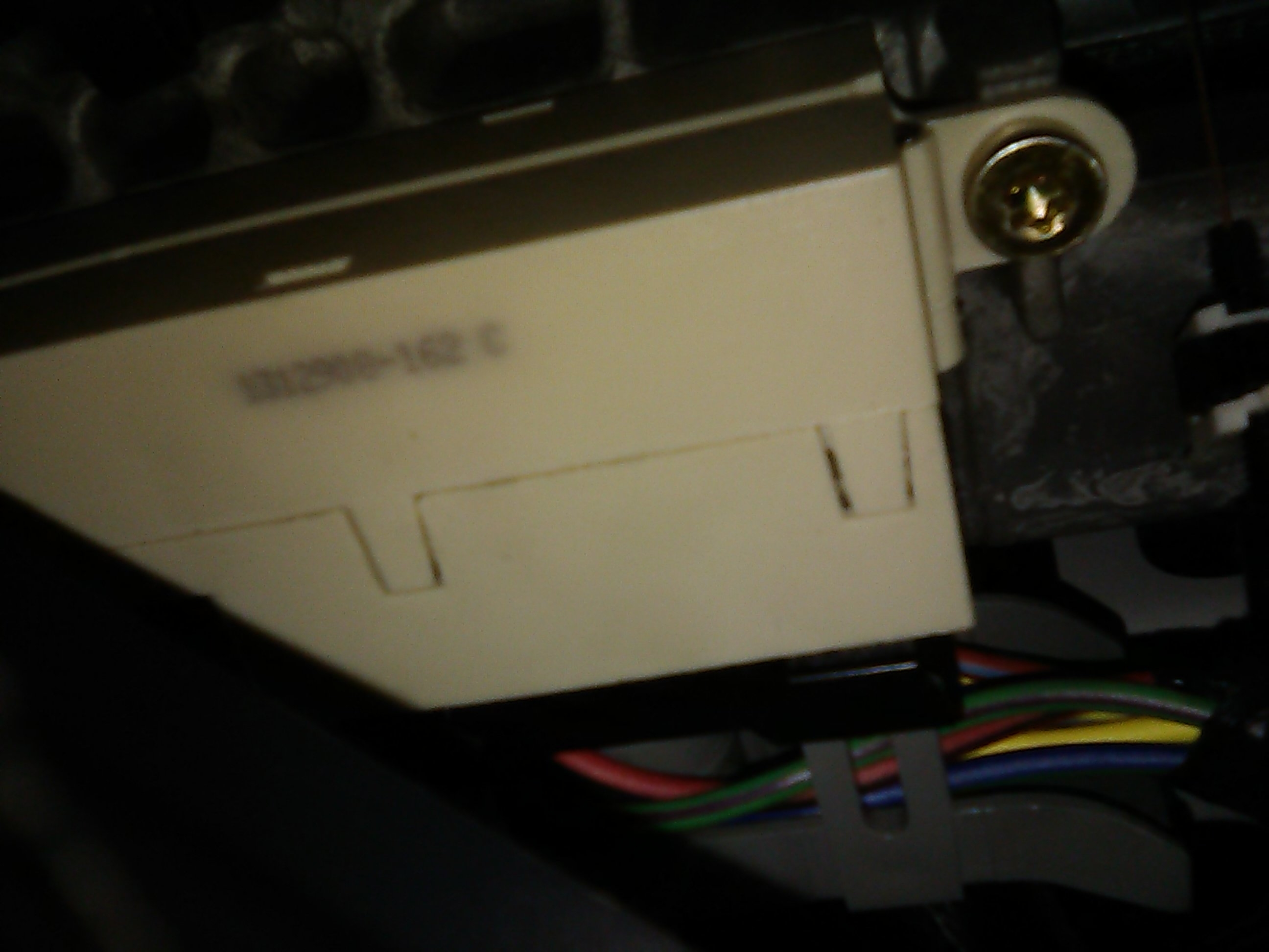

We changed the ignition switch (not the one with the key), still nothing. also the cluster panel and mileage has no power, no inside lights, no radio unless we hook battery charger up to it then we have power everywhere but still will not crank/start. Also changed starter solenoid relay.

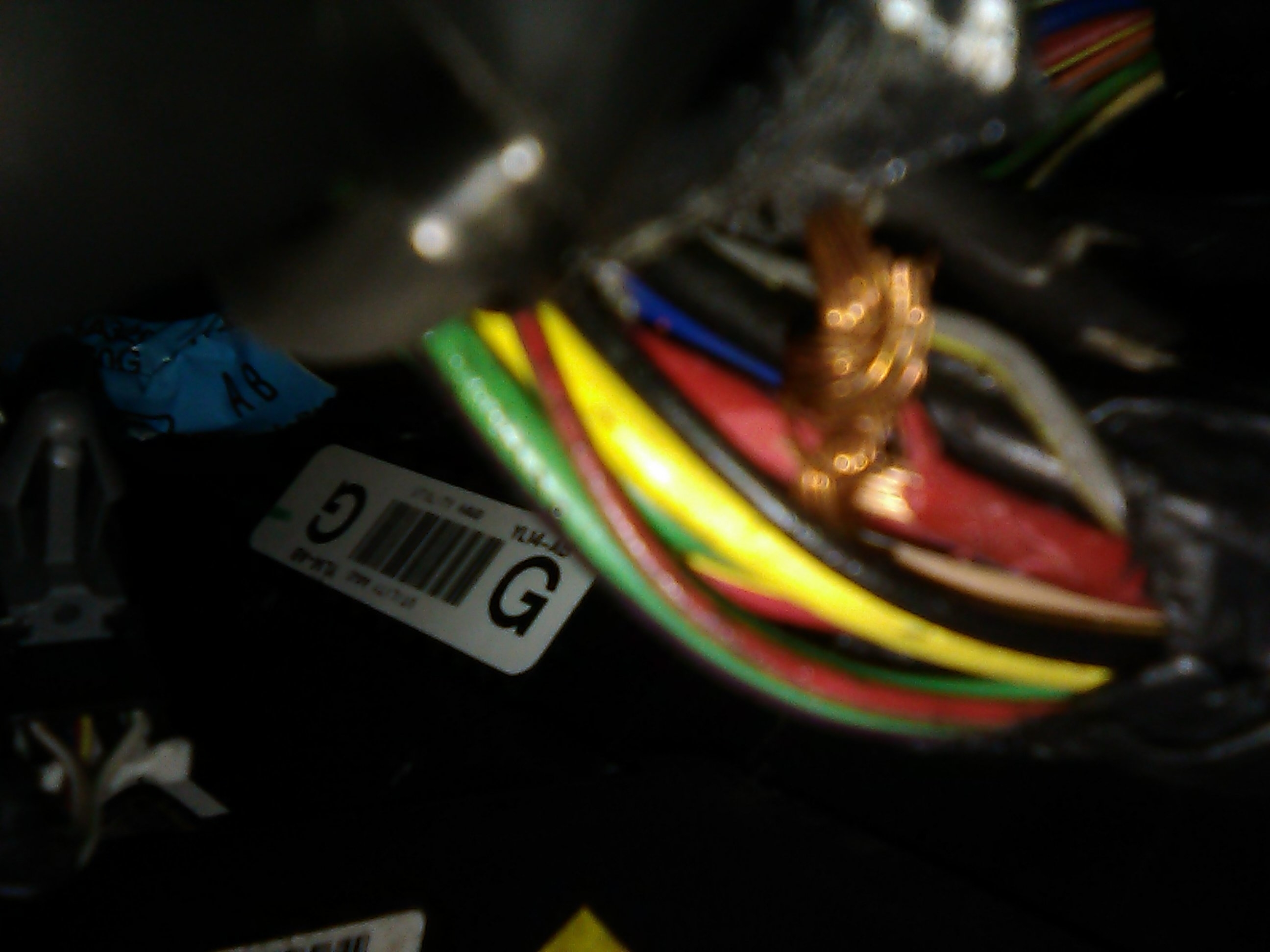

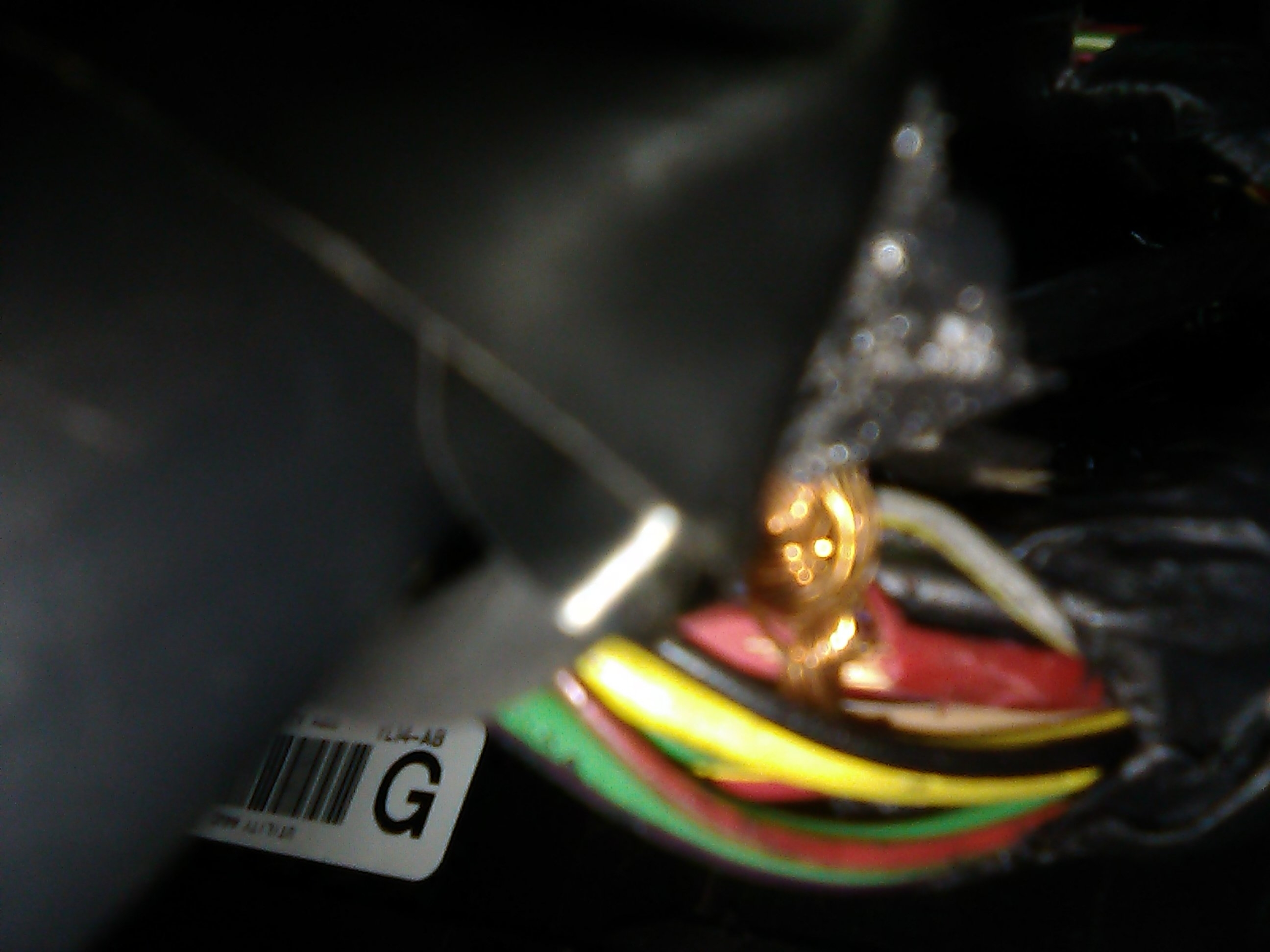

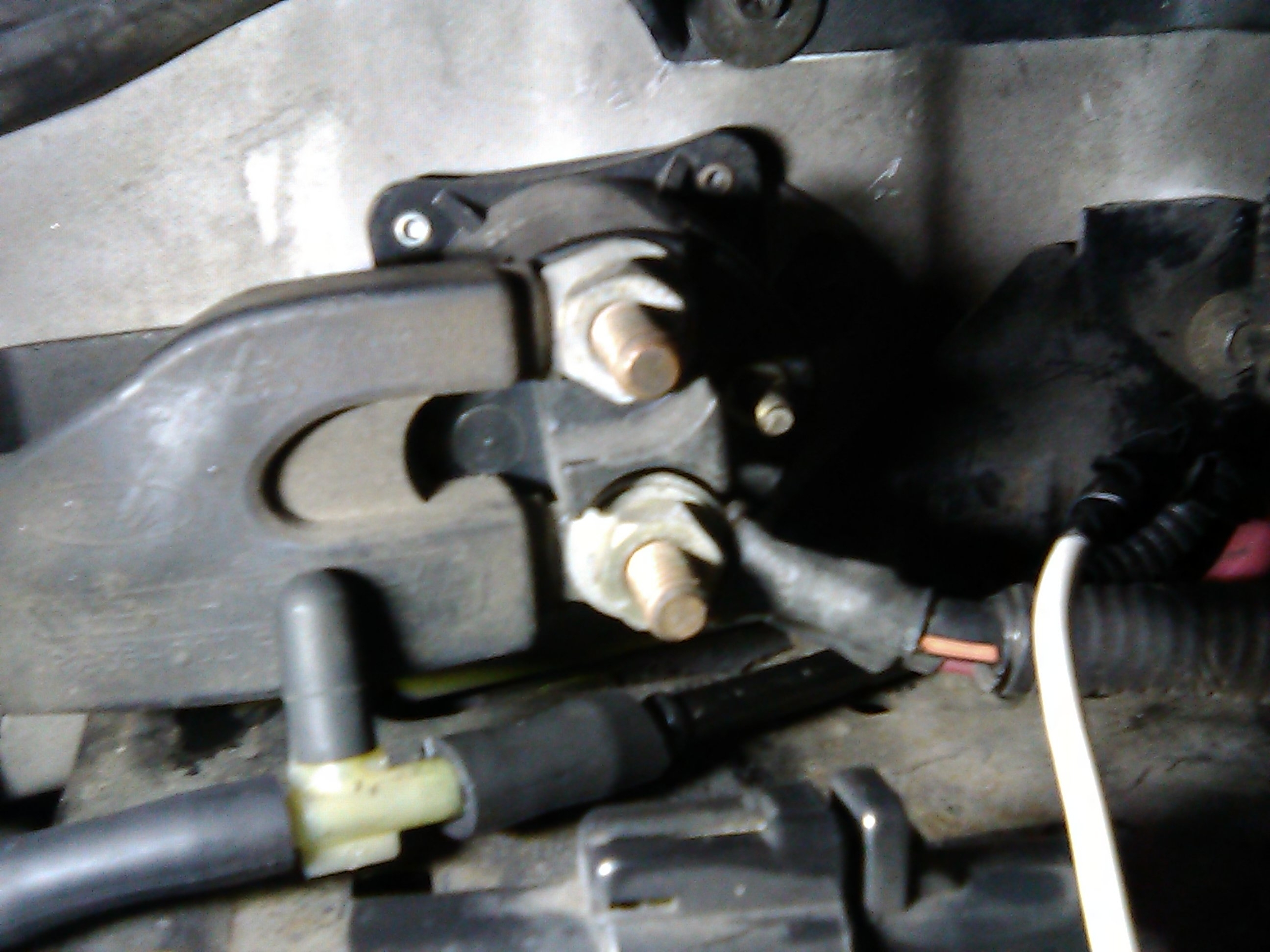

Also there is a strange res wire running from solenoid to the red wire on the ignition switch.

The ignition switch is the one by the key. There is no other ignition switch.
Did you check the wire I highlighted from the switch? Make sure it has power with the key in the on position.

Then what is this that I changed? now the strange red wire I was telling you about runs from that to the solenoid (someone else ran I did not do it). also I should mention that it has an 2005 F150 Triton v8 motor also 5.4L motor.
Jan 13, 2020 at 1:52 AM
Can you post a picture of the red wire?

It's red on the inside where they hooked it up too on that switch, but turns to black wire running to solenoid and was hooked up to S post on the solenoid, but the tan/red wire original has power to it until you turn the key on. Then loses all power and so does that black/red wire. Should it have power when the key is on?
Jan 13, 2020 at 2:13 AM
No, it should only have power in the start position for the starter to work.
Why did they add this wire?

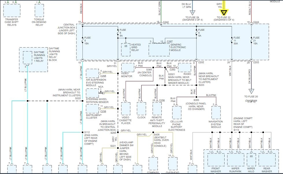

Did you verify power out of the switch for the fuse box for fuse 29?

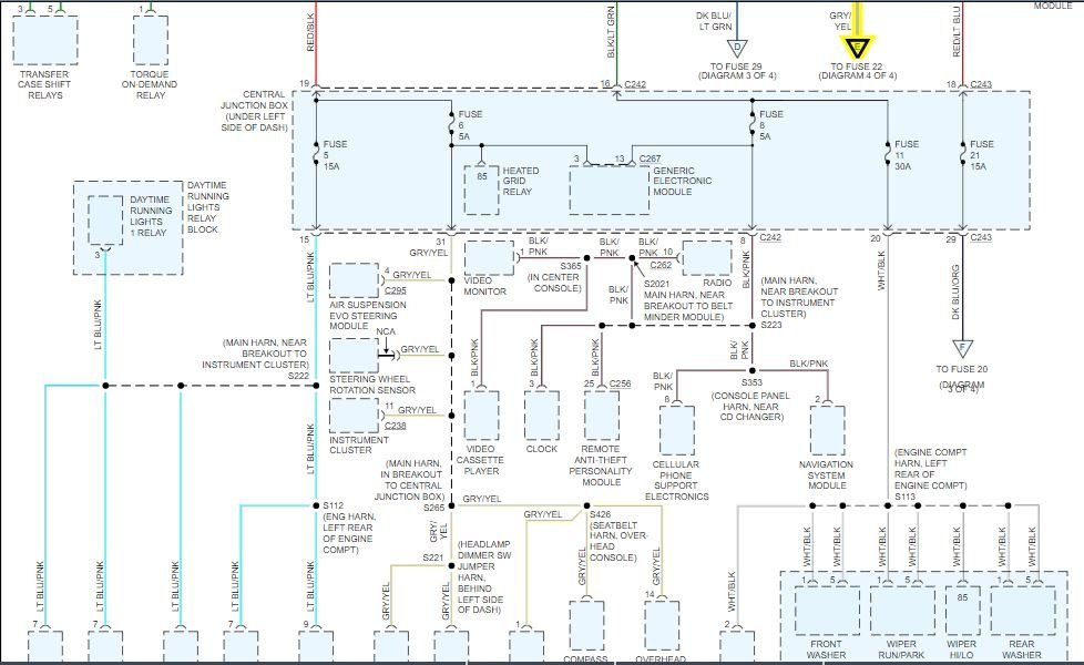

This is what it sounds like the issue actually is.
There is a wiring issue from the ignition switch to the fuse box. You need that power to get this truck to run.

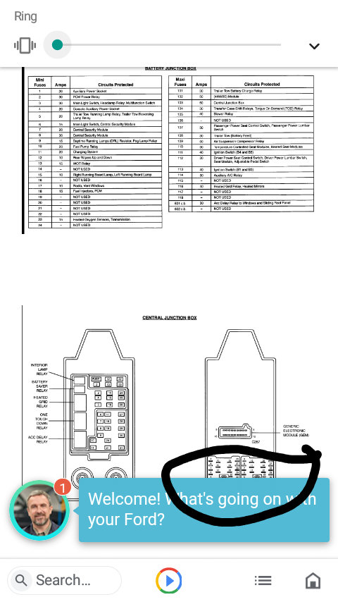

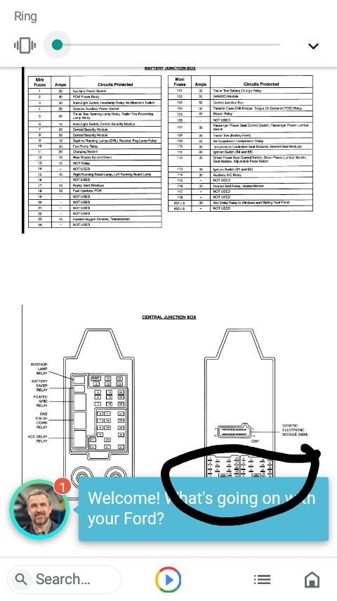

One other question, why does it on the back of the passenger compartment diagram are the pin/plugs why are they number (online diagram)?
Jan 13, 2020 at 3:21 AM
For reference. It for the diagrams themselves for placement.
