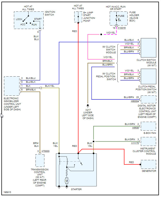

Put a new battery in went to start the car and nothing; No nothing, no crank, no start, no click. OBD scanner reads 80 Transmission partial. Been doing a lot of searching and reading forums read things about the EWS and DME don’t know much about that I put in a new fuel pump relay which I read can cause a no crank, no start. I even put new battery in key forbs still nothing?
