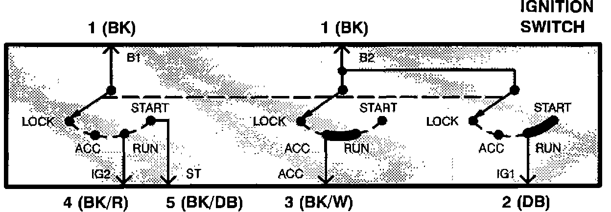

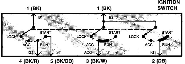

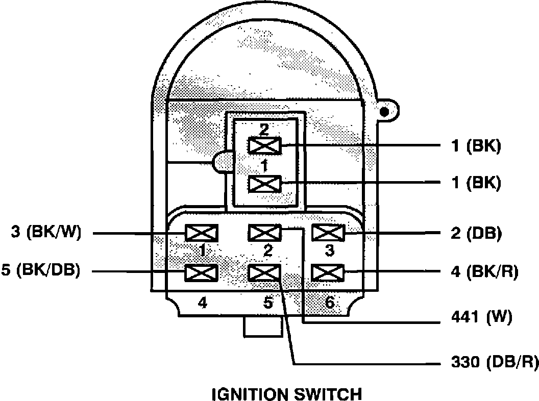

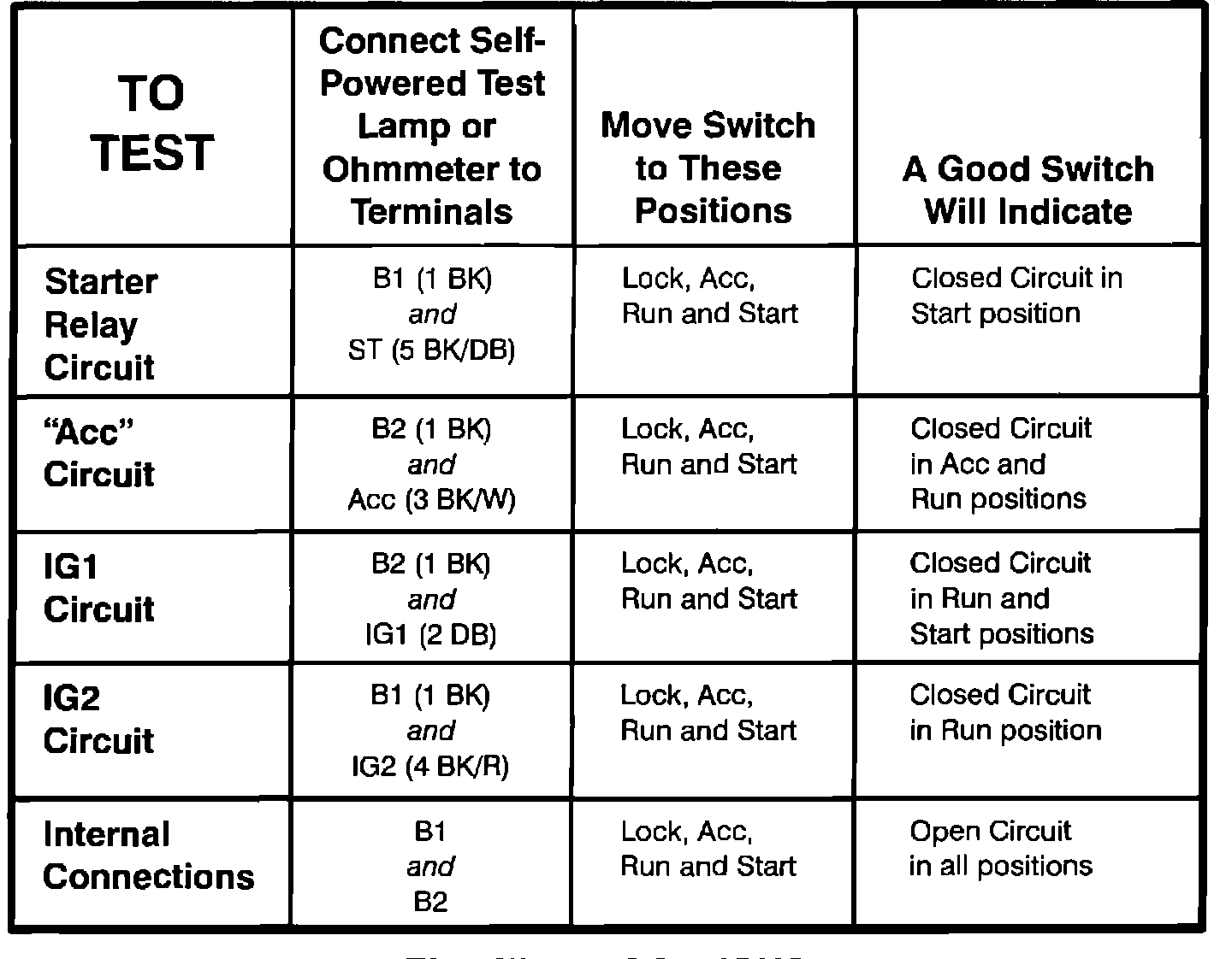

Based on what you have already checked, it does sound like the ignition switch. However, I am going to provide the checks needed to confirm. Here are the directions for testing the switch. The attached pics correlate with the directions.
_____________________________________________
1994 Mercury Tracer L4-116 1.9L SOHC
Component Tests and General Diagnostics
Vehicle Starting and Charging Sensors and Switches - Starting and Charging Ignition Switch Testing and Inspection Component Tests and General Diagnostics
Component Testing Procedure
pic 1
Terminal Locations
Terminal ID
pic 2
Schematic
Schematic
pic 3
