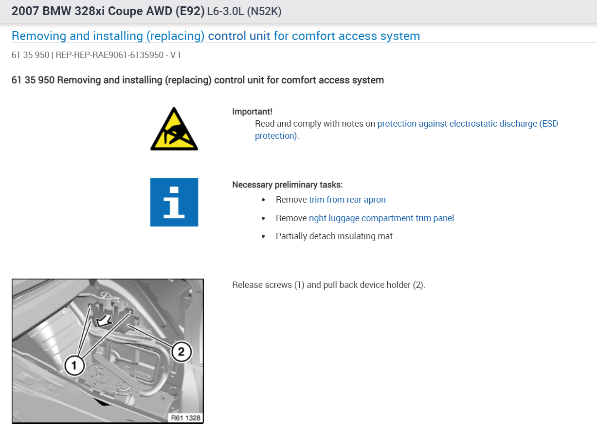

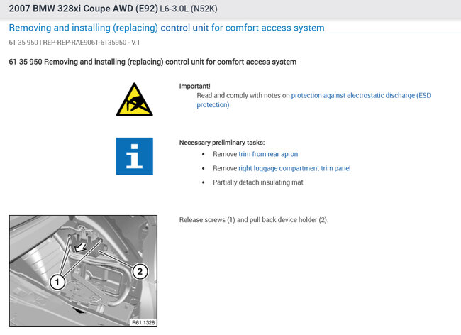

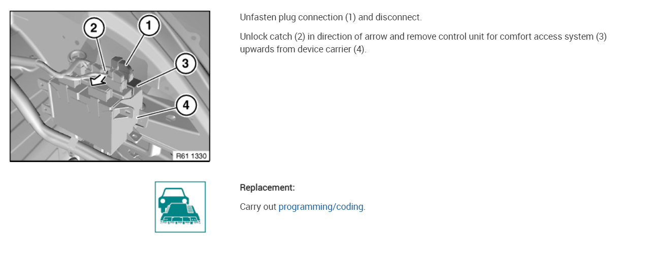

Engine start is inhibited if a fault is detected. Check out the images (below). Please let us know what you find.
