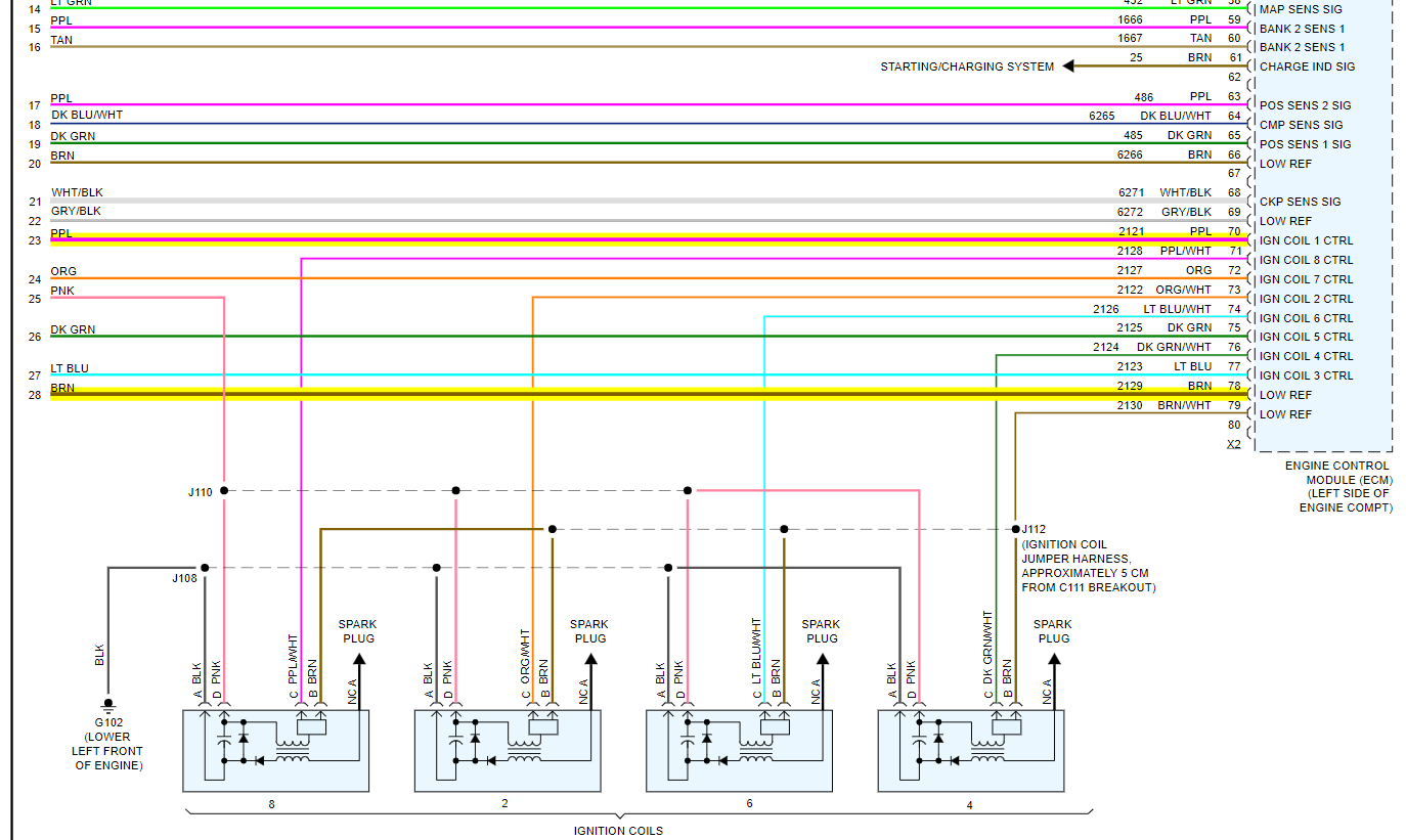

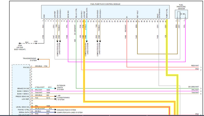

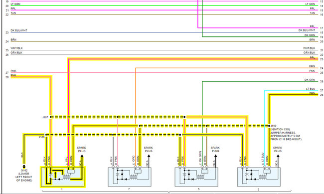

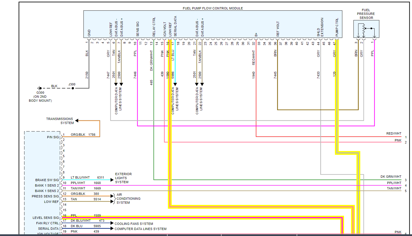

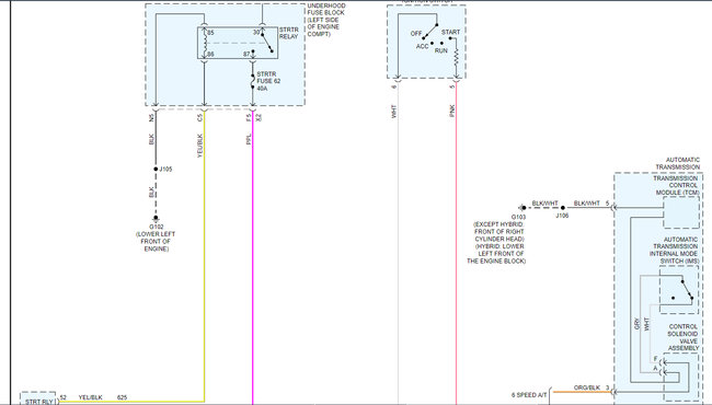

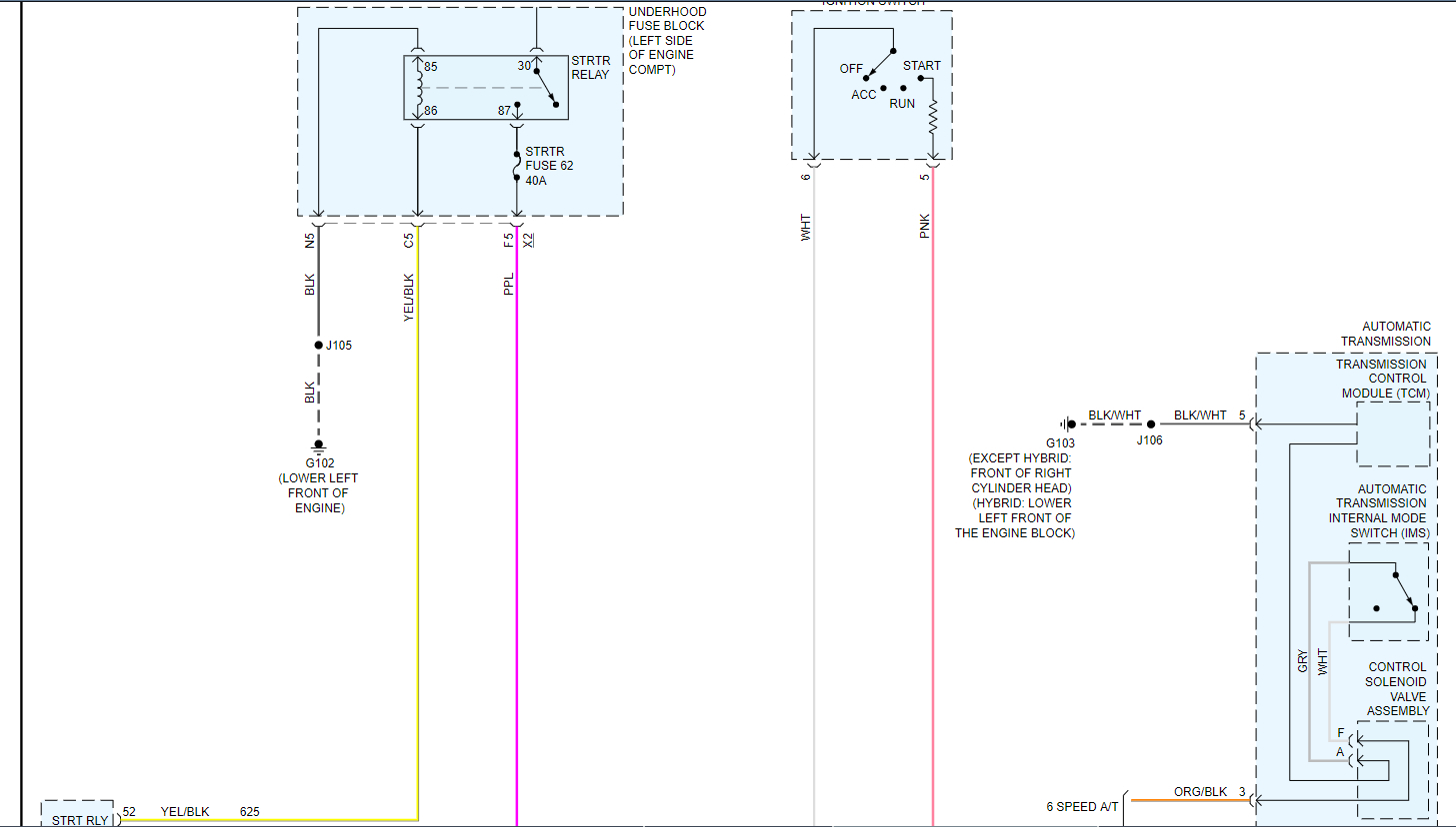

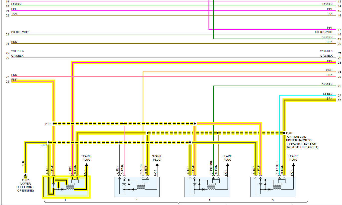

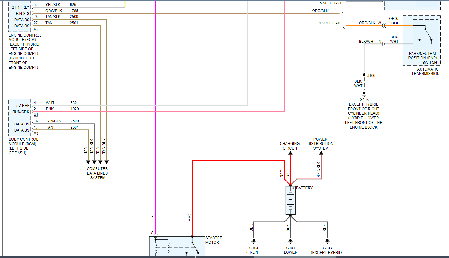

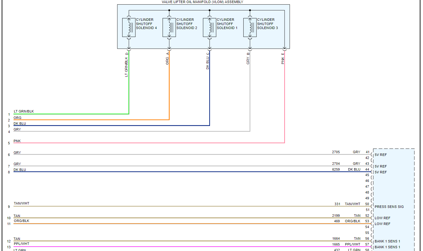

I attached the wiring diagram for you as well for the starting system. See if you have any codes in the system. The security goes through the body control module.

Okay, I have done more troubleshooting since and this is what I know. I have no security light showing except when I turn the key to the run position it comes on but goes out as usual during normal operations. I can get the starter to crank from the fuse box and I do have fuel pressure at the fuel rail but no start. I checked the FPCM and also tested the fuel pump from there and both tested ok. Fuses and relays present and good. So right now I have nothing when I turn the key to start the vehicle and no spark when I do crank it over. The advise was thorough that you have given so far and much appreciated. Any walk through on what to test next wo6uld be great, I have been working on this issue going on for three days and I'm stumped. I don't think it's security related however you know more than I do.

Can you check voltages at the starter relay as well? You need a constant 12 volts on pin 30.
You need voltage at pin 86 in the start position. Can you verify that?
