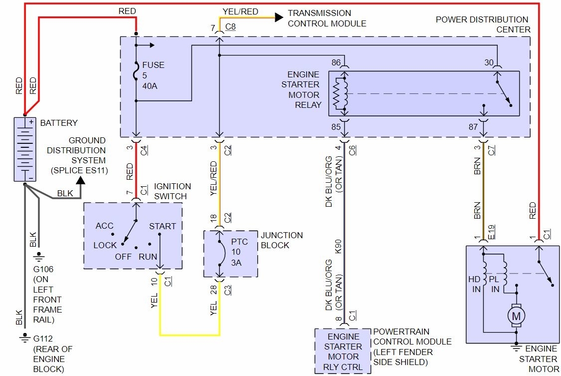

The description sounds like a failed ignition switch or the park/neutral switch. Try shifting it into neutral and wiggling the shift lever while holding the key in start. If that gets nothing then you will need to do some testing at the starter relay to see if there is power and ground to the starter relay. Attached you will find the starting circuit schematic.
If you have a test light handy you can test the circuit easily. First be sure that the battery cable connections are clean and tight at both ends, have seen many no crank issues caused by a failed battery cable. Then take the test light connected to ground and turn the key to start while touching the test light tip to terminal 86 in the starter relay socket. If the light comes on the switch is working and the fuse and the 3A circuit breaker is okay. If the light does not light, pull the circuit breaker and test on both terminals for power with the key in start. There should be power on one side. The other sends power to the relay. If you find power there but not in the relay socket, the breaker may be bad. To test if it is the breaker or the wiring just probe the power terminal in the relay socket and use a jumper in place of the circuit breaker. If you have power at one side of the breaker and install a jumper and still do not have power in the relay socket the wiring is open.
If you find power on terminal 86 with the key in start, release the key, then connect the test light to battery positive. Touch terminal 85 and hold the key in start. If the light comes on the PCM is supplying the ground. If no light then you need to see if there is a ground at the PCM itself with the key in start. If there is then the wire between the PCM and relay socket is bad.
Do those tests and see what you find. Post back with the results please.

Battery and cables checked out. Checked pin 86 and test light came on. Checked pin 85 and no light. You said to check the ground at the PCM, where should I check that at? Do I back probe the wire that comes from pin 86 to the PCM harness or is there a way to check the PCM ground in general? I am somewhat familiar with working on cars but, thank goodness, I have not ever really had to deal with electrical problems so it is not my strong point. So, where do I go from here?

If you do not have a ground at pin 85 with the key on then go to the PCM harness and check continuity from pin 8 in connector 1 to pin 85. If that works then either the PCM is not receiving the crank signal through the transmission control module and it does not switch the ground on, or the PCM is bad. However based on your symptoms I am going to guess it is an issue with the neutral safety switch/range sensor not operating correctly.
It is a convoluted system in the way it works. You turn the key to start. The battery voltage gets to the starter relay and stops. The leg going to the transmission control module wakes it up and it looks at the inputs from the neutral switch. If it shows park/neutral then it tells the PCM that it is okay to start the car. The PCM then grounds the relay and the engine turns over.
The testing you did shows the voltage switching to the relay is good. Now we need to verify the signal through the transmission module and "range sensor" is working.
One way to also verify that the wiring is okay would be to use a jumper wire from pin 85's wire (dark blue/orange stripe or tan wire) to ground. If turning the key now cranks the engine (might even start up with that ground) you have an issue in the switch or wiring on the transmission side (more likely the switch)

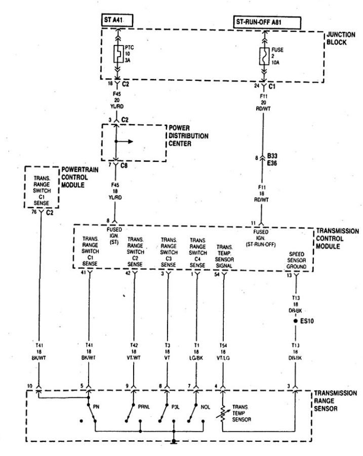

For that we will start with fuse 2. It provides the power to the range sensor through the TCM. The switches are cheap compared to the time it takes to test them. Yours should be the one in the middle. The other one is the early build with the three speed trans. Rather than testing each circuit I would install a new switch and go from there. The connectors and switches are both failure prone.

However you can test it if you wish. The first schematic has the pin outs and in park/neutral it should have a ground on the black wire with white stripe. The ground should go away in all other gears.

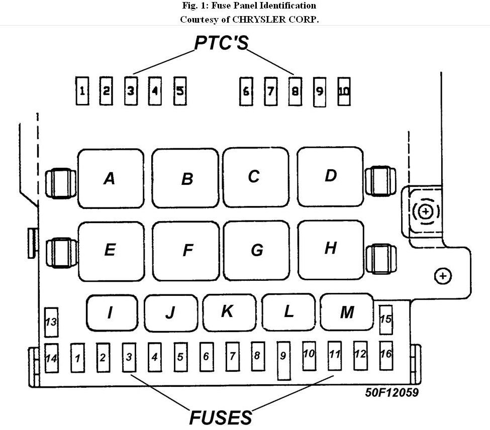

PTC 10 is a self resetting thermal fuse, works like a circuit breaker but for smaller loads. The junction block is under the hood and should resemble the image below.

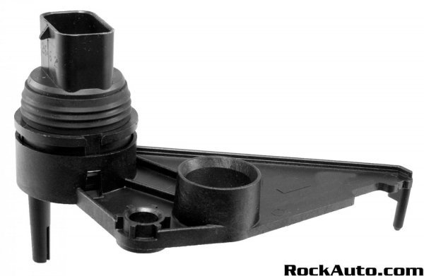

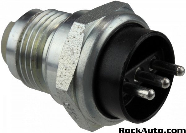

Okay, the neutral safety switch that you referred too, which is the middle picture, looks like what I have. Now the big question, because I cannot seem to find a good reference, how do you replace it? It does not look as though it is as easy as the other one which screws out and then in, just my luck. I could really use some help with this.
