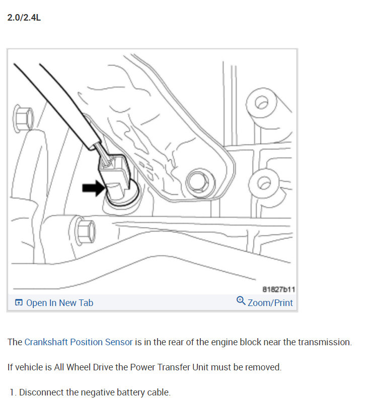

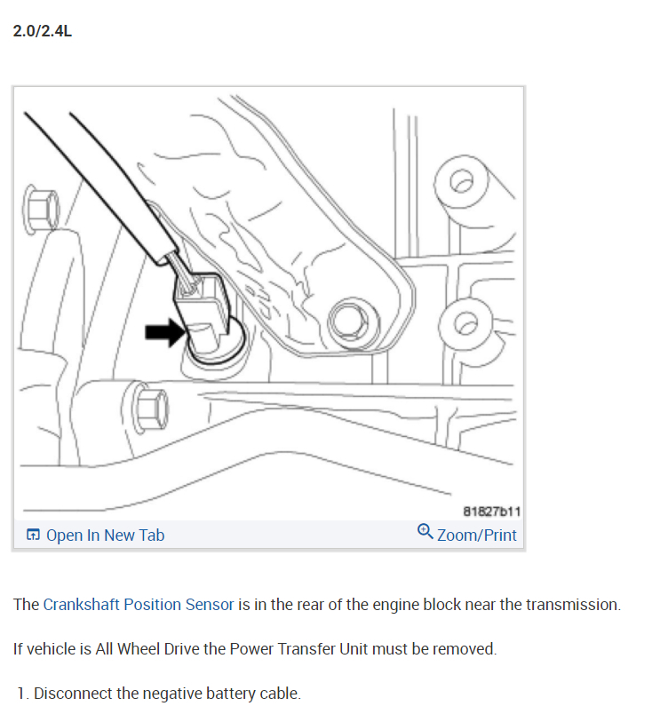

This could be a problem with your vehicle's Crankshaft Position Sensor (CKP). It keeps track of the crankshaft and your vehicle's Power-train Control Module (PCM) uses this information for crankshaft speed, location in four stroke cycle, and misfire monitor. Your vehicle's engine needs this information to start. I have included a few links down below for you to go to:
https://www.2carpros.com/articles/how-a-crank-shaft-angle-sensor-works
I have also included the location of your vehicle's CKP in the diagrams down below. Please go through these guides and get back to us with what you find out please.

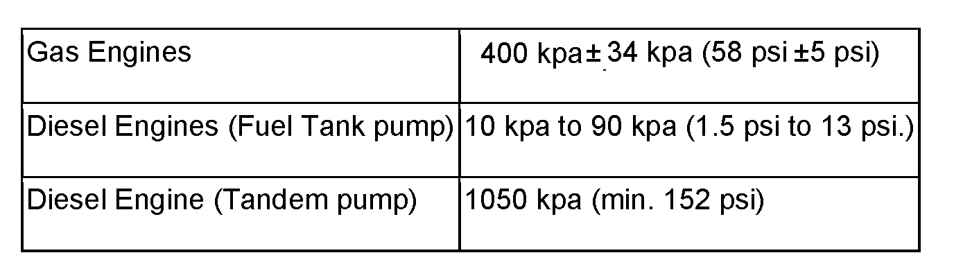

2. CHECKING THE FUEL PRESSURE
Turn the ignition off.
WARNING: The fuel system is under a constant pressure even with the engine off. Before testing or servicing any fuel system hose, fitting or line, the fuel system pressure must be released. Failure to follow these instructions can result in personal injury or death.
Install a fuel pressure gauge on the fuel rail.
Turn the ignition on.
With the scan tool, actuate the fuel pump relay control. Observe the fuel pressure gauge.
NOTE: The fuel pressure specification is 407 KPa ± 34 KPa (59 psi ± 5 psi).
caution: Stop all actuation tests before continuing.
Select the conclusion that best matches the result of the test:
Fuel pressure is within the stated specification
- Test complete.
Fuel pressure is below the stated specification
- Go to 3
Fuel pressure is above the stated specification
- Replace the fuel filter/pressure regulator.
- Perform the PCM Verification Test. See: A L L Diagnostic Trouble Codes ( DTC ) > Verification Tests > PCM Verification Test

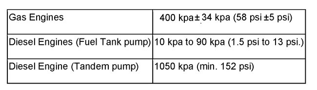

Picture 1 are the fuel pressure specs.

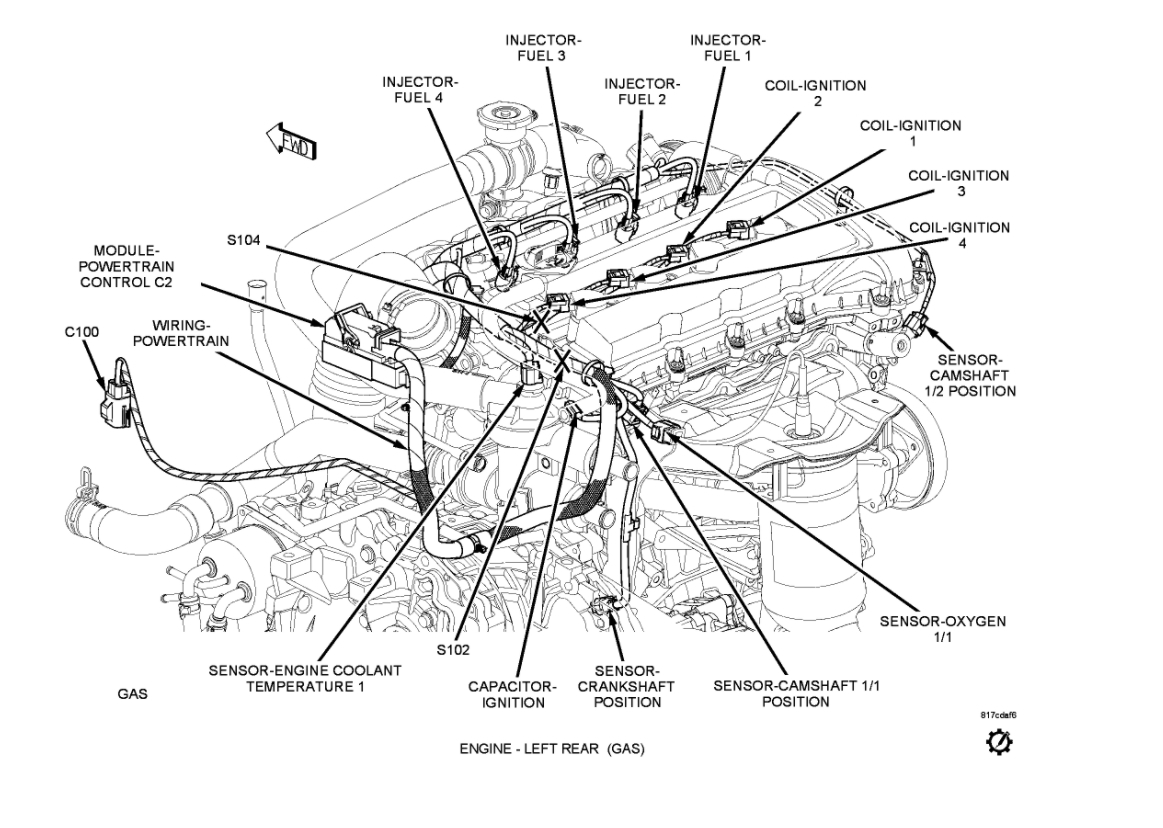

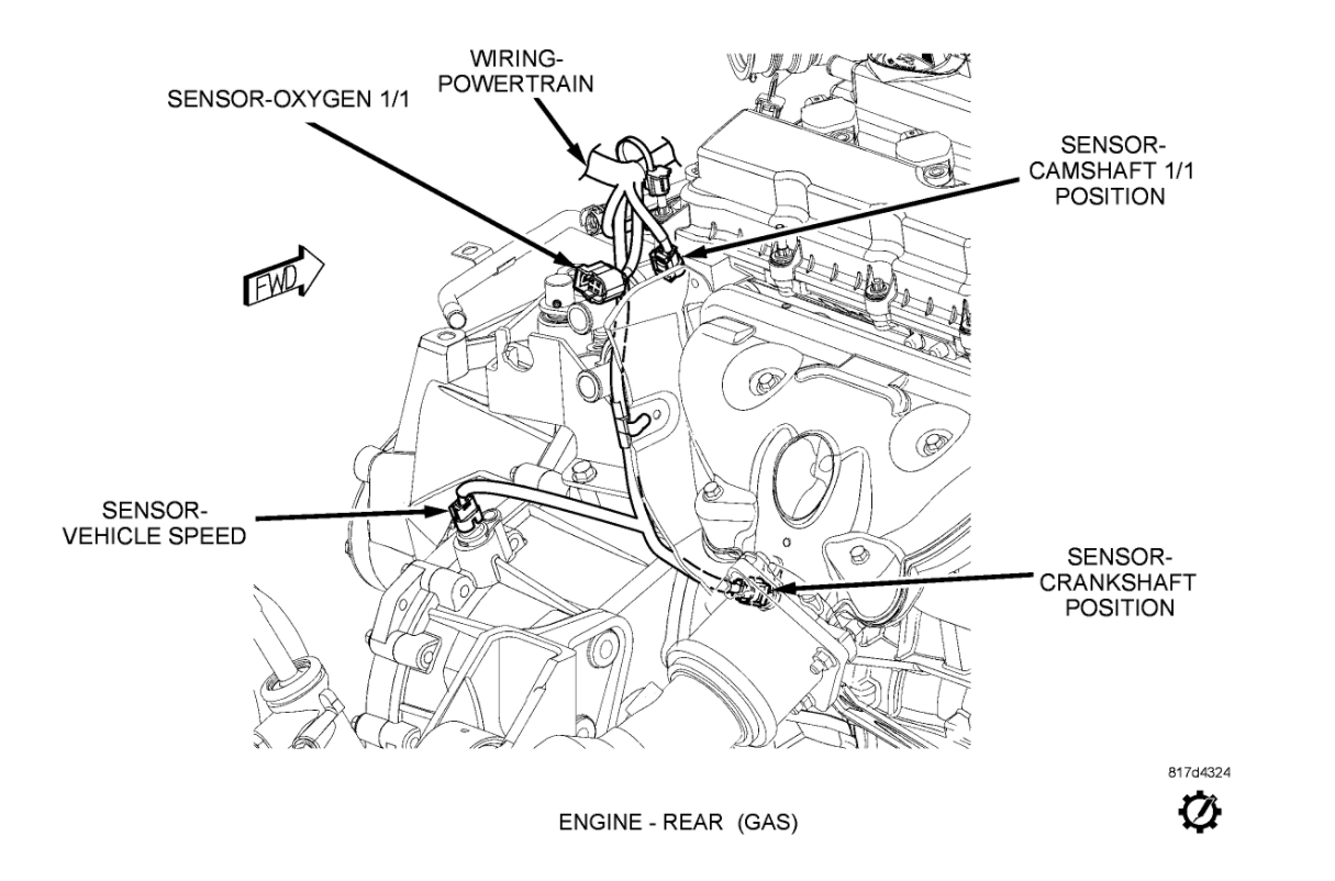

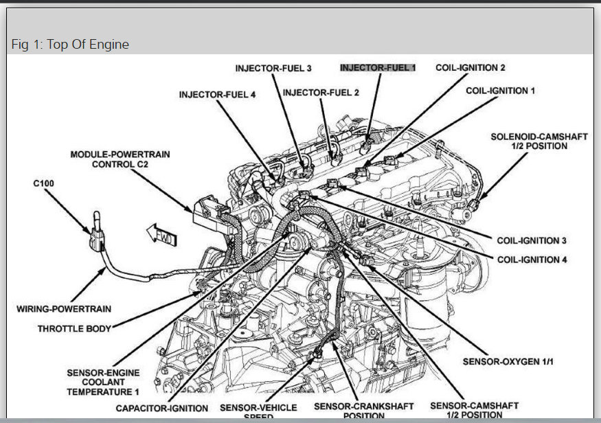

It sounds like you have a main relay or crankshaft angle sensor that is out but to be sure lets run down this guide. When you turn the key to the on position without cranking the engine over can you hear the fuel pump run in the tank for 5 seconds?
here is the crankshaft position sensor just in case. Check out the diagrams (Below). Let us know what happens and please upload pictures or videos of the problem.

Checked codes found the crankshaft sensor was not working I got a new one and it fired up! thanks for your help this is a great site I cant believe it is free :)

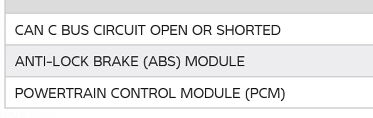

this is a toughy because your can bus has lost communication for a speed sensor. all of t hese codes relate to what is in the pic. which i'd kind of believe it may be a shorted wire. This can be caused by nearly anything even a poor connection. A mechanic will definitely h ave to look at this and can't really give you a price because they vary all over and this may be a easy job or hard which involves time. I doubt it is from changing oil but tell the mechanic about the brakes job as well as something may have been damaged there. also nothing more than changing oil and filter should ever be done at one of these places. nothing more most are not qualified to do this type of work.
