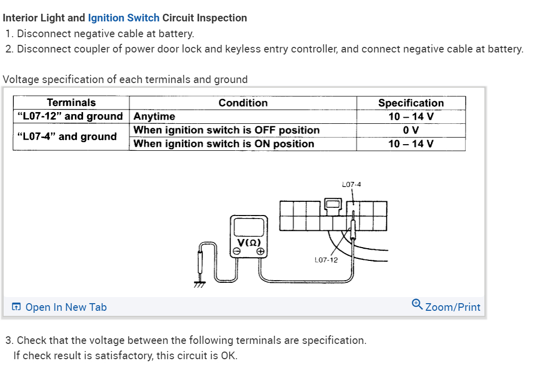

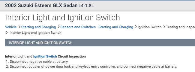

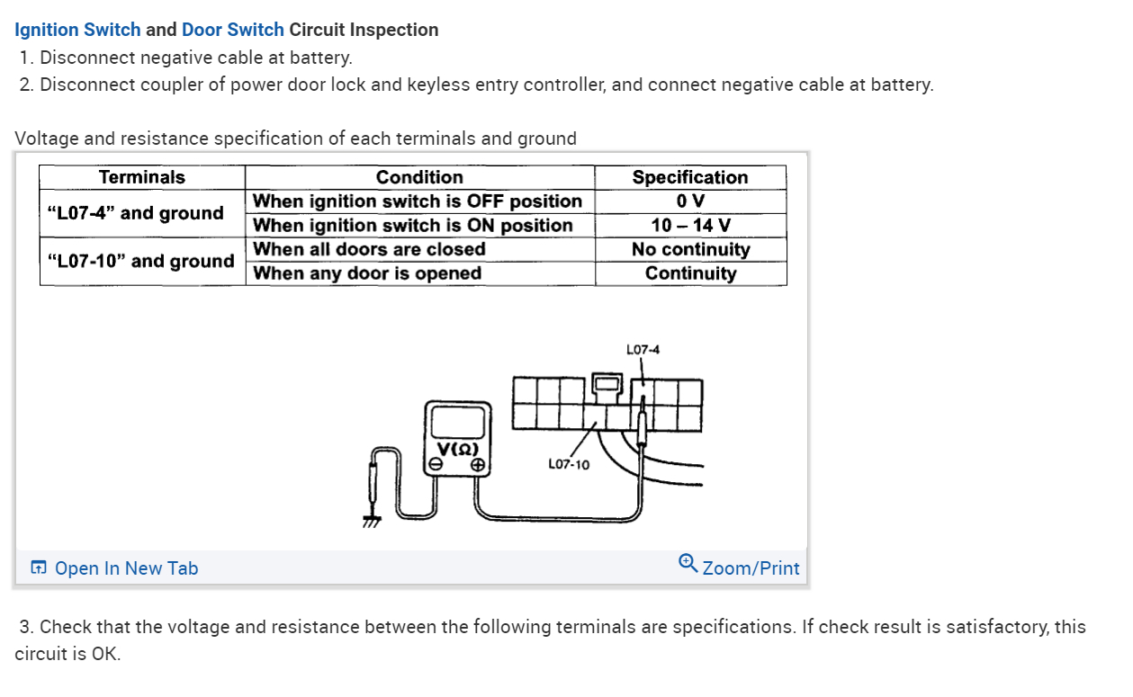

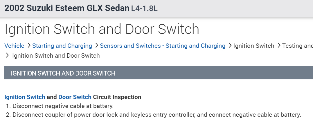

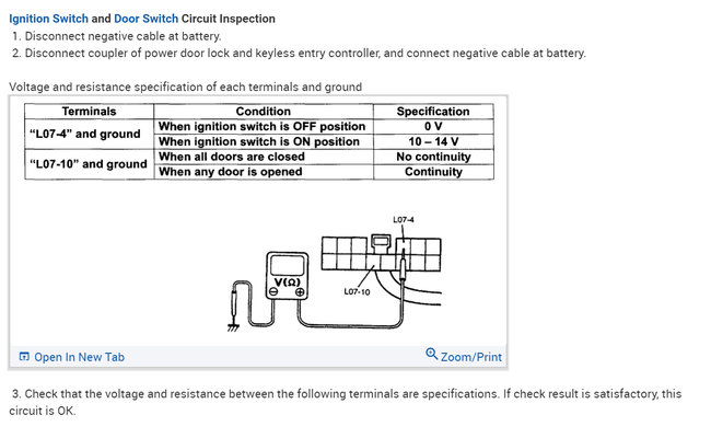

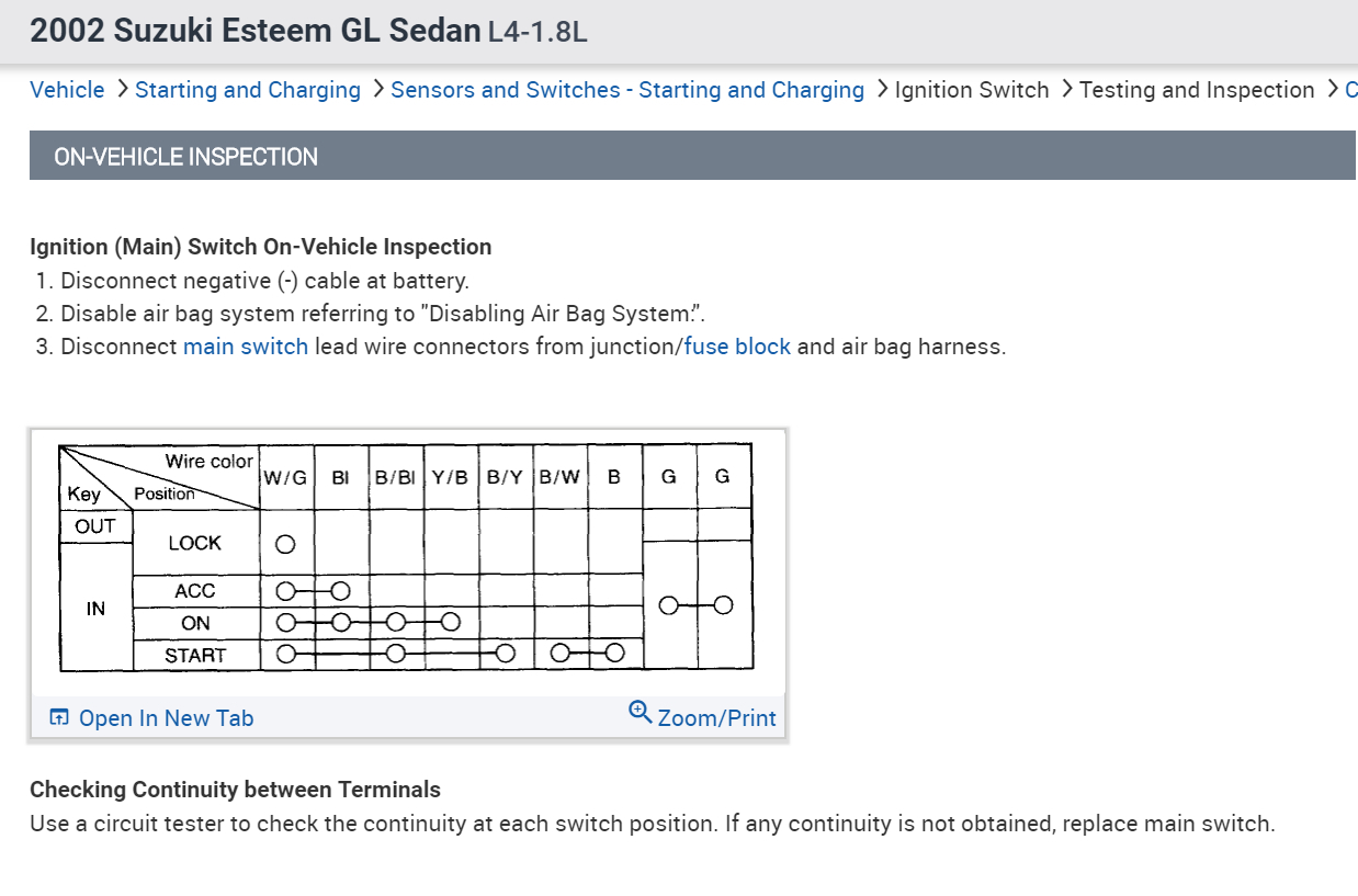

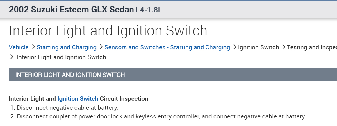

Hello again,
Okay, I have included in the diagrams down below a troubleshooting guide for checking your ignition switch. Please go through these guides and get to us with what you find out.
Thanks,
Alex
2CarPros
Feb 21, 2019 at 12:33 PM

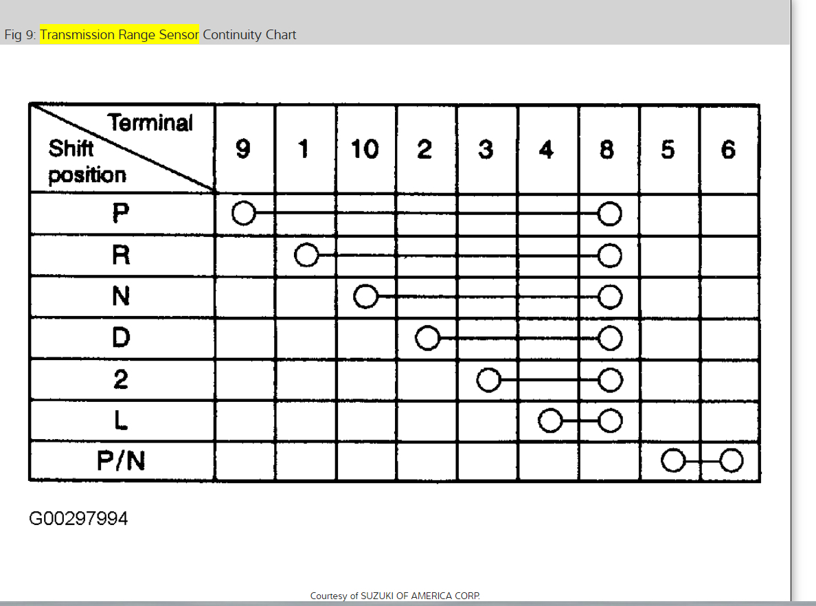

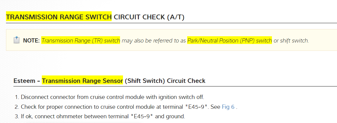

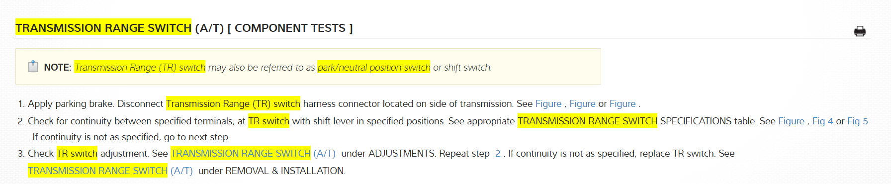

LARRY NASON
  • 48 POSTS

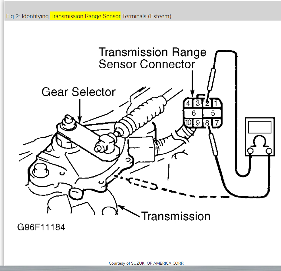

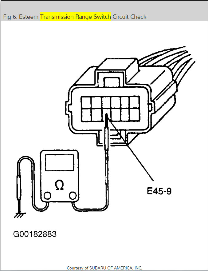

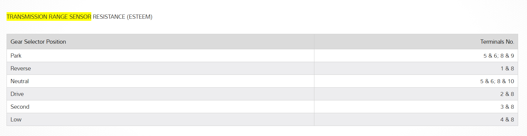

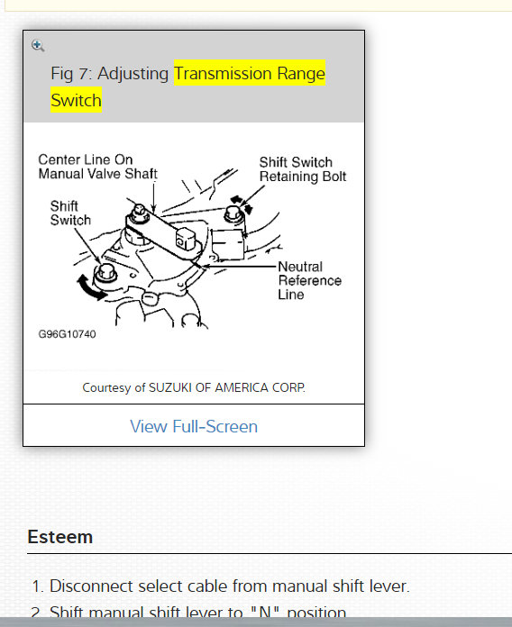

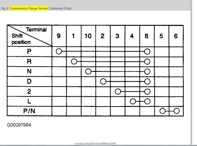

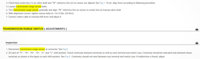

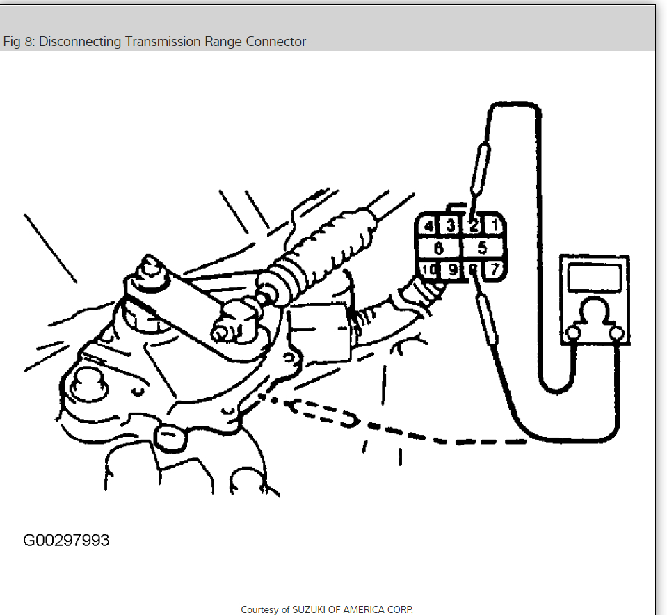

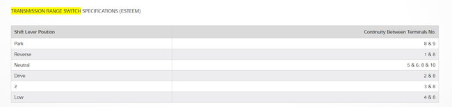

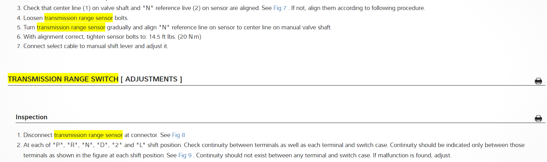

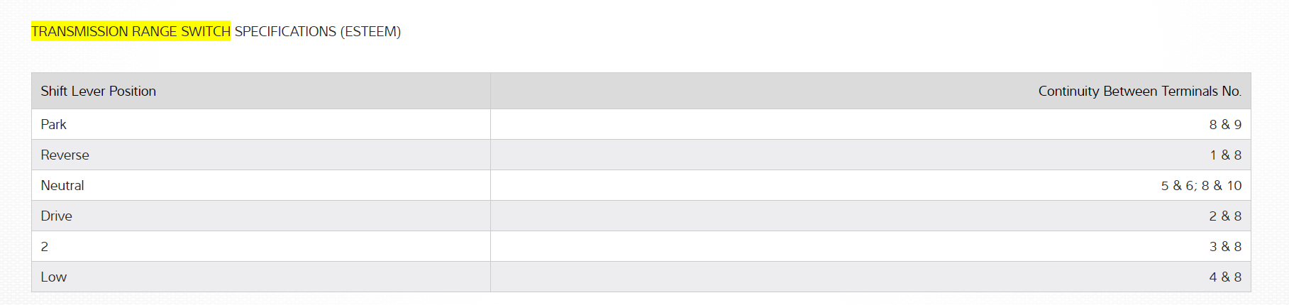

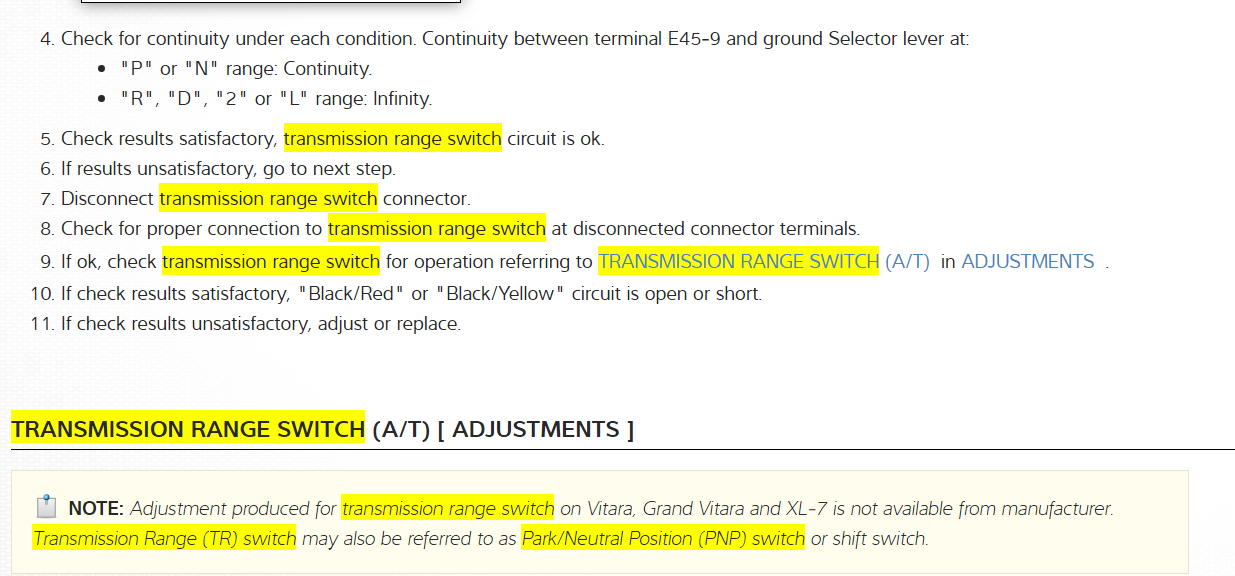

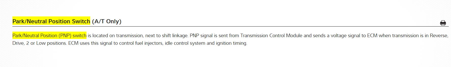

So I replaced the ignition switch still no luck. Can you tell me where the neutral safety switch is on this car?
Feb 24, 2019 at 7:21 AM
SCGRANTURISMO
  • 4,897 POSTS

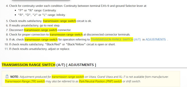

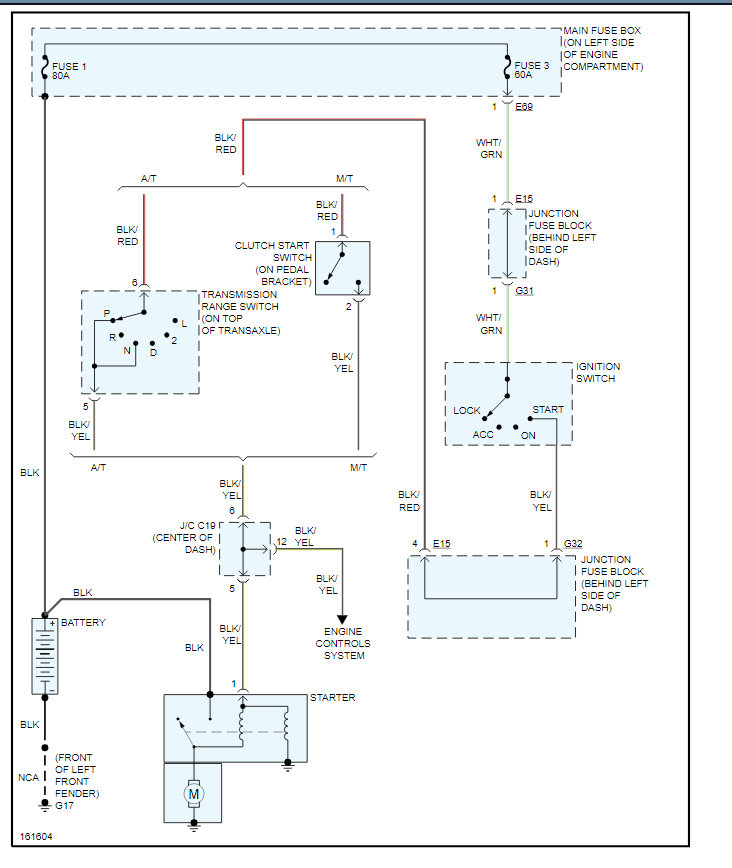

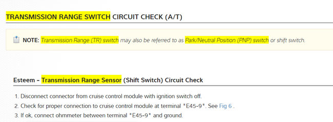

Hello again,
I have included the information you requested as well as a few other things in the diagrams below. Let us know what you find out.
Thanks,
Alex
2CarPros
Feb 24, 2019 at 8:51 AM
