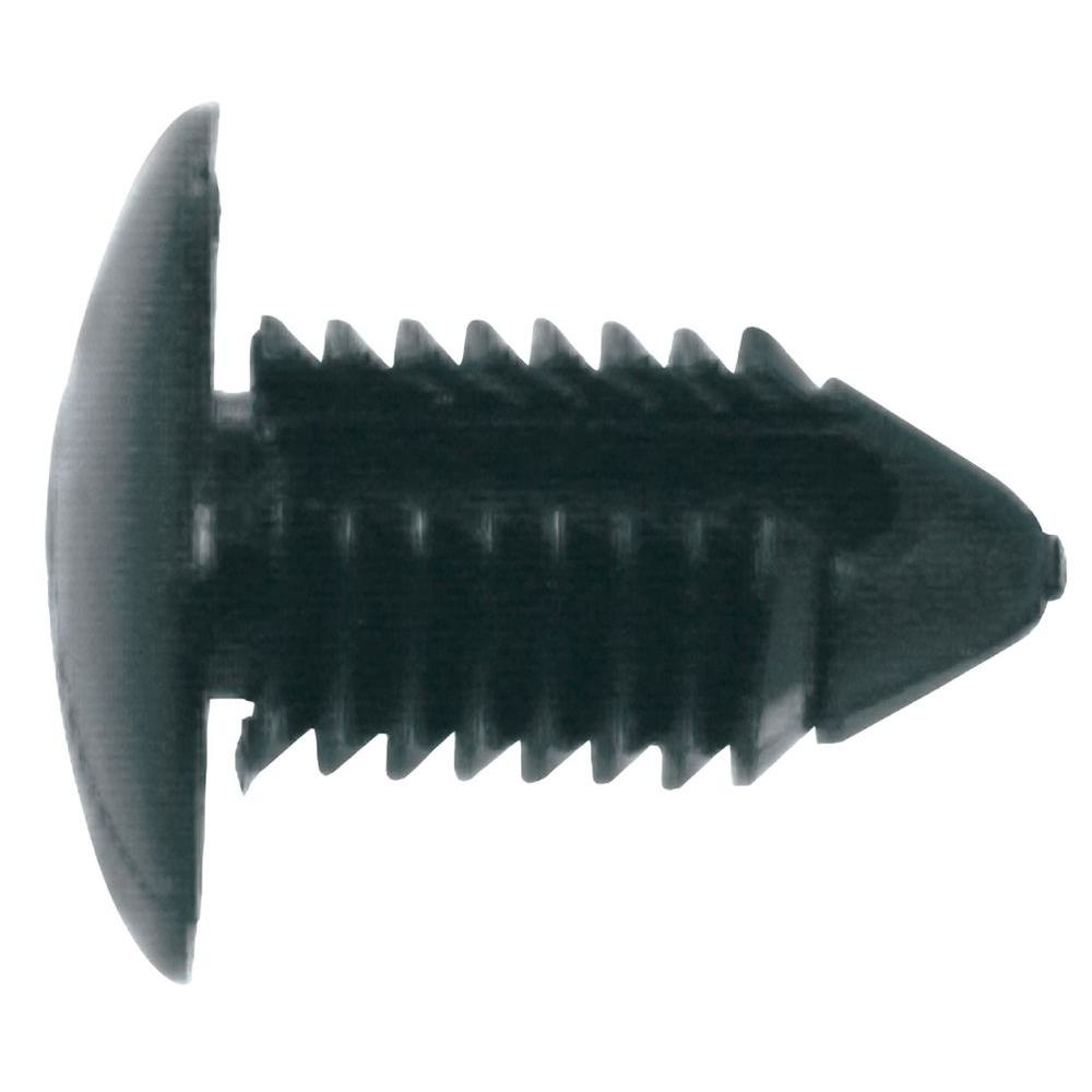

That pedal button can do it. It is supposed to push the clutch interlock switch and allow the starter to function. If it is gone you can sometimes flex the pedal to the side enough to push the switch and start the car so you can get the part. Or you can replace it with just about anything that will fit in the hole, I generally use a trim tree, They are much cheaper than the OEM part and are usually in the help isle at a parts store.
