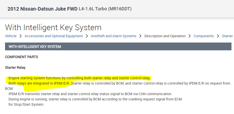

That is the intelligent system. There is a starter relay and a starter control relay that work together. Both are integral to the IPDM. (See pic below)
Here is what I would recommend. Rather than just replacing the IPDM, scan the can-bus system to see if there are codes related to the issue.
CAN stands for controller area network. Basically, the different modules are tied together via a few wires so they can communicate with each other. This type of scan will retrieve codes regardless of the module storing them.

Although I suspect the IPDM is the faulty part, I would feel more comfortable knowing for certain. I'm sure you understand.
See pic below.

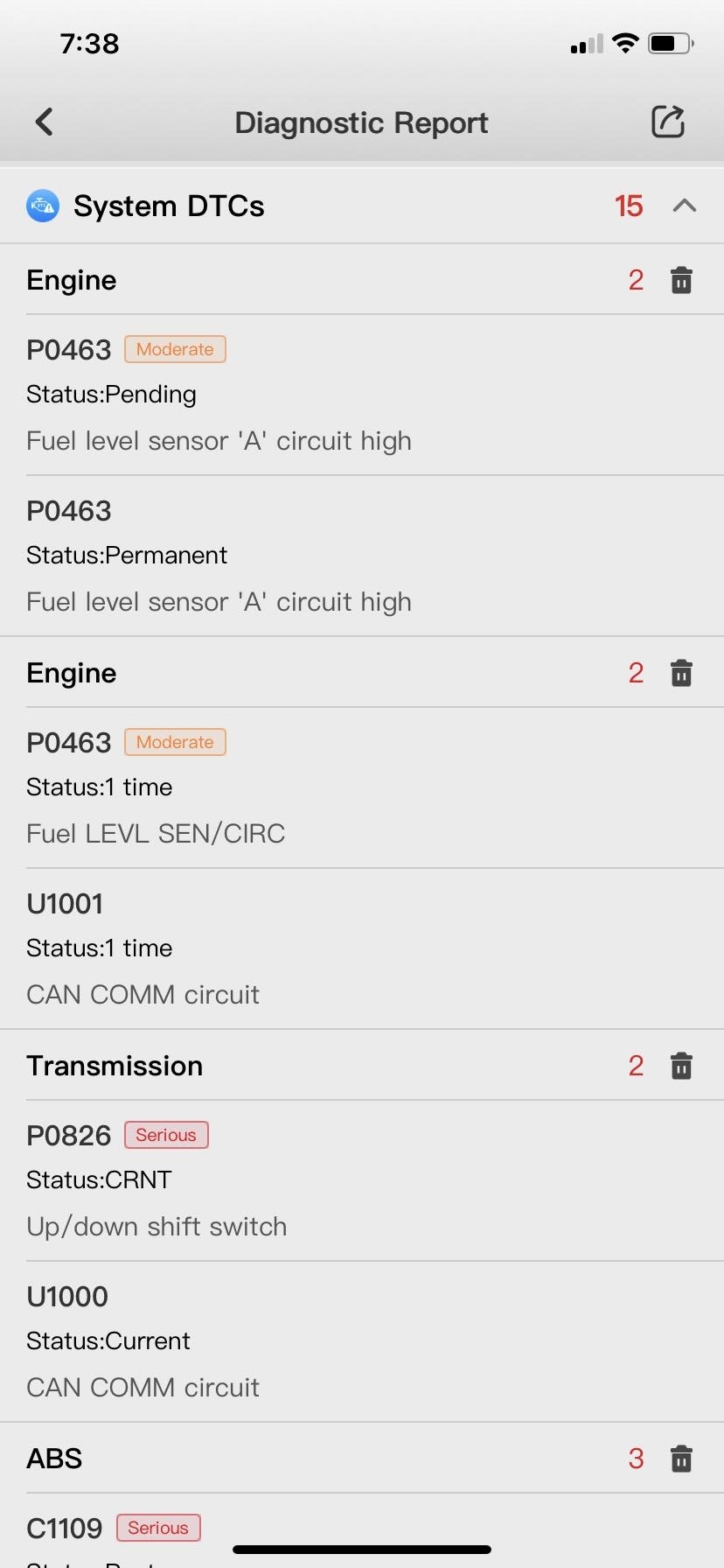

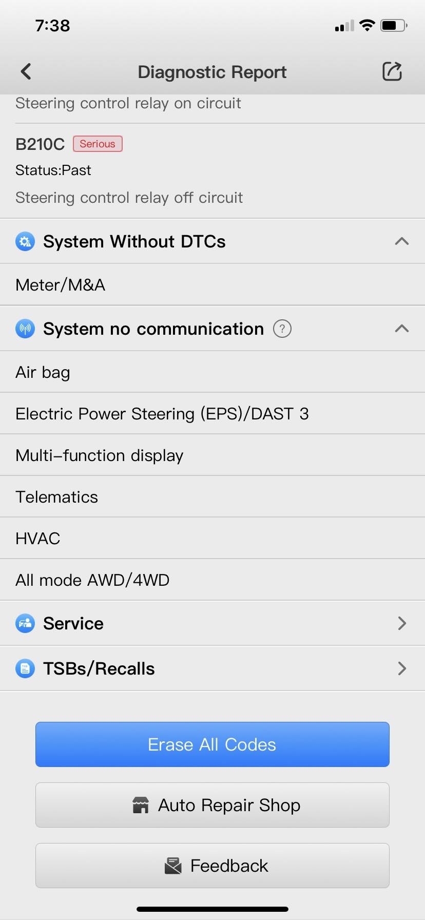

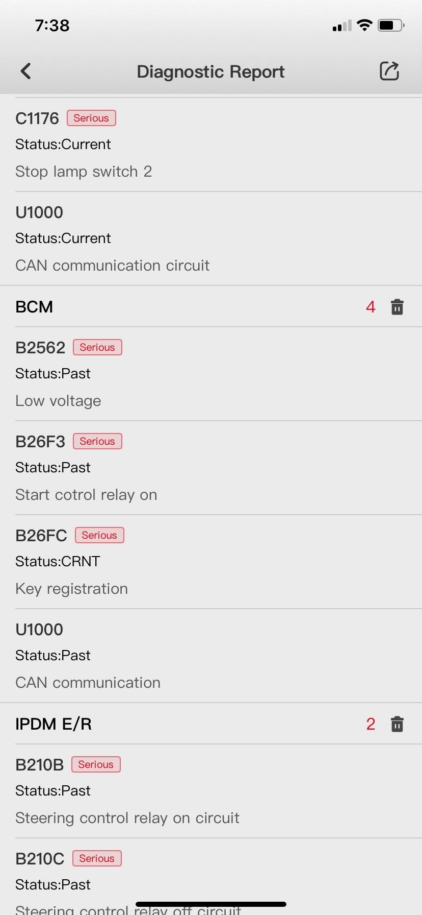

Hello, sorry for the late reply waited on a decent scan tool to scan my car because my basic scan tool would not pick up any codes.

YANNI CRISANTOS
  • 9 POSTS
Image 2
Jun 20, 2024 at 6:12 PM
YANNI CRISANTOS
  • 9 POSTS
Image 3
Jun 20, 2024 at 6:13 PM

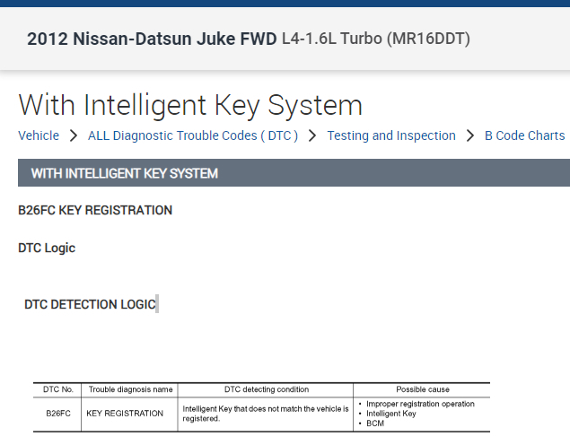

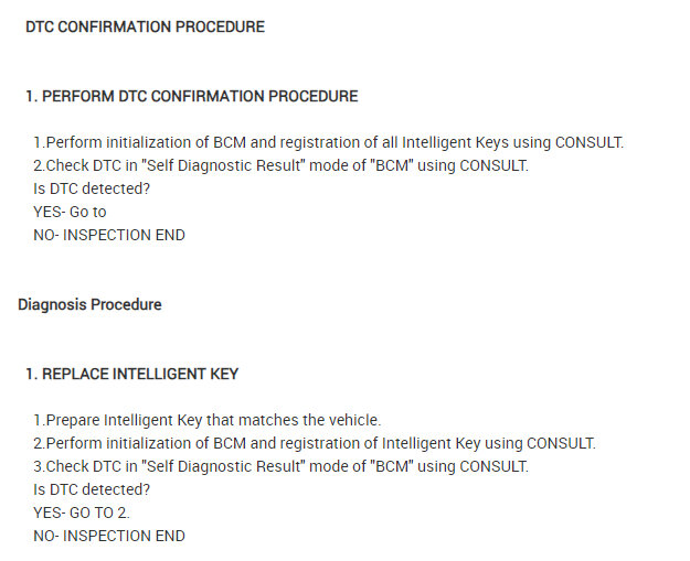

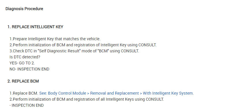

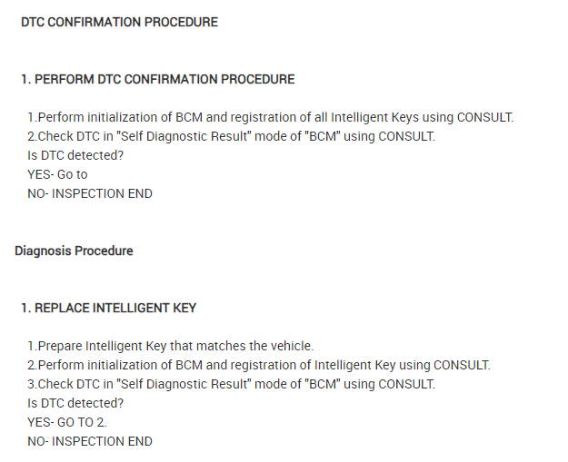

It appears the intelligent ignition system doesn't recognize the key is present. If you have a spare key, try that. If you don't, we need to have one made that is known good and matches the vehicle.
I attached the diagnostics below.
joe
See pics below.
