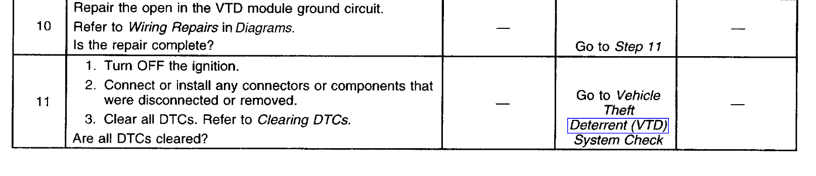

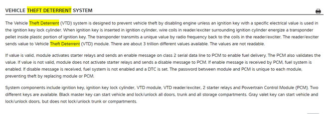

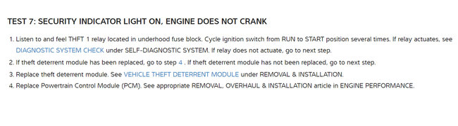

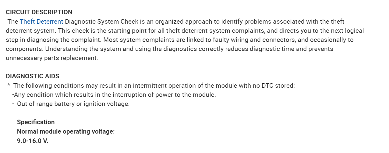

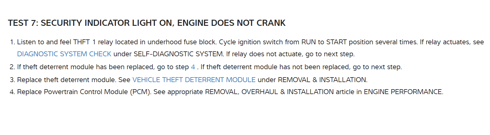

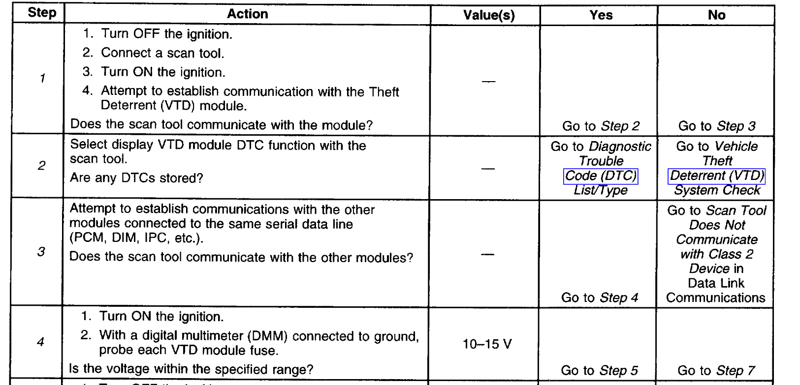

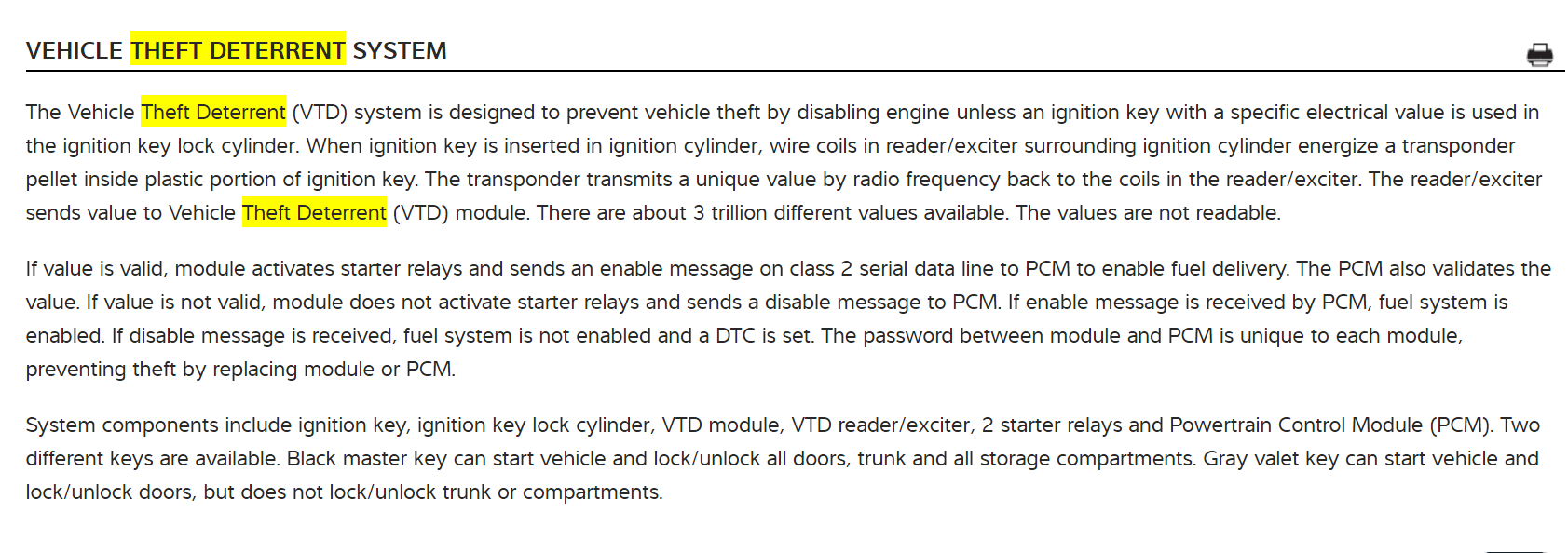

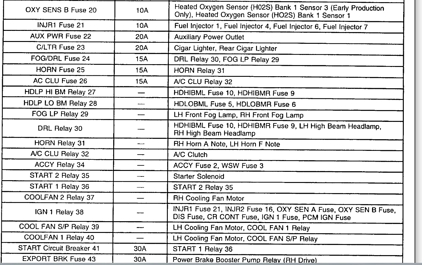

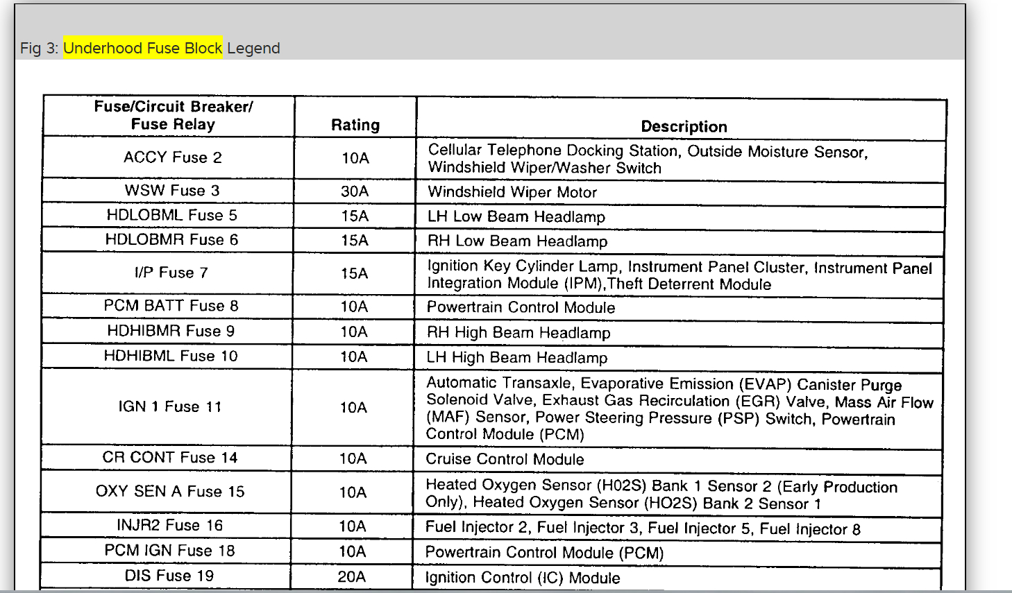

This could be a problem with your vehicle's Vehicle Theft Deterrent module (VTD). In the diagrams down below I have included a description of how your vehicle's VTD works and pinpoint tests to determine the problem with the VTD system. Please go through these guides and get back to us with what you are able to find out.

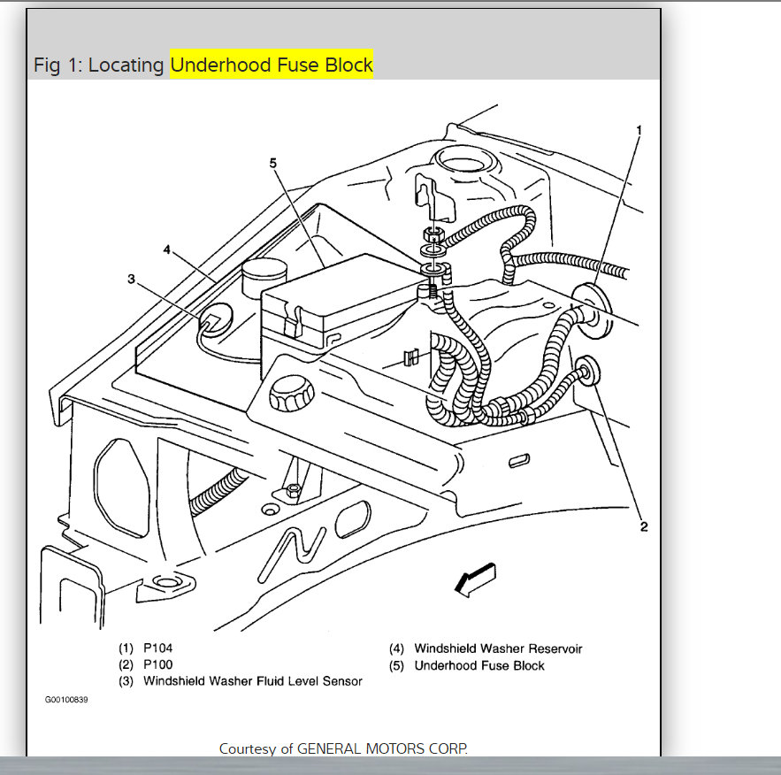

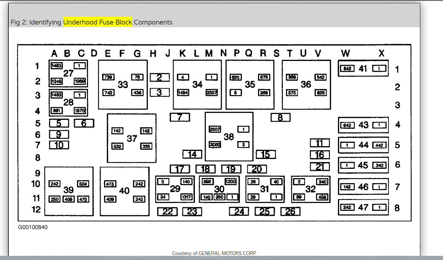

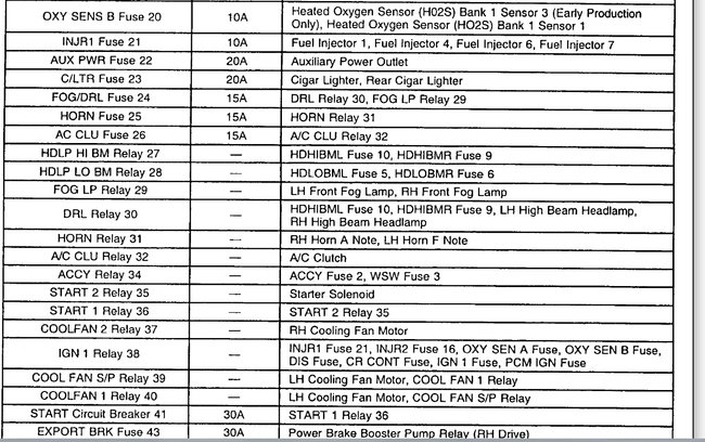

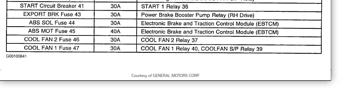

the fuse box picture you have sent is not the same configuration as mine and there is no designation of THFT 1 on my legend under the fuse box cover, nor is there one on yours either. That being said I can feel clicking and hear clicking under hood fuse box as well as the fuse box under rear seat. Would it help if I sent VIN?

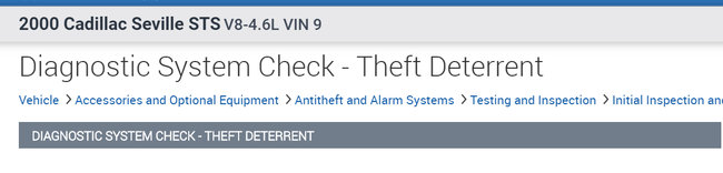

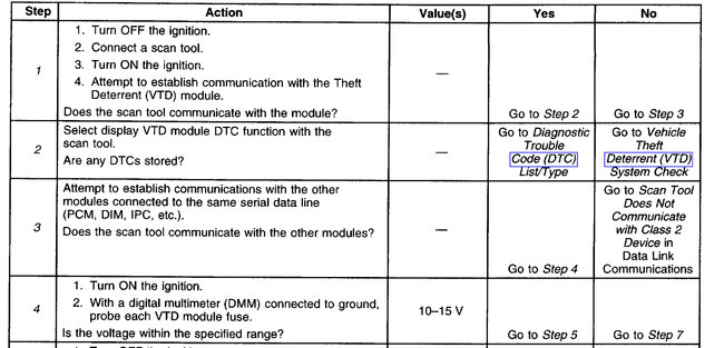

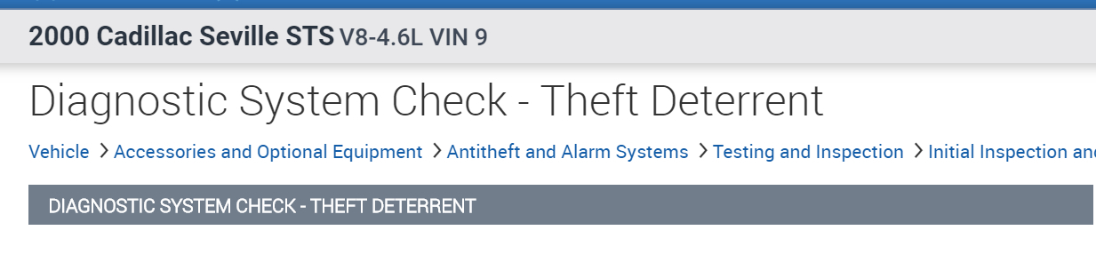

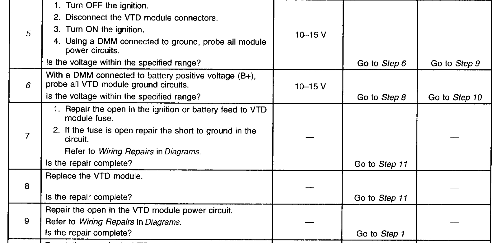

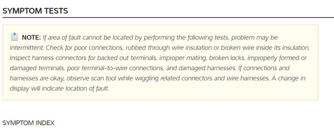

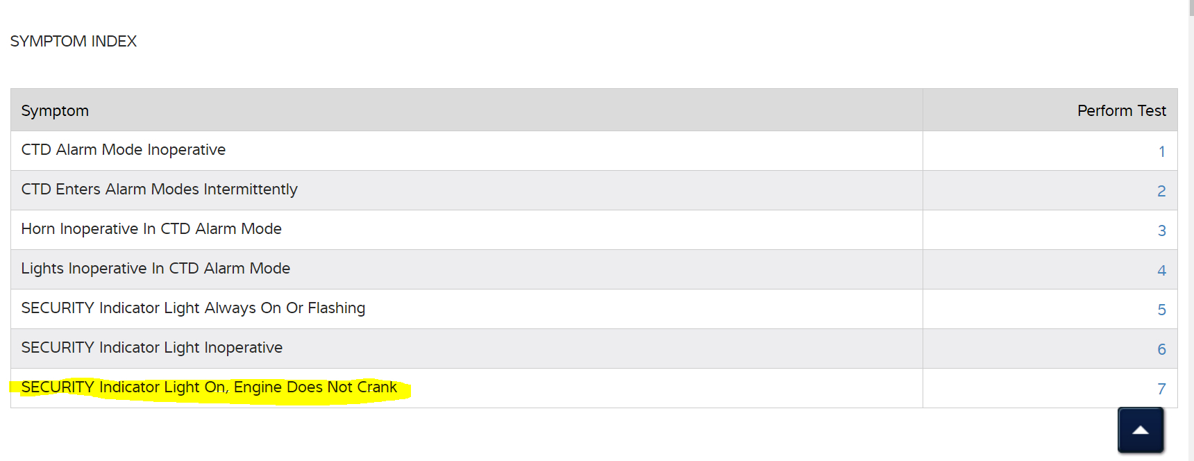

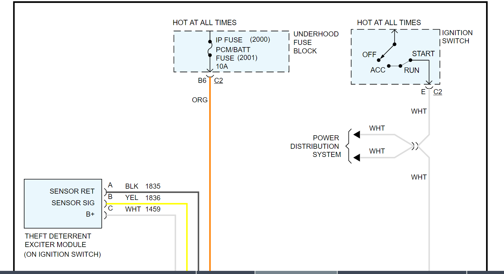

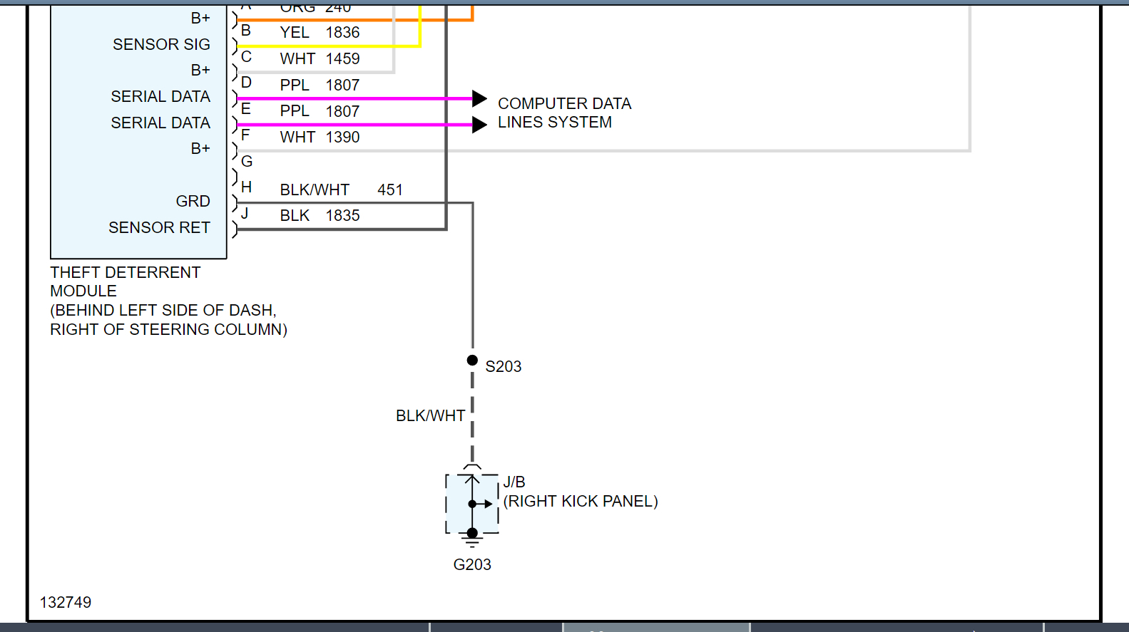

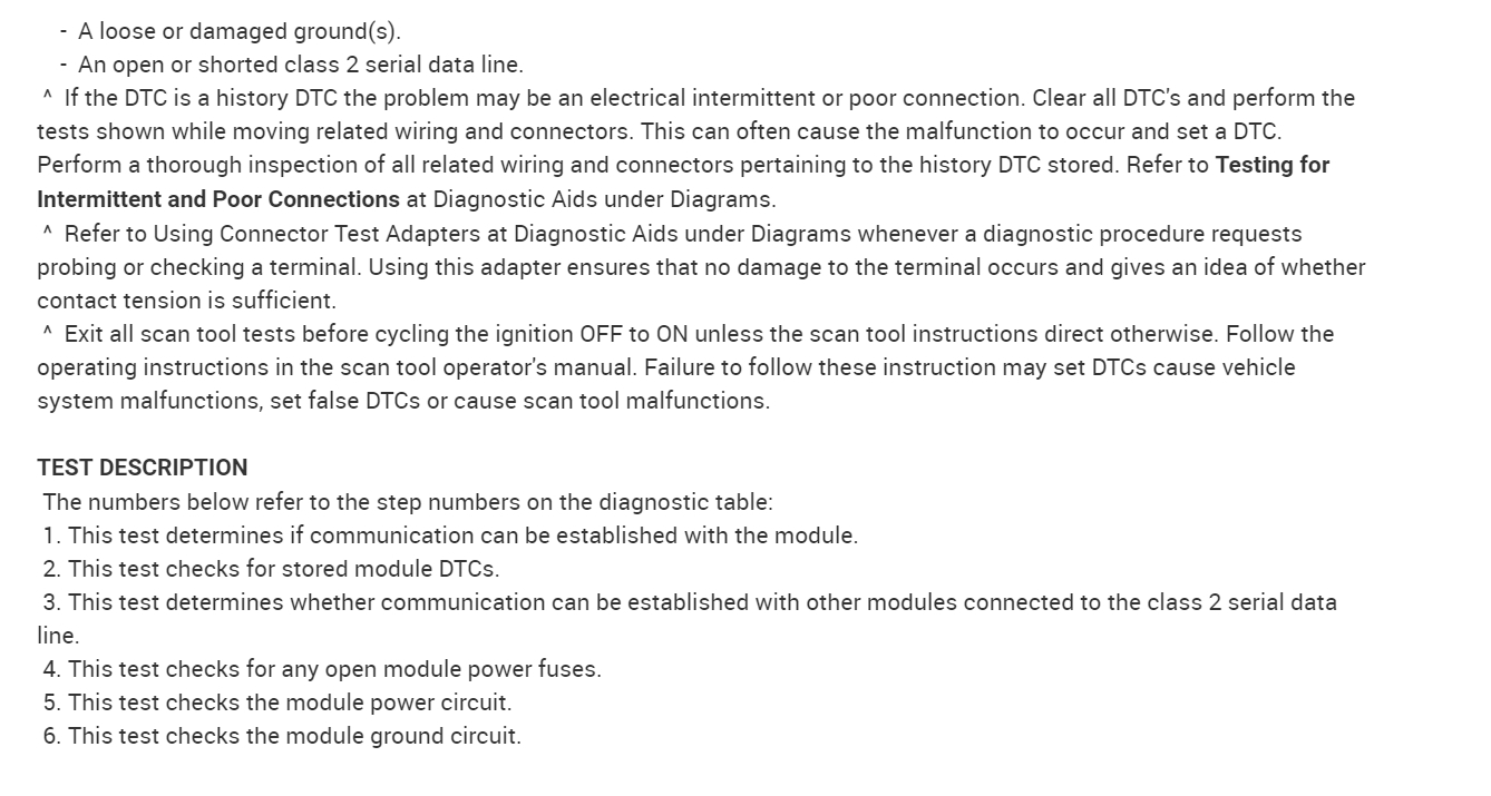

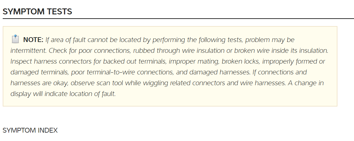

I also could not find a THFT 1 relay anywhere. I looked up a wiring diagram for your vehicle's theft deterrent system and no where on it does it have a relay on it. I have included it in the diagrams down below as well as a factory diagnostic troubleshooting guide for your vehicle's anti theft system from our other resource. Please go through this guide and get back to us with what you are able to find out.

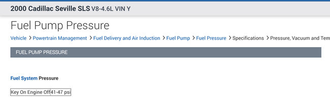

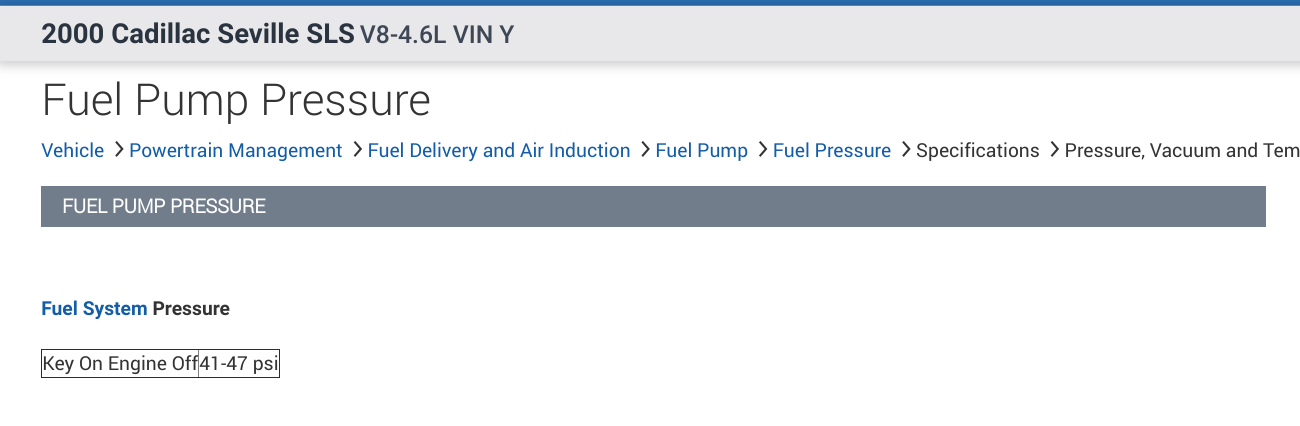

Is 40psi pressure on fuel pump check sufficient on 2000 sts.

while interesting, the question I asked was checking fuel pump with key on/no start , at the rail am getting 40 psi is this adequate for this car.

Okay, sorry about that. In the diagrams down below I have included the fuel pressure specs for your vehicle. It is just barely out of range, only a P.S.I.. I would allow that to a guage variation, but I will let you decide. Please keep us informed.

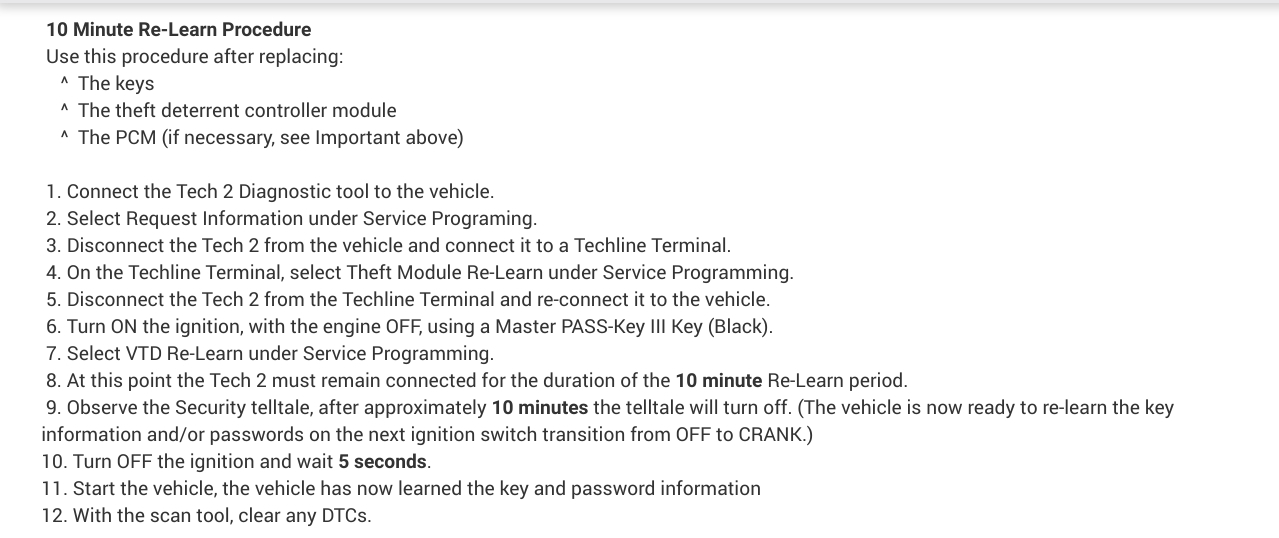

That's why I was leaning towards the immobilizer or a problem with the ignition switch itself. What did you find out when you went through the immobilizer troubleshooting guide I sent earlier?

Have tried the immobilizer technics a number of times and will try again. At present time have ignition tumbler on order, will be here wed morning.

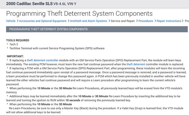

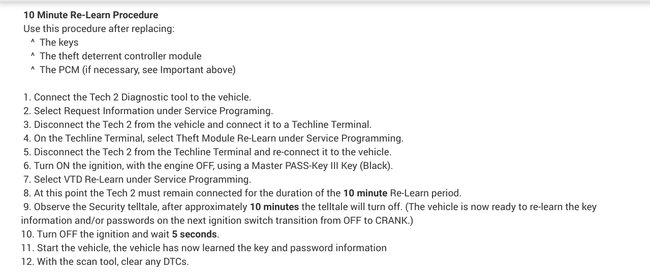

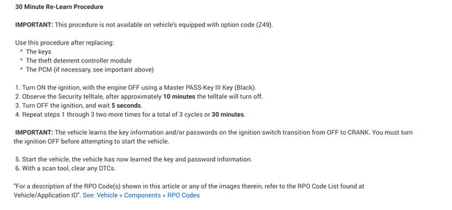

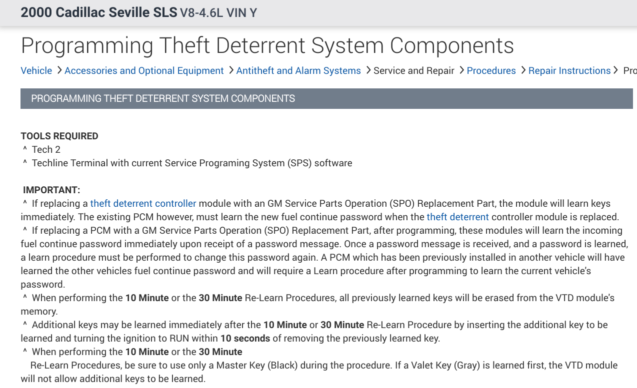

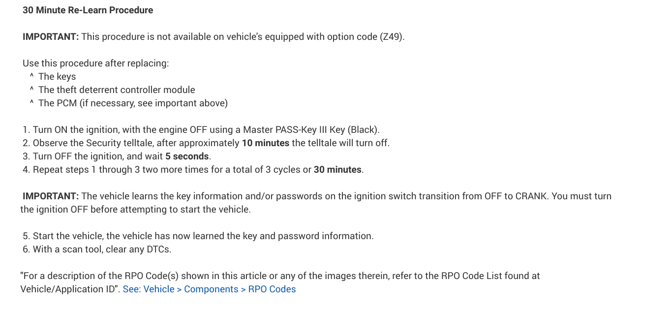

Okay, you will either have to have this equipment to program the new keys to the anti theft system in your vehicle, or have the dealership do it for you. I have included the key programming procedure for you in the diagrams down below. Please keep us informed as to how everything is progressing.

I have tried to communicate with vtd system, have 2 scanners and neither of them are tech 2 I guess, since I cannot justify 1000 up 3500 dollars gm scanners , it seems I am SOL. I did not replace key or tumbler as key turns freely and comes in and out no problem. New transponder installed on key switch and have gone thru relearn procedure for hours. Security light never truns off. Any ideas.
