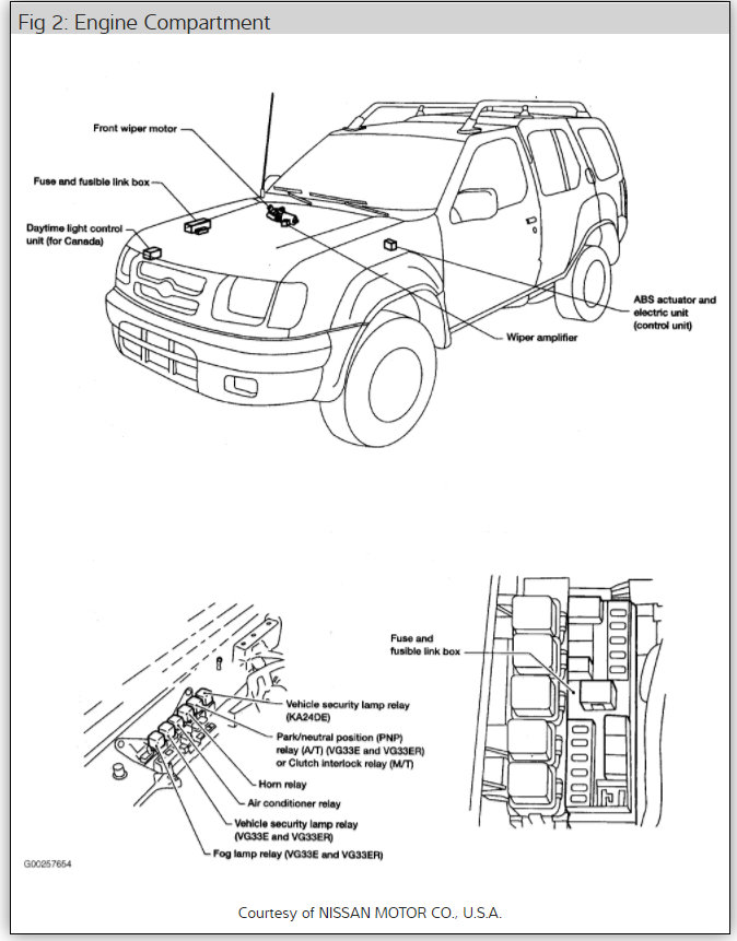

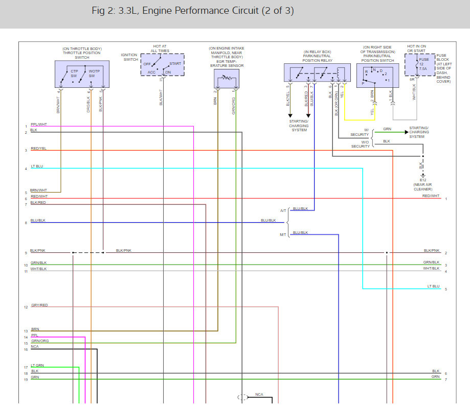

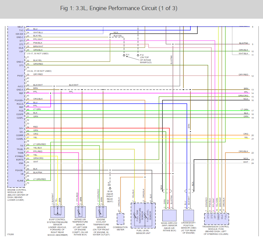

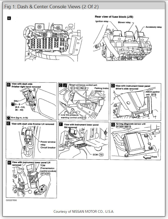

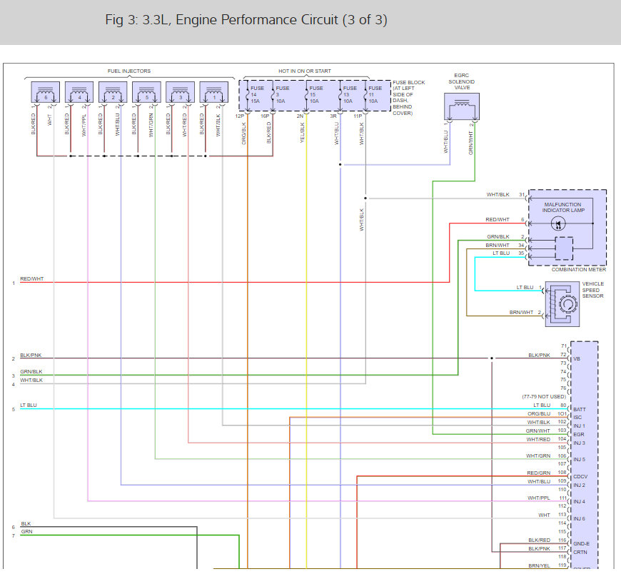

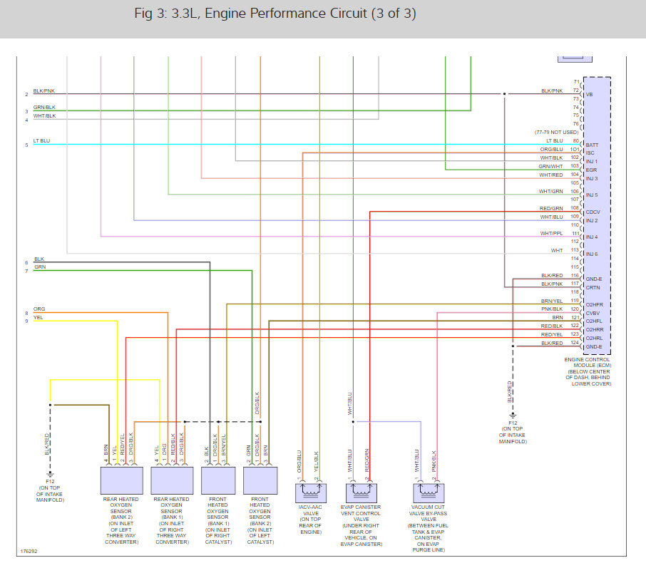

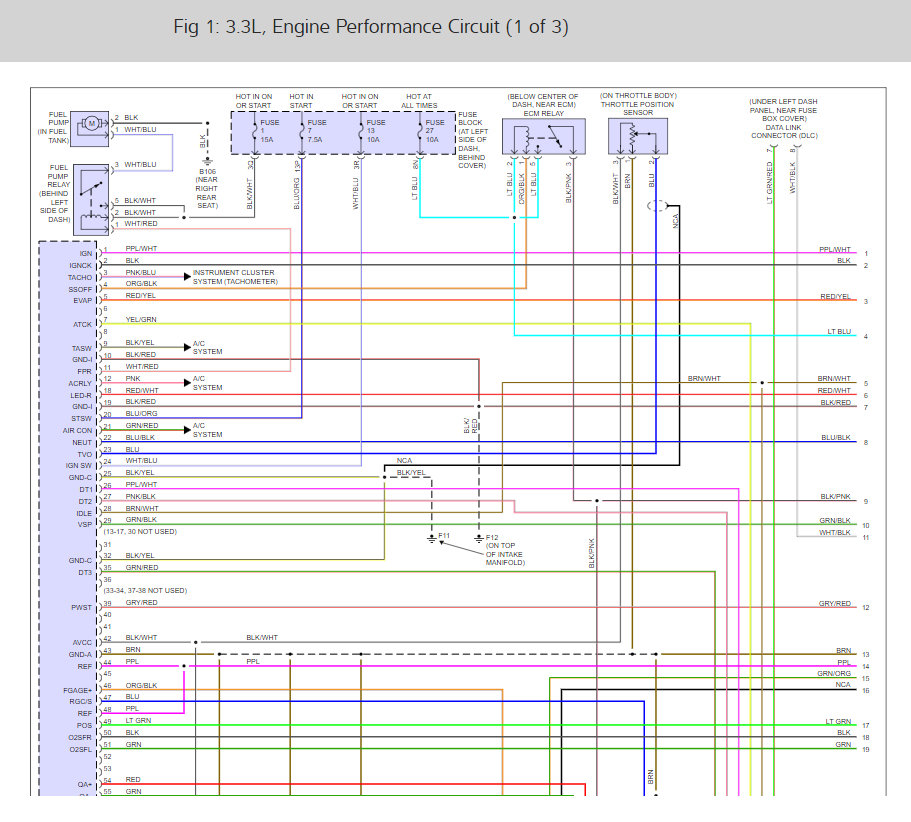

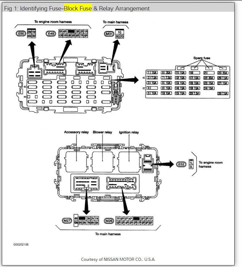

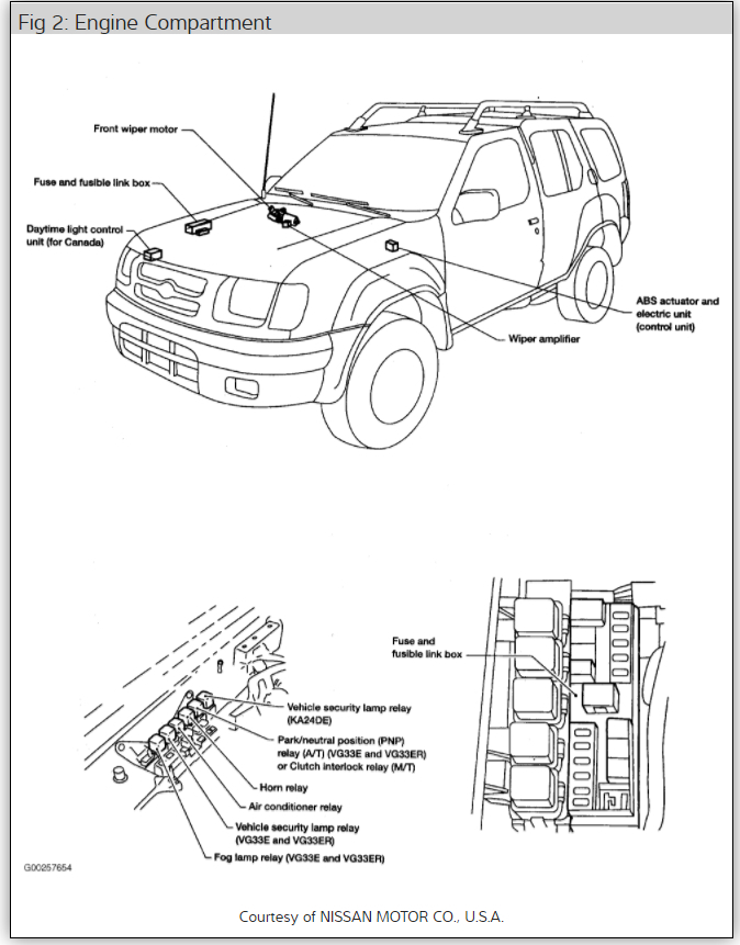

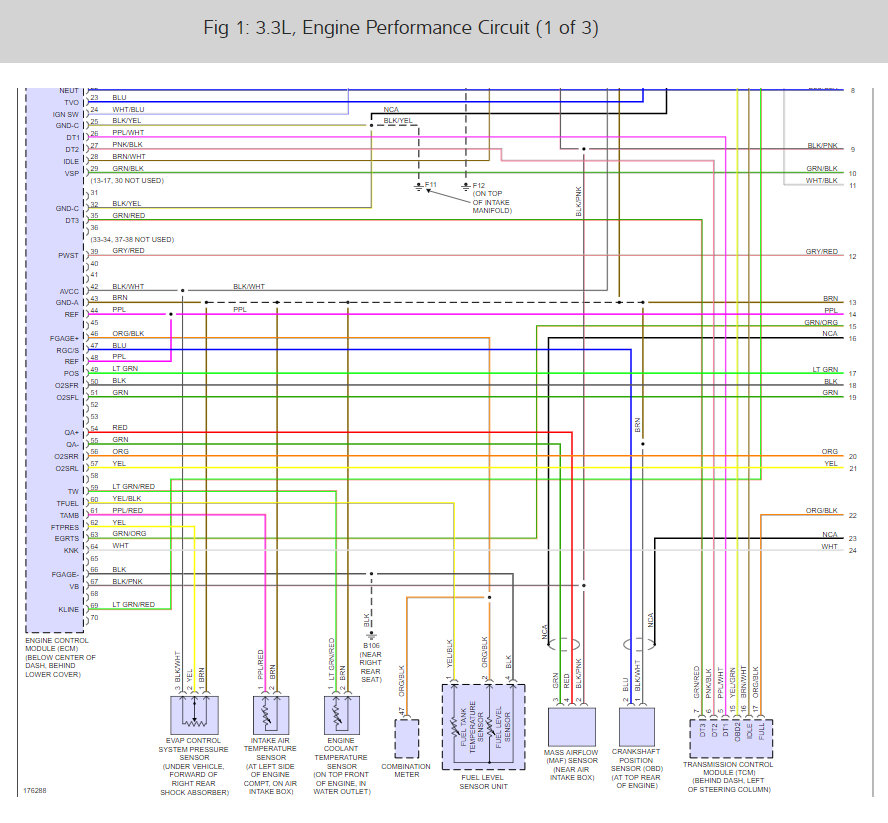

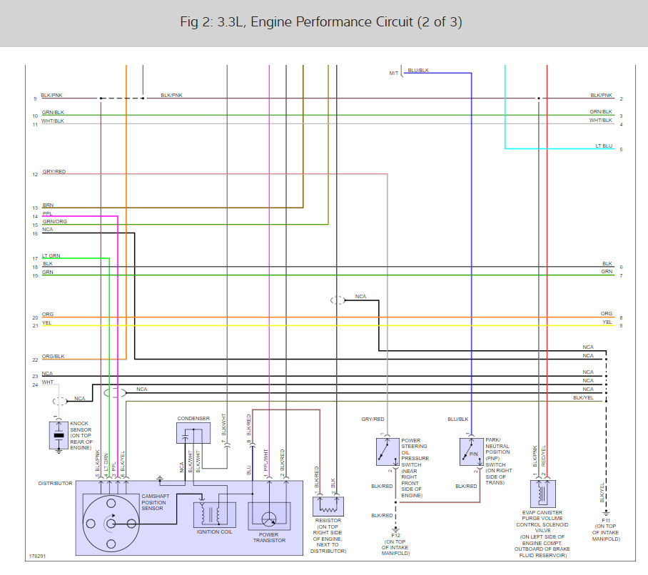

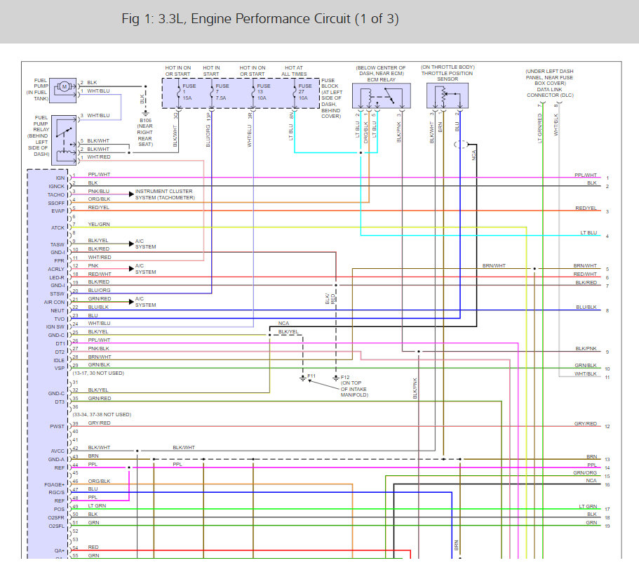

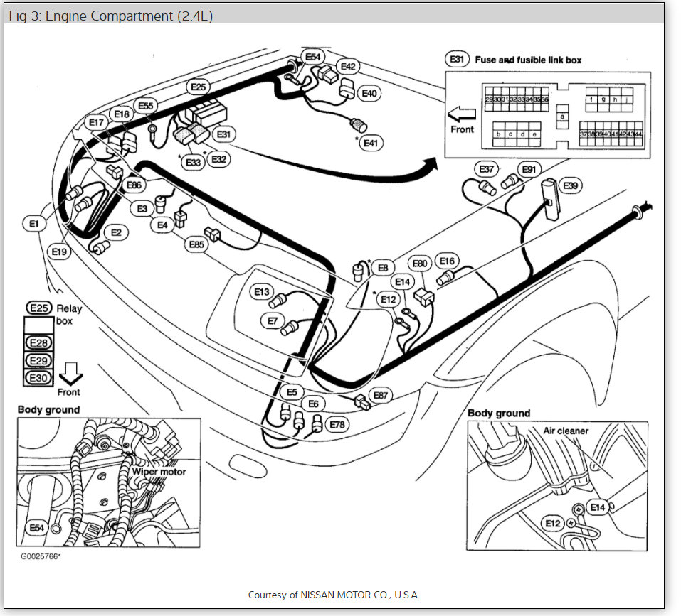

It sounds like a fuse or the ECM relay (ignition relay) is not working. Here are two guides to run down to do some testing and the location of the ECM relay and fuses that run the system. I have also included the engine wiring diagrams so you can see how the system works.
and
Check out the diagrams (below). Please run this test and get back to us.
Sep 8, 2018 at 12:35 PM

Both the fuses and relay all seem to be in working order. I am unsure if I managed to get TDC properly before replacing the distributor. What is the best way of getting that on my model?
