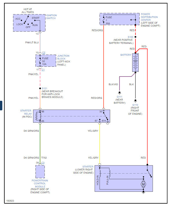

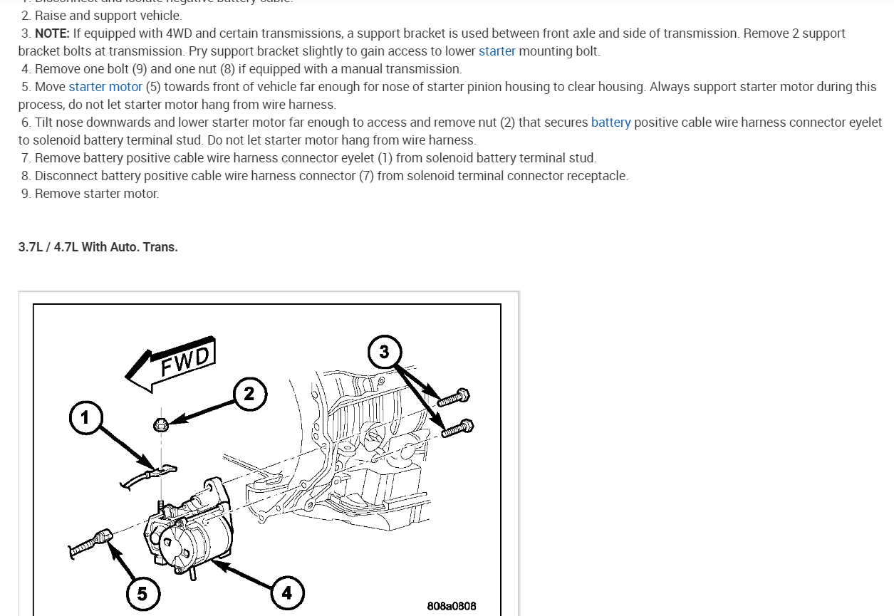

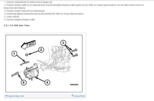

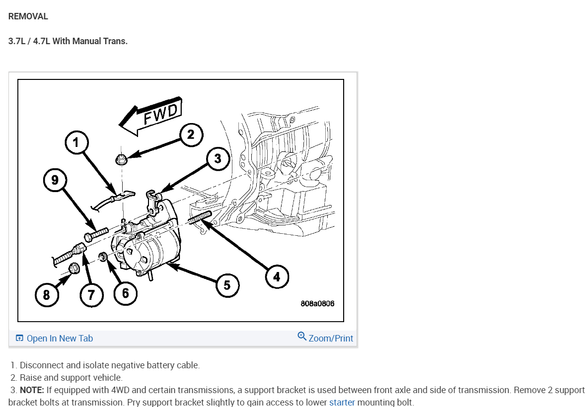

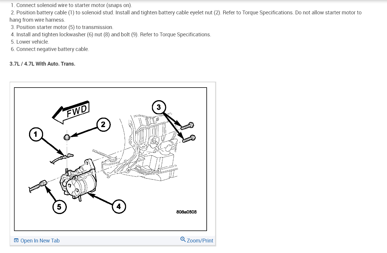

It sounds like the rebuilt starter has gone bad. To be sure let's use a test light and while a helper is holding the ignition key in the start position see if there is power at the starter trigger wire.

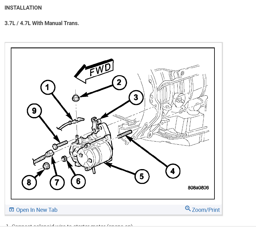

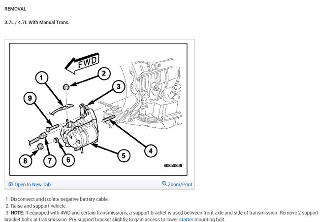

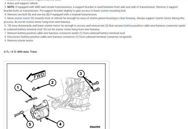

This guide can help:
Here is how to change the starter out in case you need it and I have included the starter wiring diagrams so you can see how the system works. Also check fuse #32 in the left kick panel fuse block. Check out the images (below). Please let us know what you find. We are interested to see what it is.

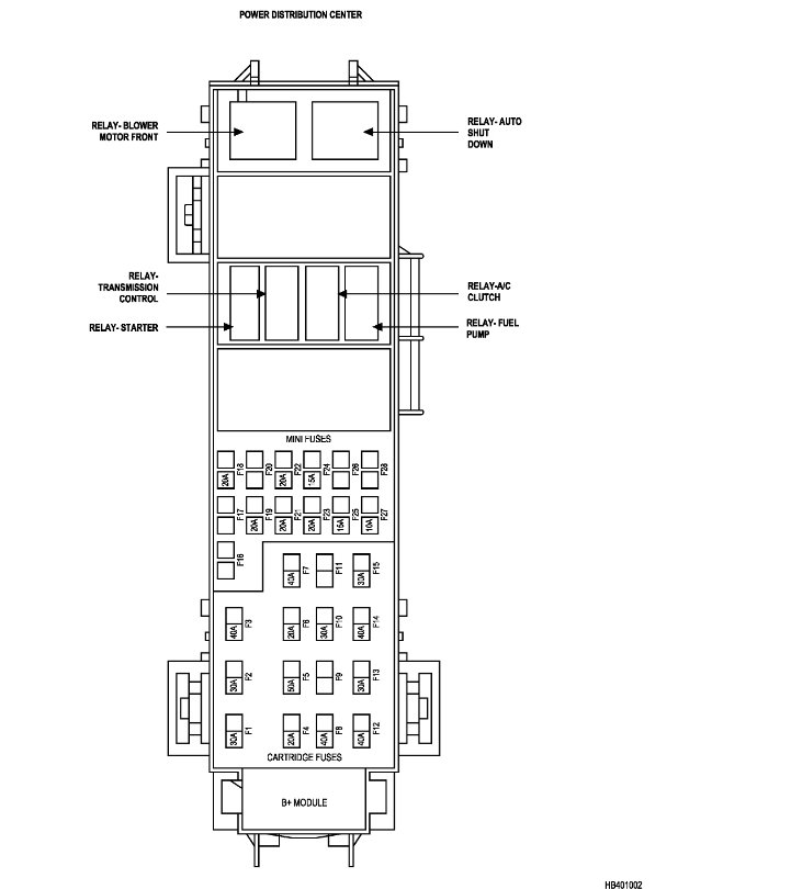

Okay, let's check the starter relay, here is the location and a guide on how to test it, or you can just swap it out, also try to crank the engine when the transmission is in neutral to see if that changes anything.
