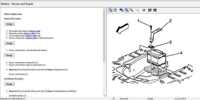

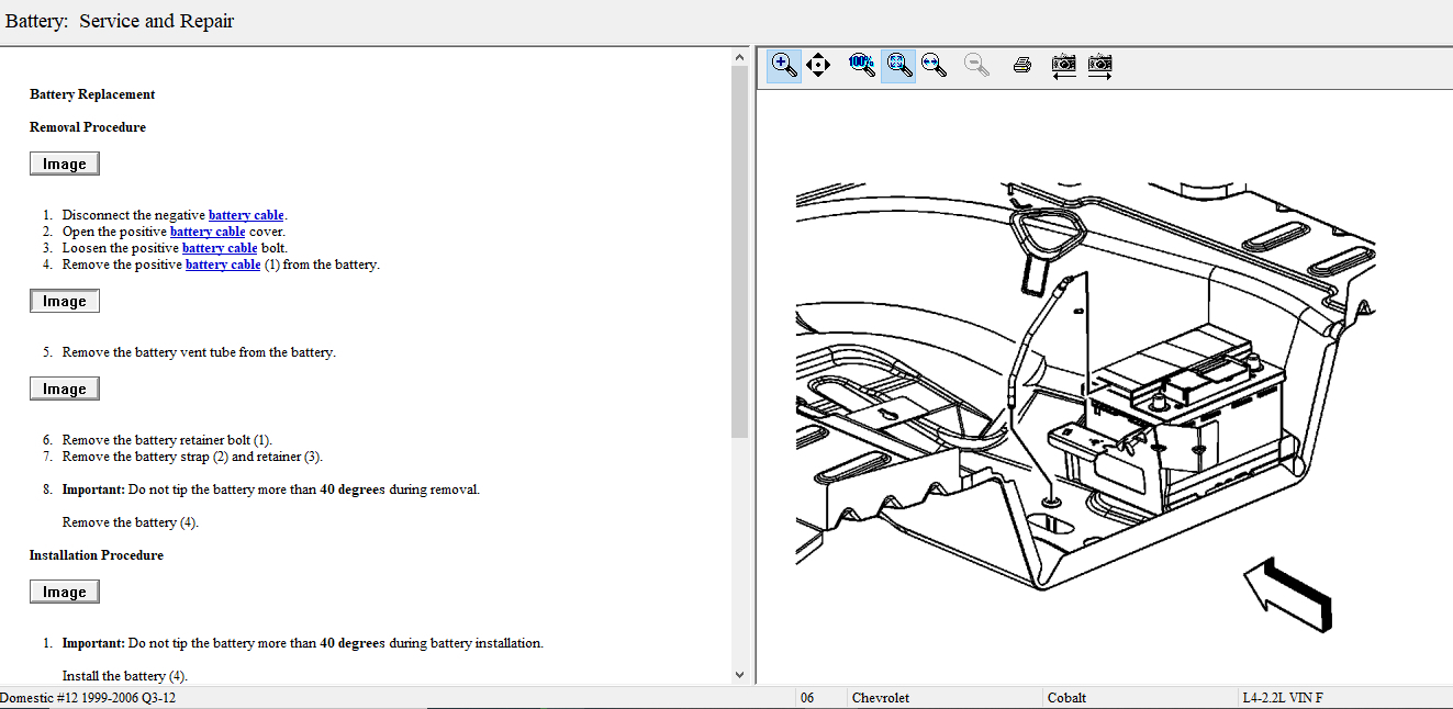

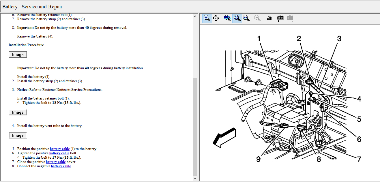

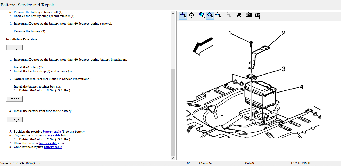

It sounds like your battery is drained. also check the battery connections positive and negative poles if they are tight and clean.
check our link below how to replace battery and to charge it.
https://www.2carpros.com/articles/how-to-charge-your-car-battery
https://www.2carpros.com/articles/how-to-replace-a-car-battery

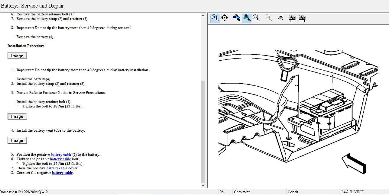

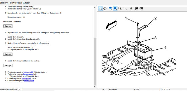

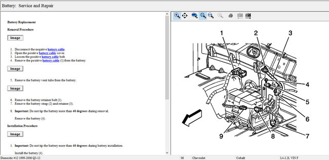

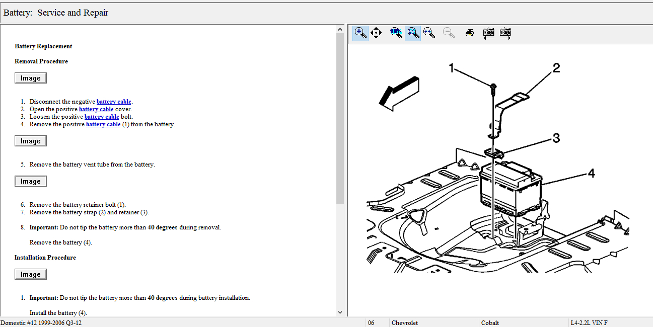

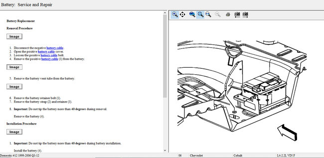

Check the diagrams below how to replace battery.
hope these helps, let us know if you need more help.
