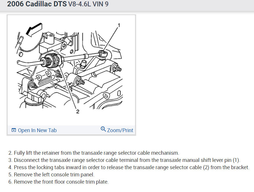

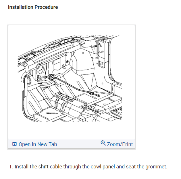

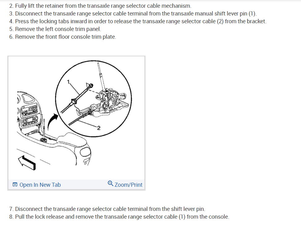

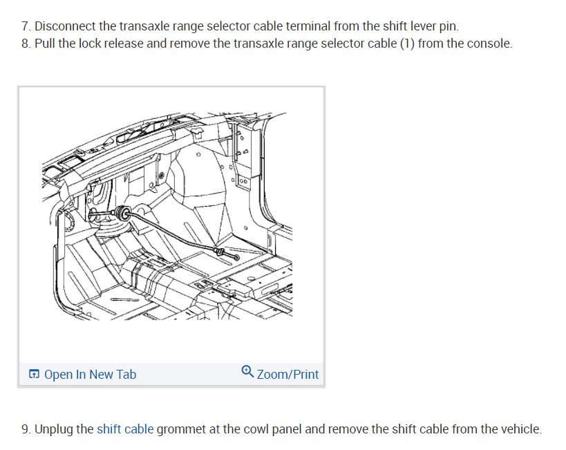

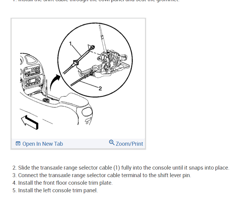

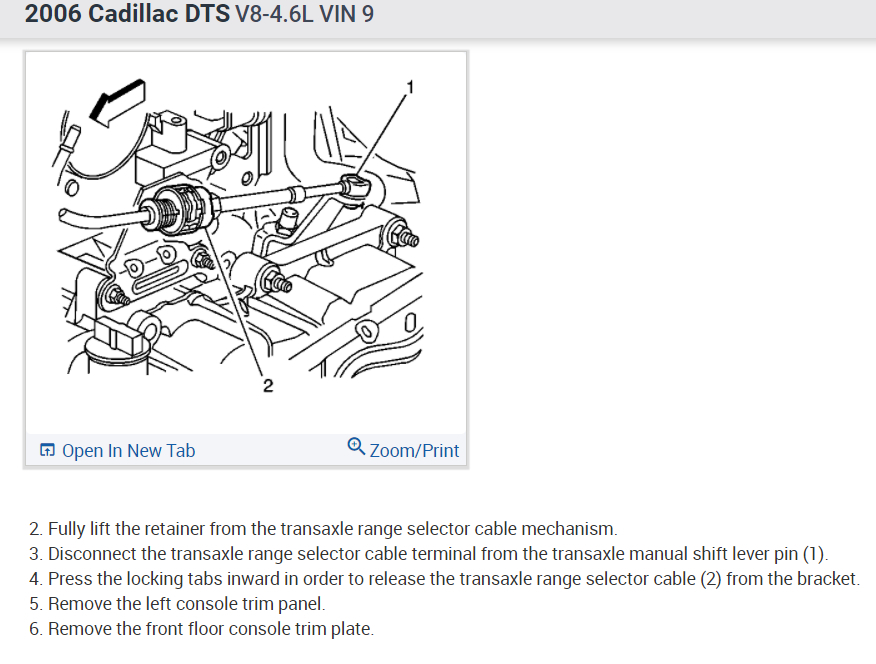

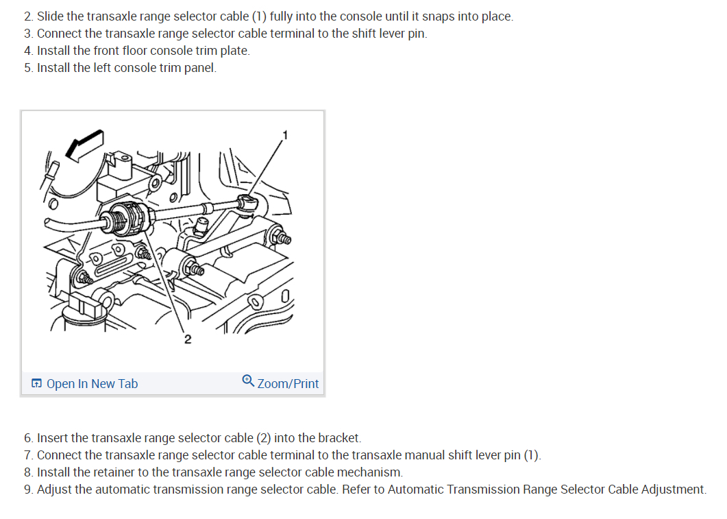

These codes wont make the engine not crank over but these cars have a problem with the sifter rod. Here is how you can fix it. Check out the diagrams (below). Please let us know what happens. This guide can help too:
https://www.2carpros.com/articles/starter-not-working-repair
Mar 1, 2021 at 2:04 PM

The shifter cable is working fine transaxle is in park.
