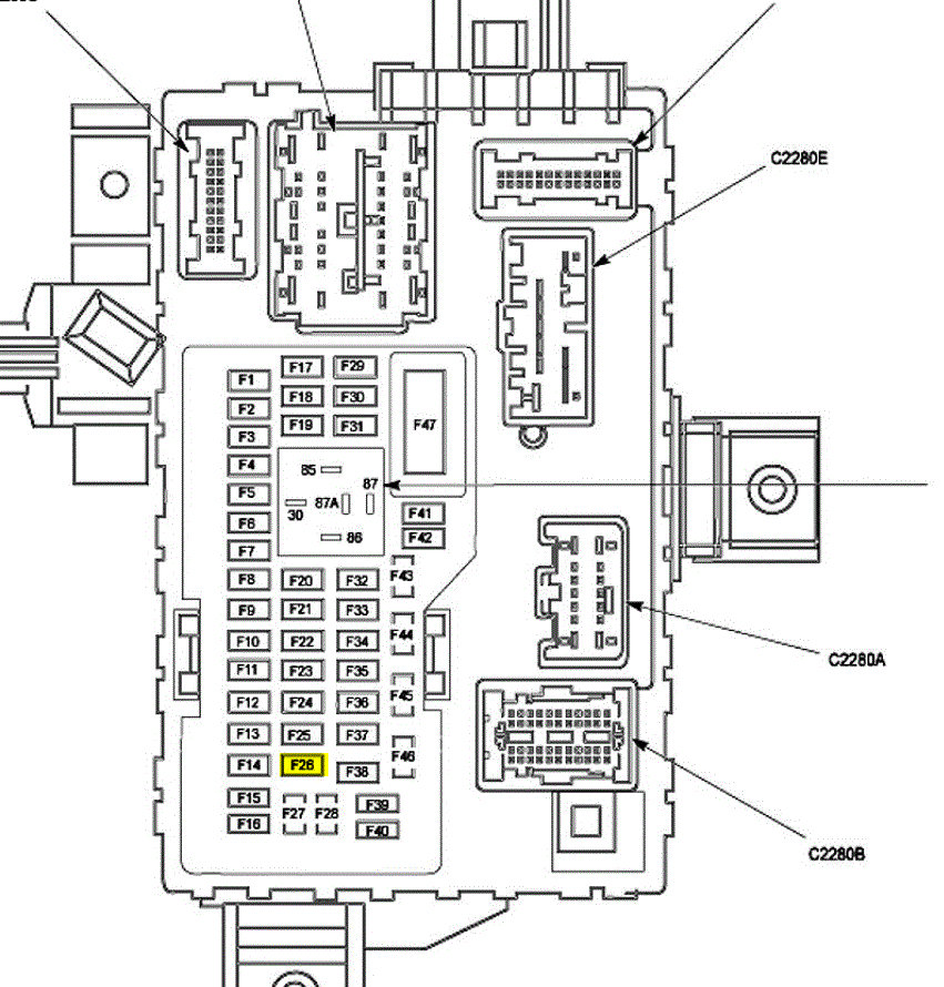

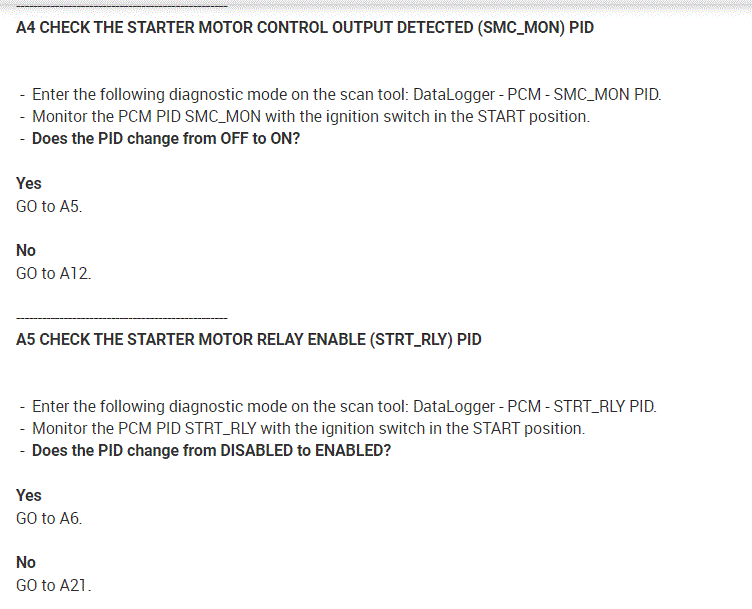

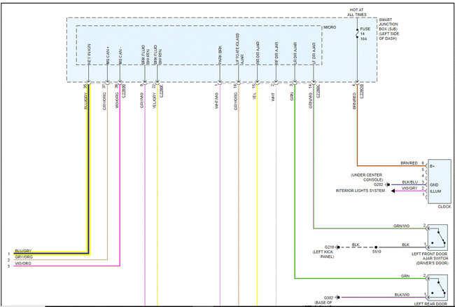

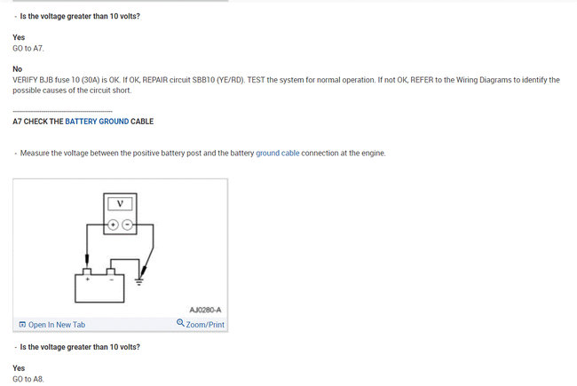

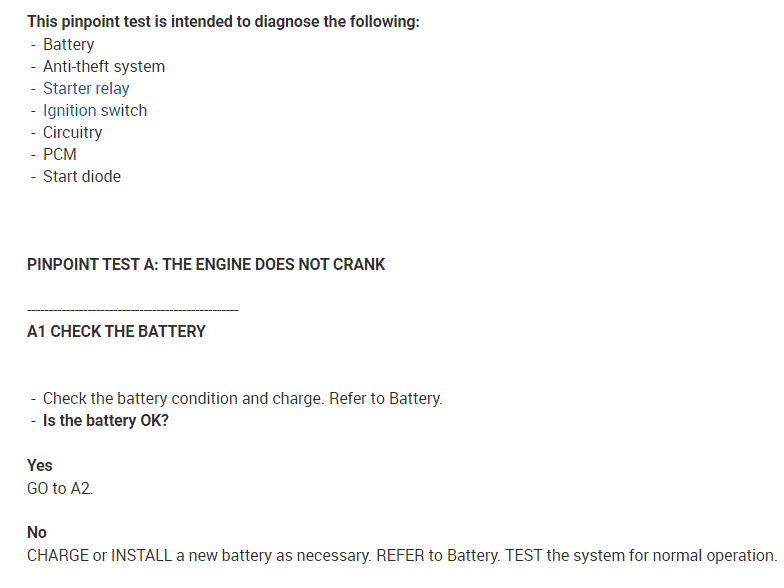

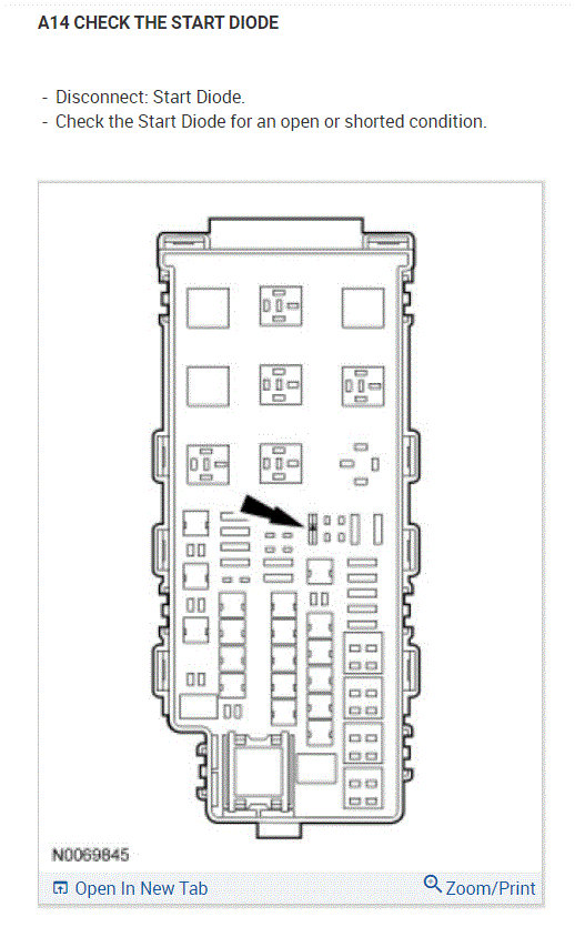

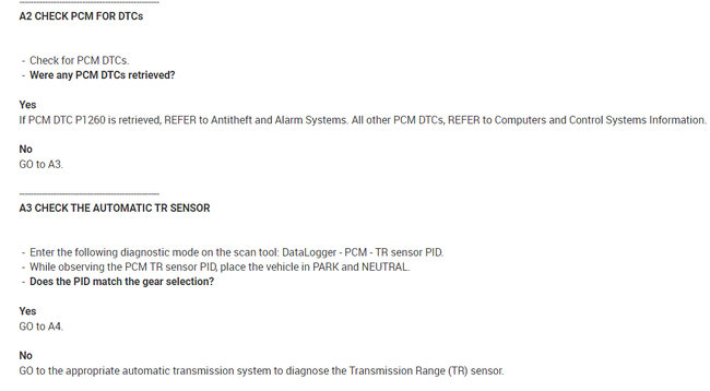

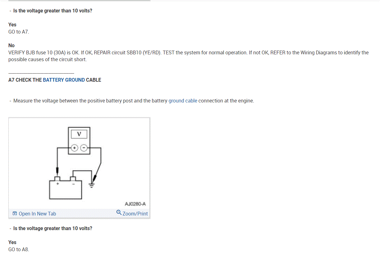

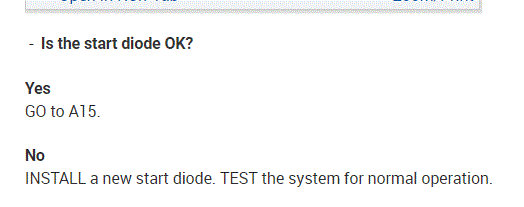

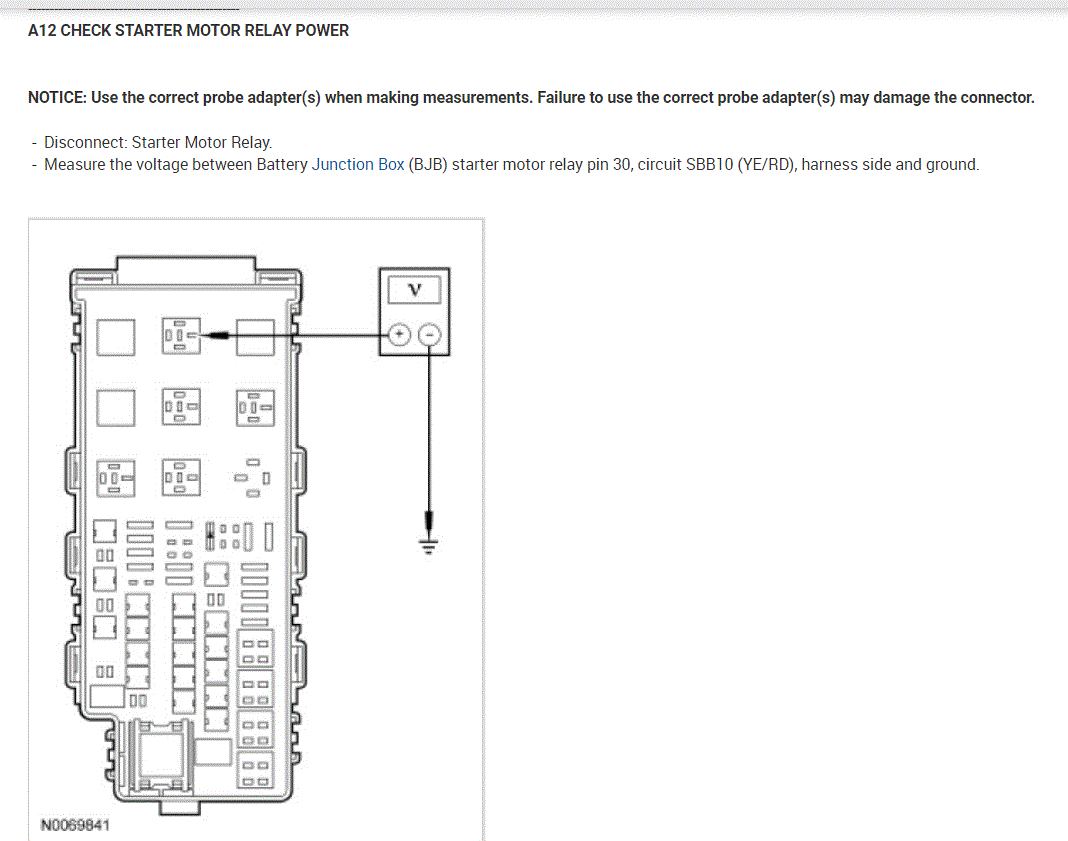

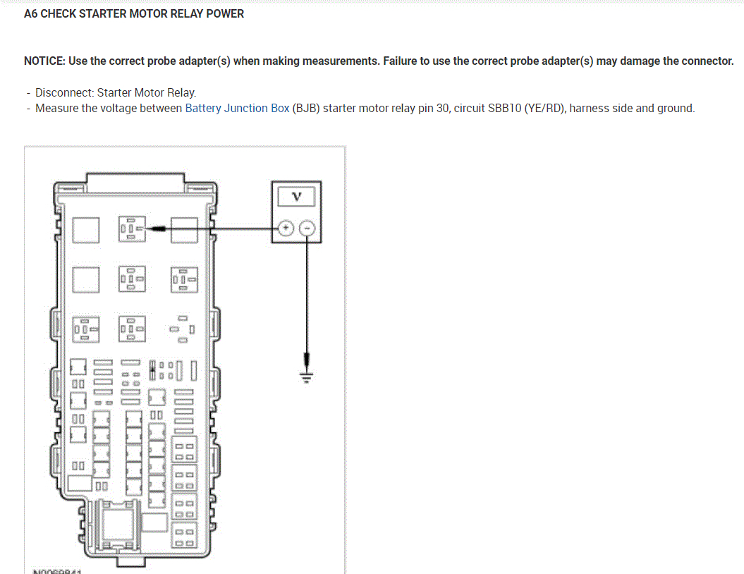

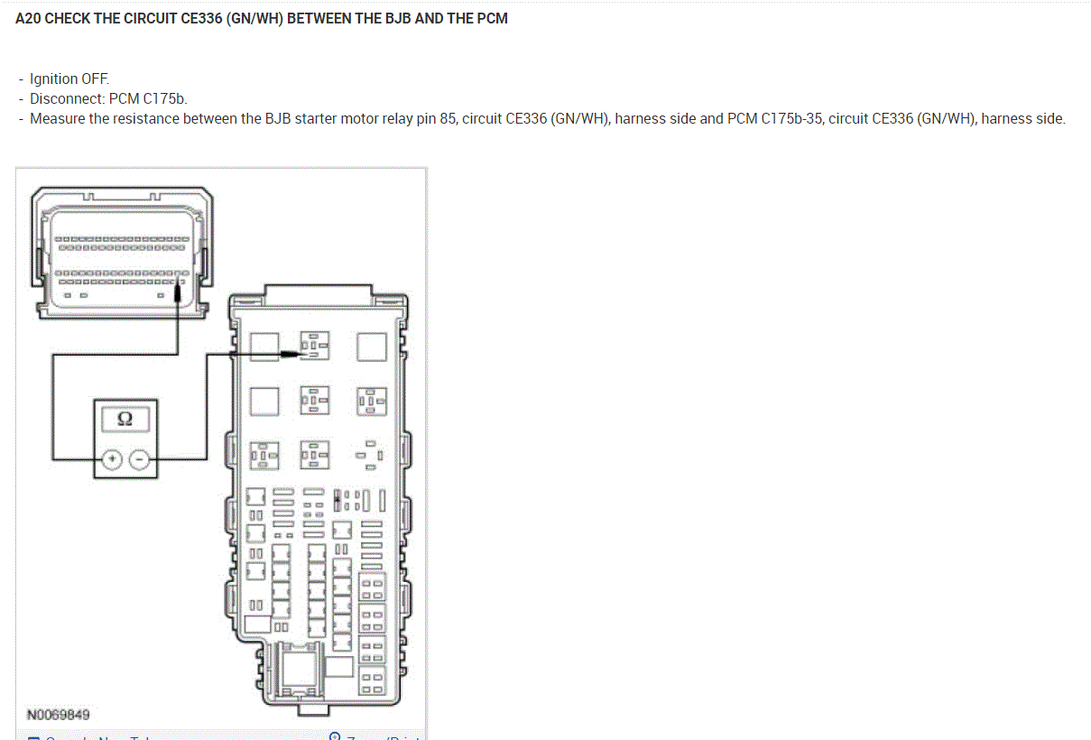

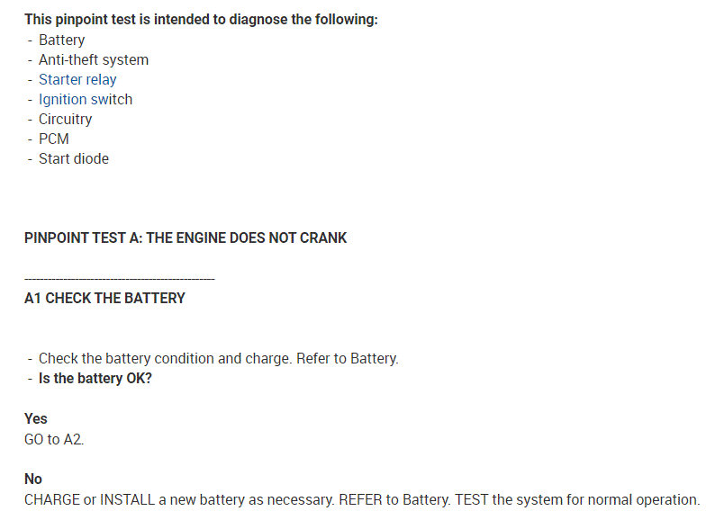

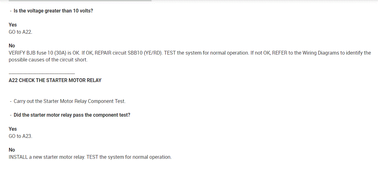

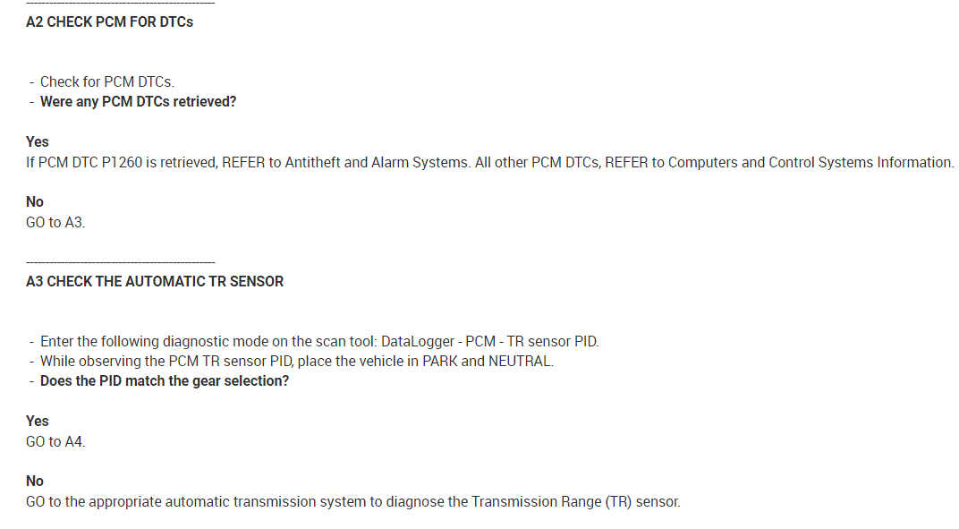

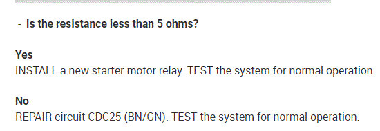

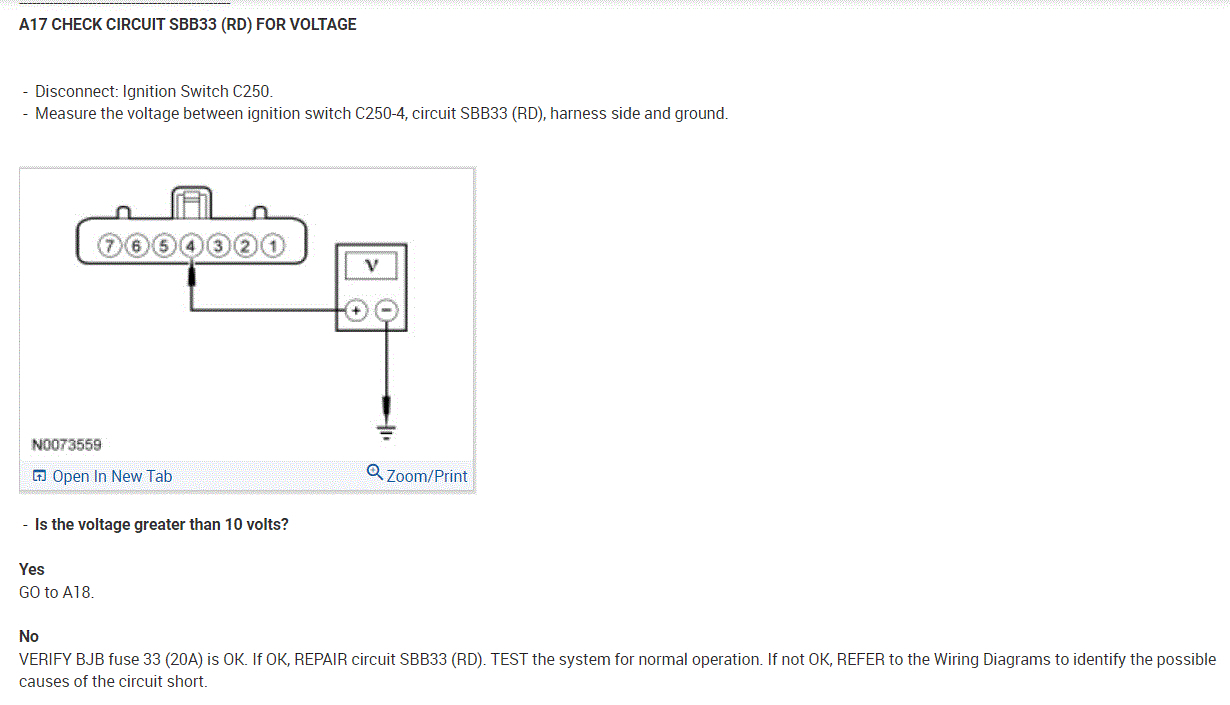

Yesterday I decided to do a deep clean. I removed the front seats and cleaned everything. I was careful not to break or get connectors wet. Today I put the seats in and went to start it. The radio and lights turn on but it doesn’t crank. I tried to jump start it and that didn’t help. The gauge cluster does nothing. Not even odometer. The air bag light flashes for a second but that’s it. I have no clue where to go next. Thank you in advance.
