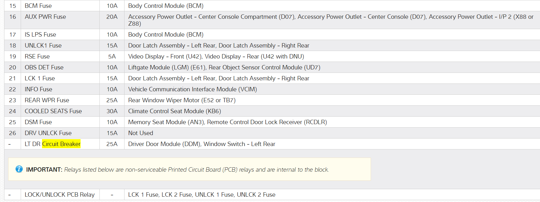

Do you have flashing security light on the dash when you try and crank it over? If so then the security system has been activated which can happen when the voltage drops to low for the system. Can you use the remote and lock and then unlock the doors?

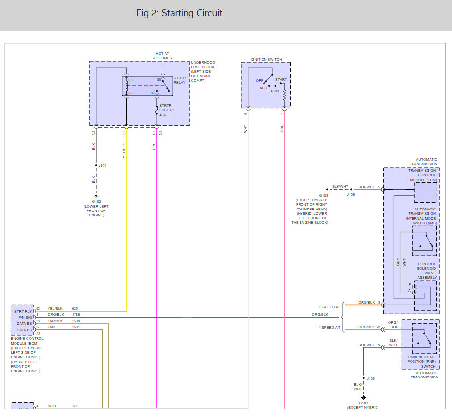

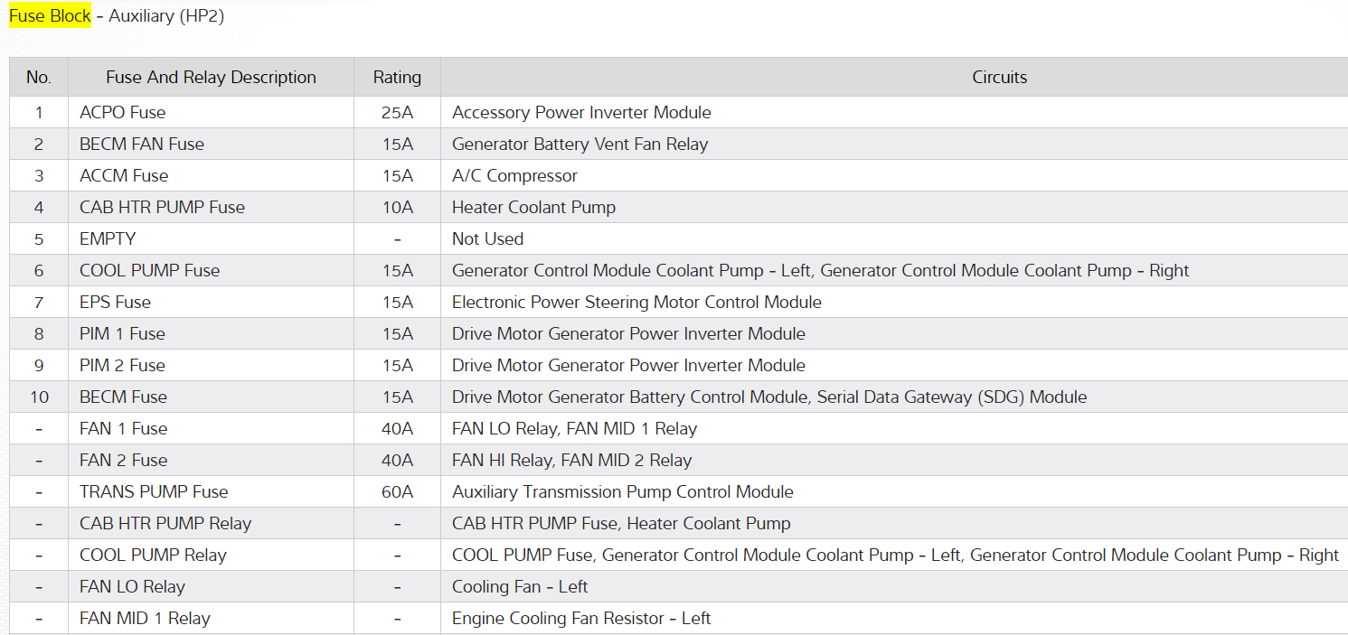

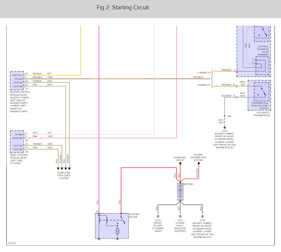

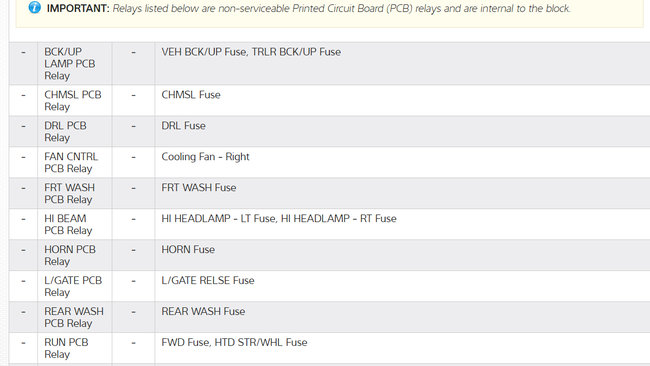

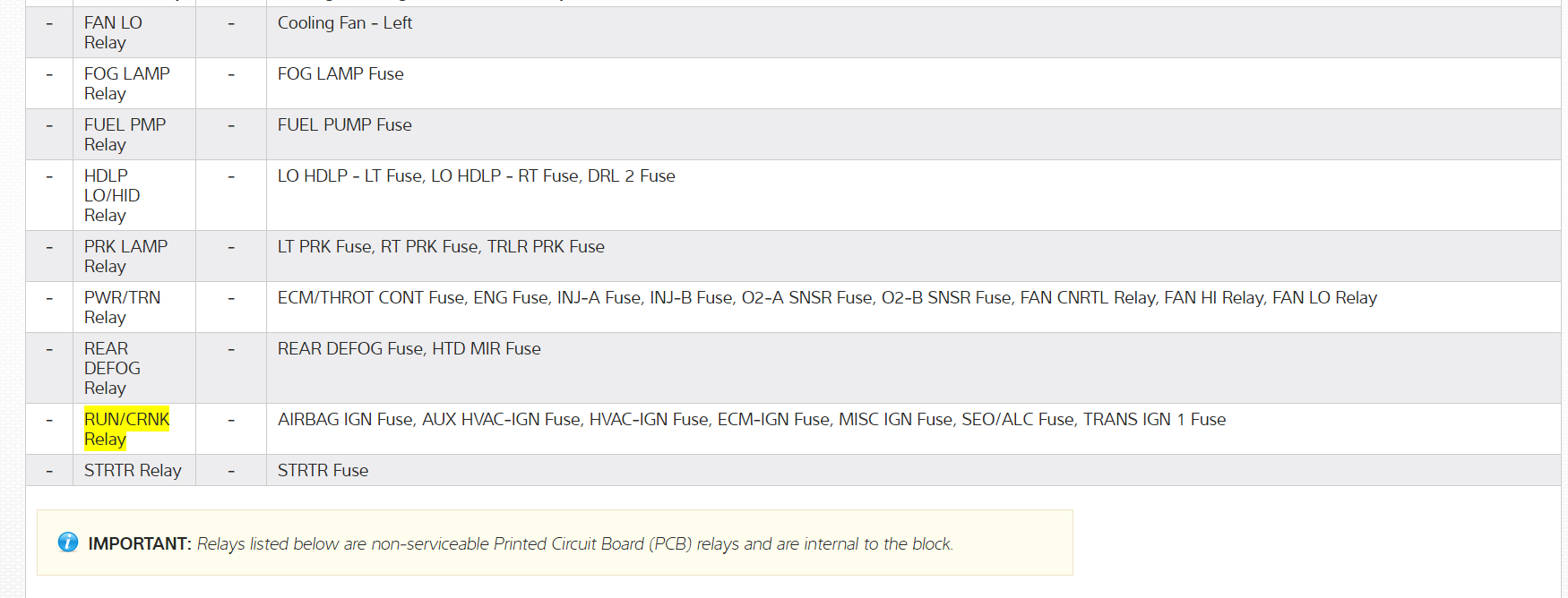

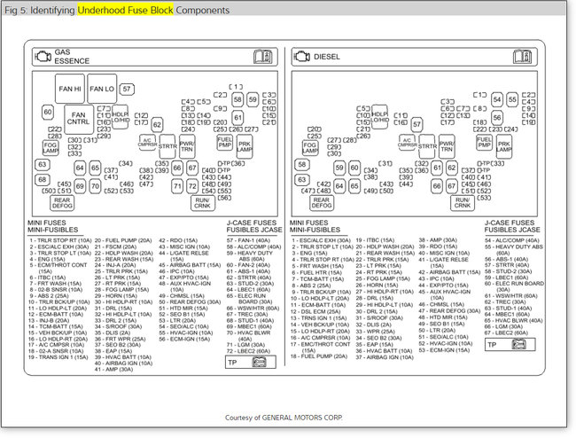

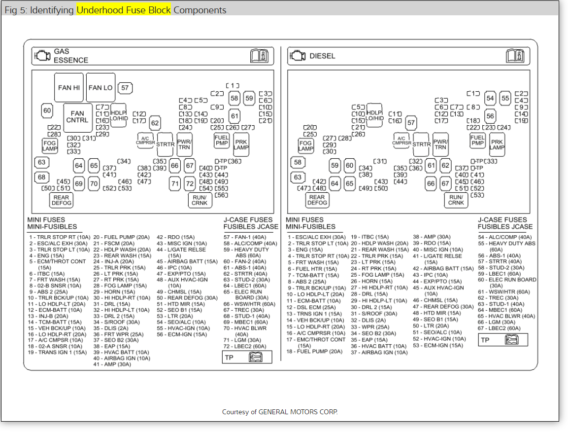

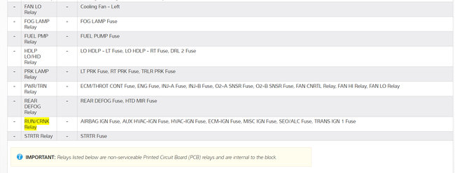

Here is a guide to help us see how the starter is wired so we can be on the same page. Also, there is a starter relay that could be out as well.
Here is a guide to help us confirm the failure:

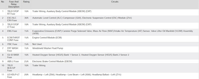

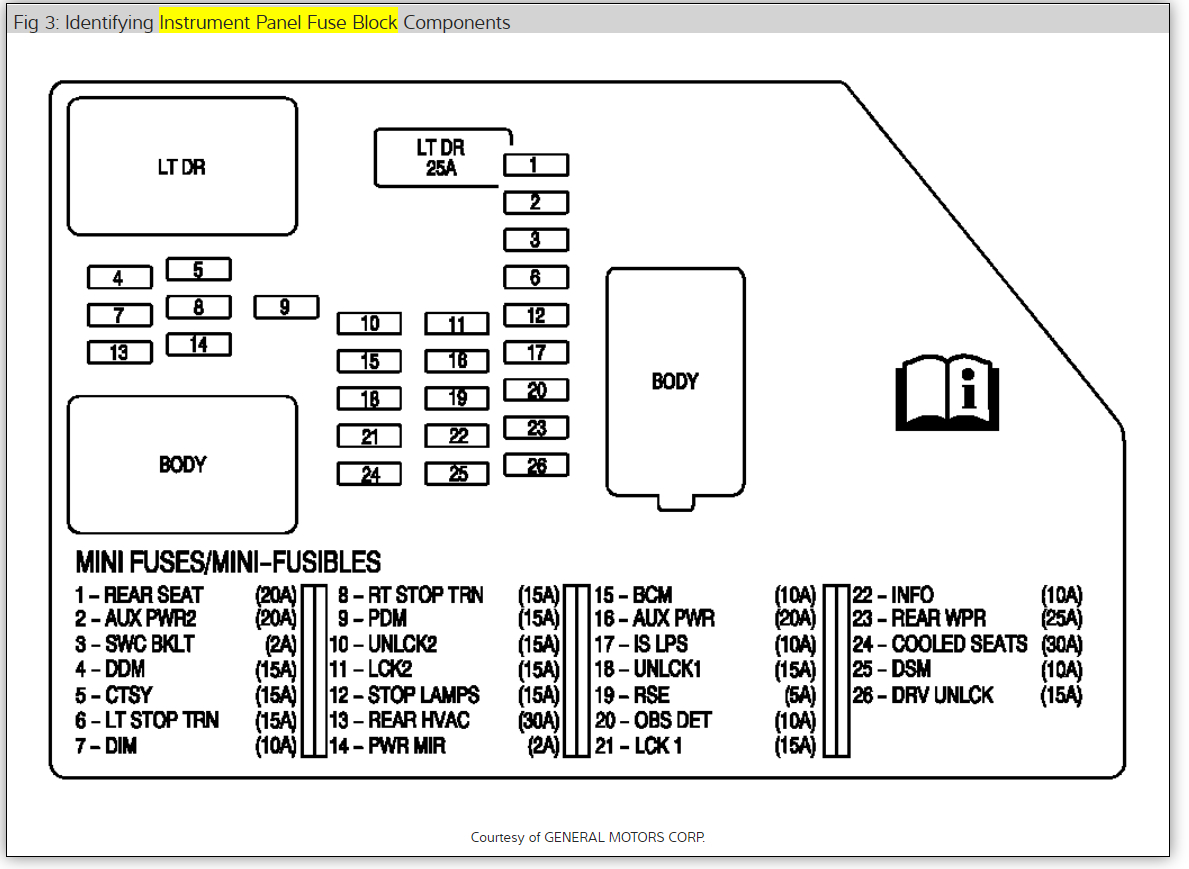

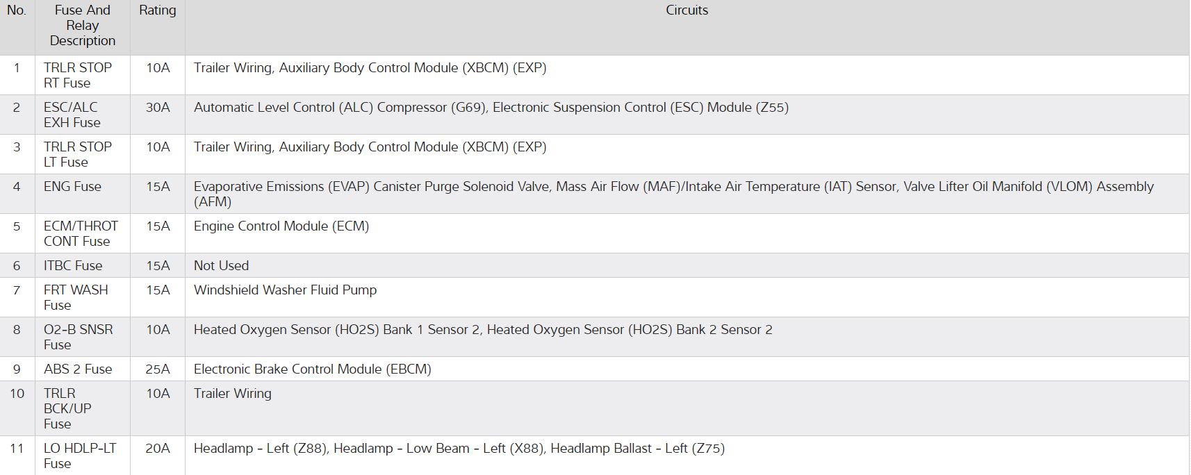

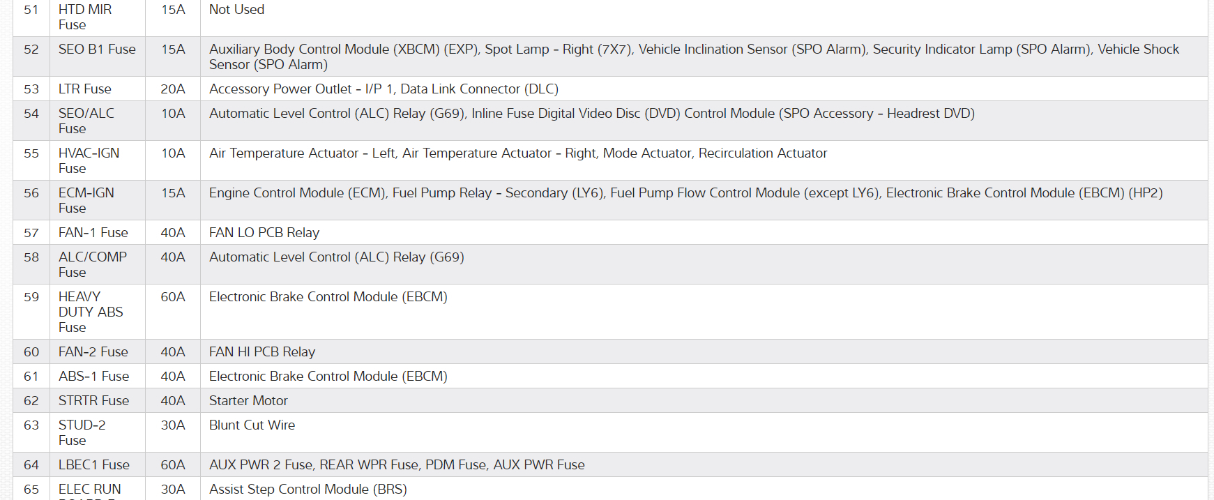

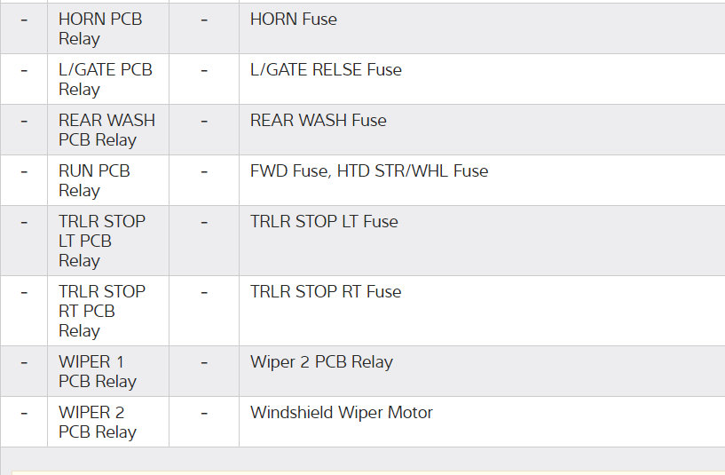

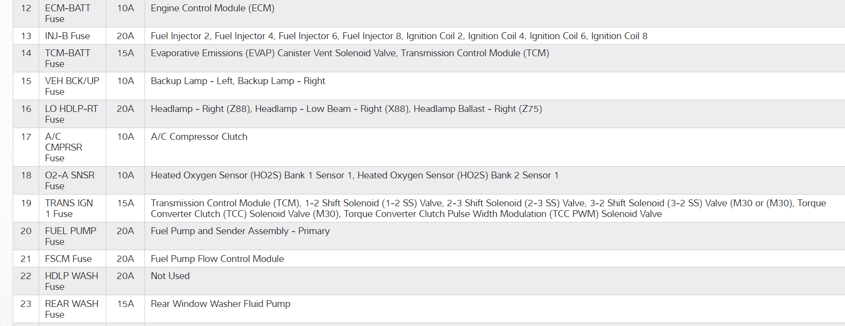

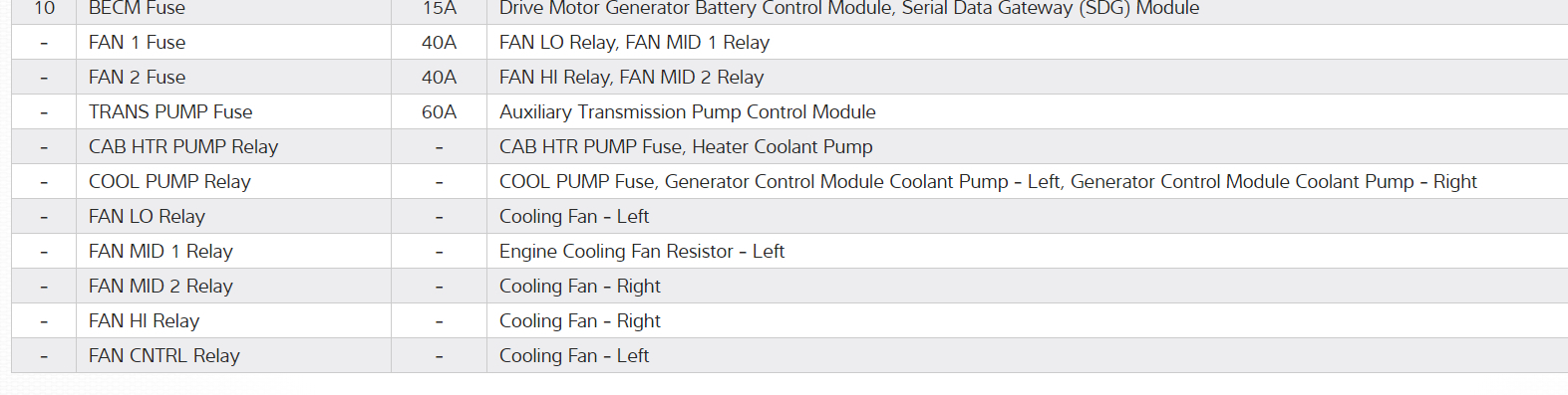

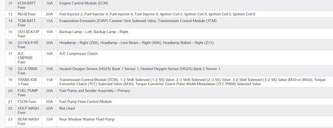

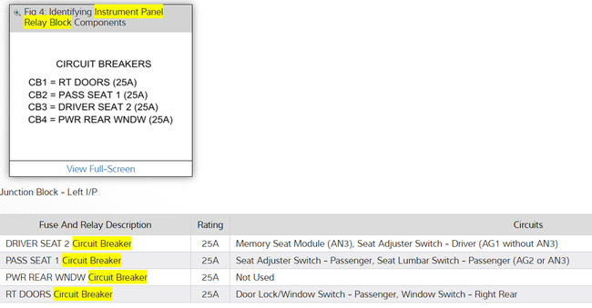

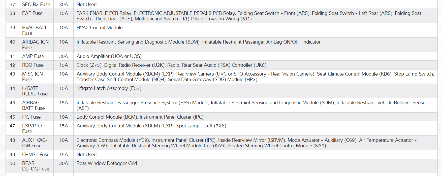

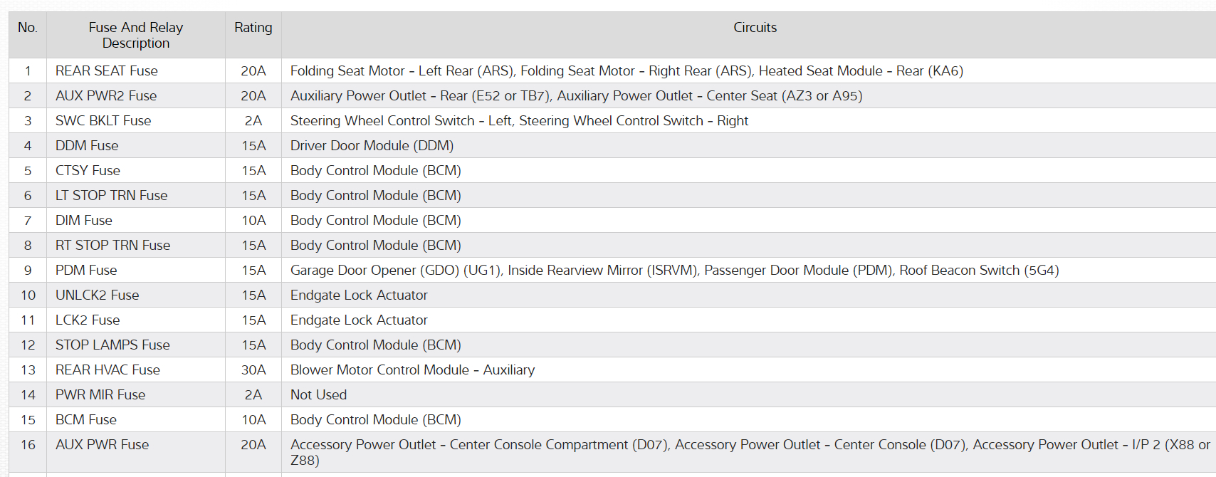

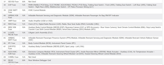

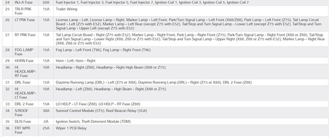

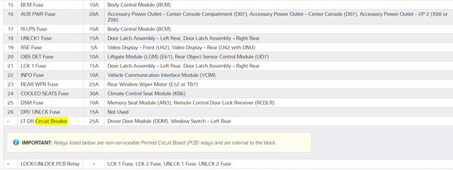

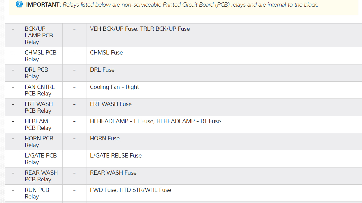

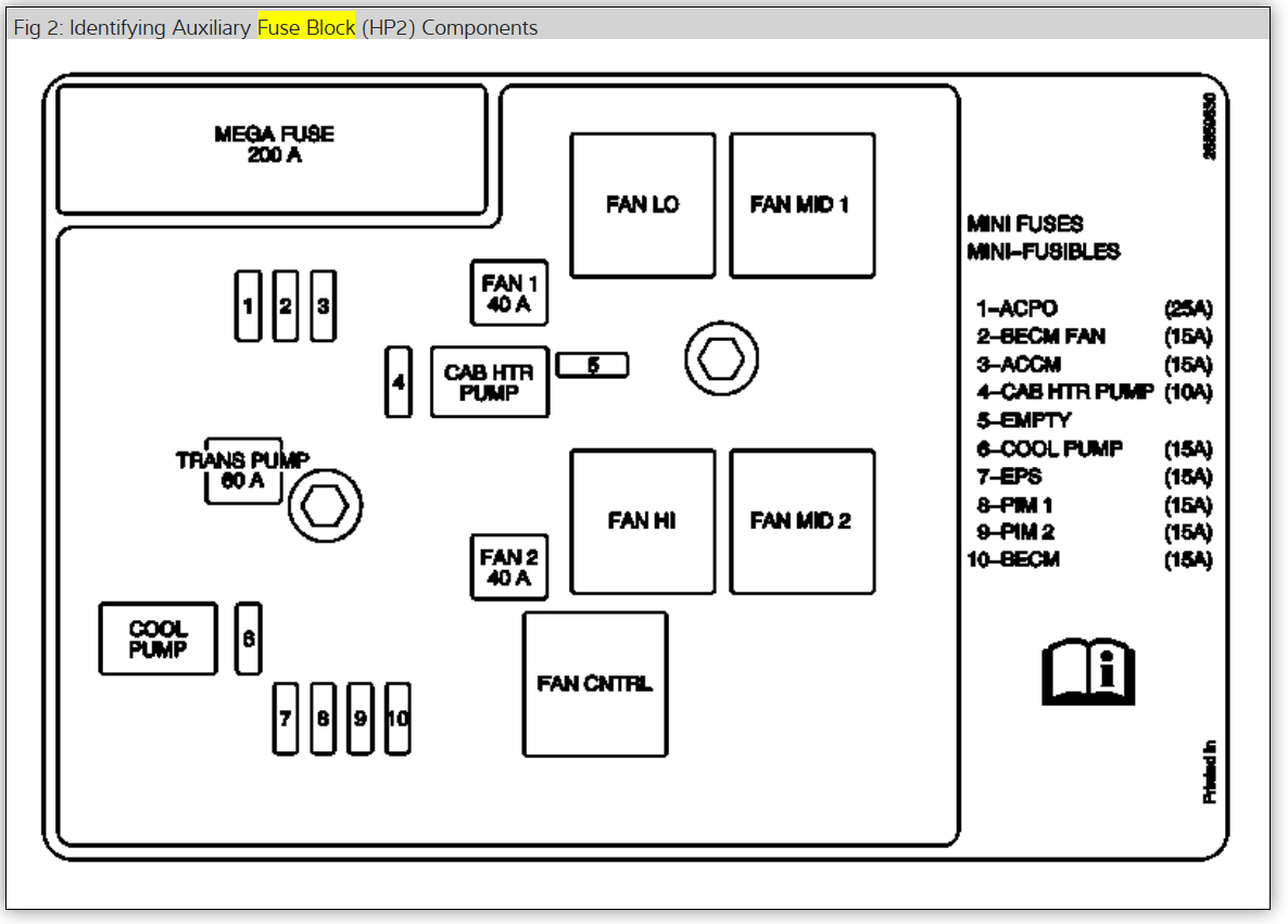

Please check the fuses as well.
Check out the diagrams (below).
Please run this test and get back to us.
Jan 2, 2018 at 11:12 AM
