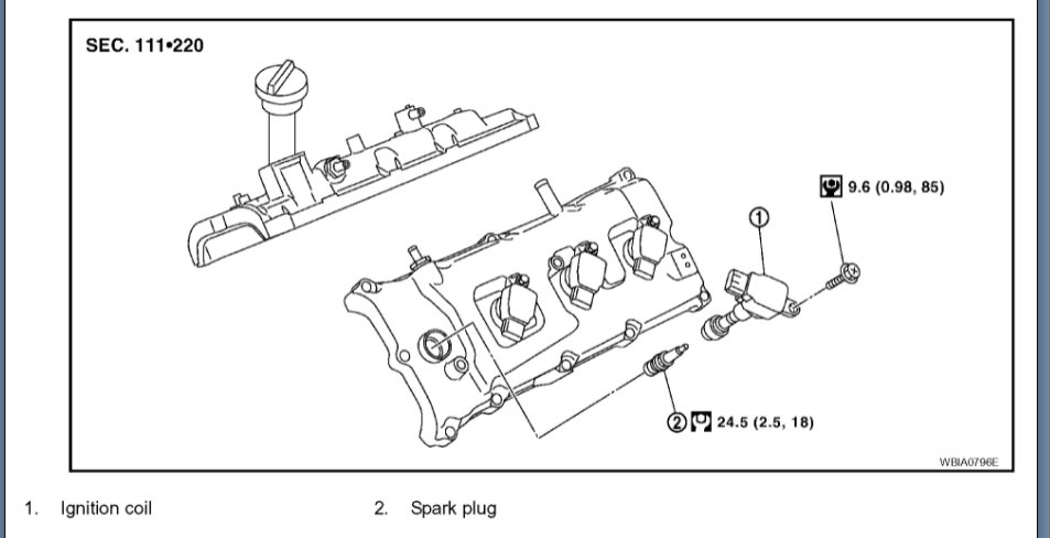

If that is okay, then we need to pull a spark plug and hold it against the block and find out if we have any spark.
I attached the info below to show this, but it is pretty simple on this engine as you just need to remove the coil. So, if you want to see if the coil is sparking to a good ground location on the engine block, then that would be fine.
Please see the info below on this and let us know what you find, and we can go from there.
