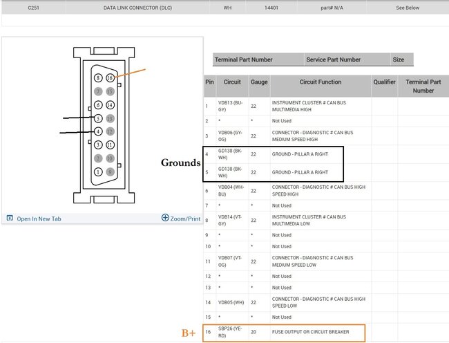

Hello do you have power at any fuses? And power at the data link connector pin 16? With engine replacements, ground wires can be left off by accident, you could do a quick test with some jumper cables, and run grounds from battery negative to the engine block and body of the vehicle, and see if it restores power, its a quick and dirty test, but it will at least give you some direction. Just use the jumper cables as ground wires, dont hook them up to any power of course.

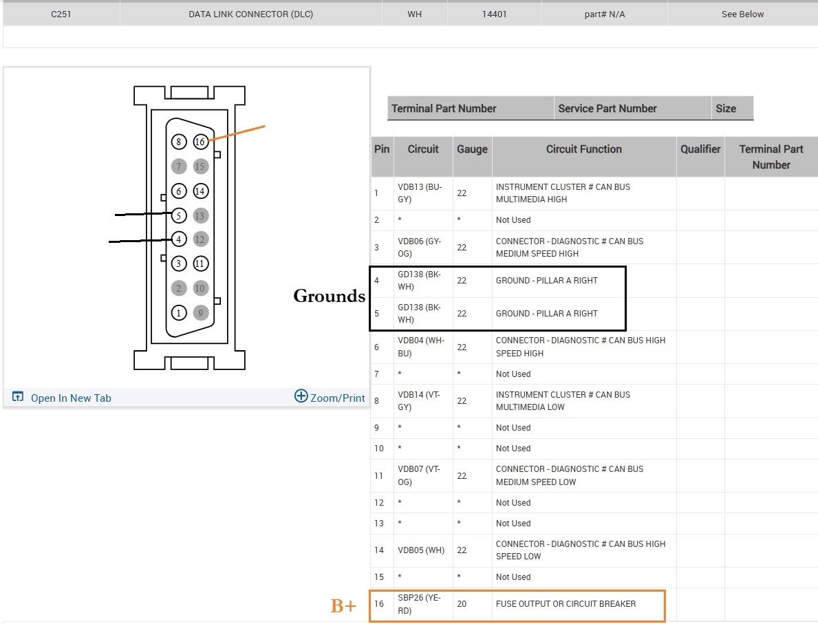

Heres a pinout of the data link connector.

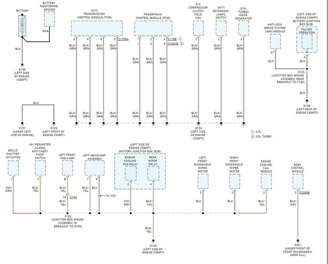

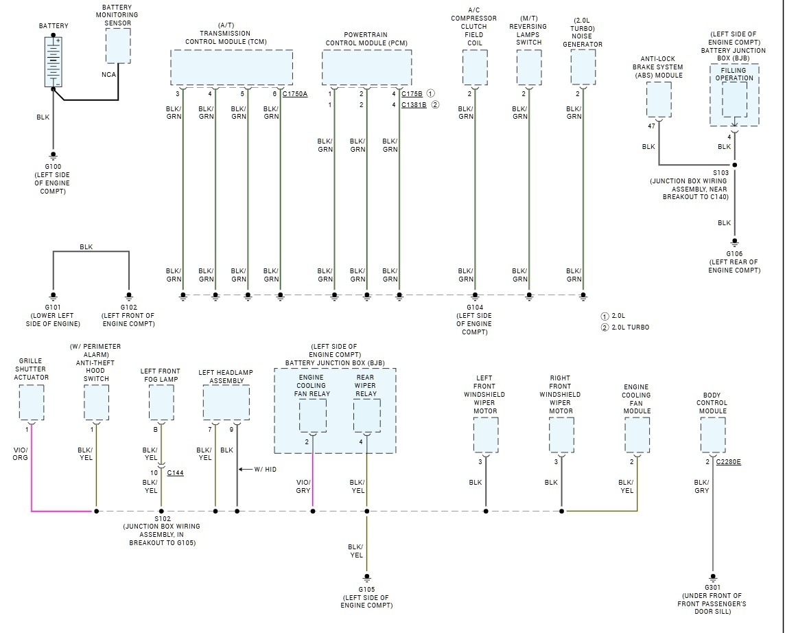

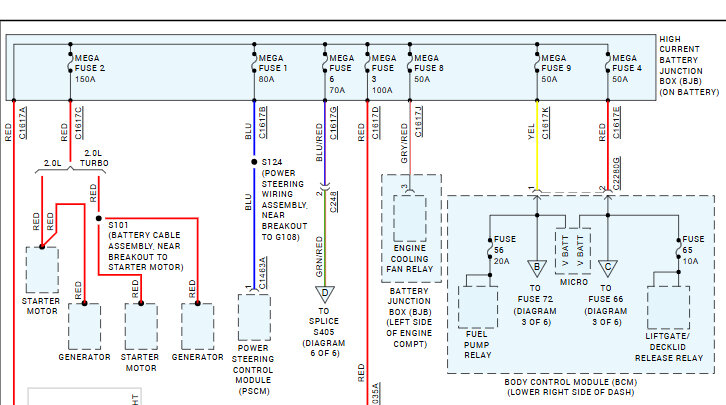

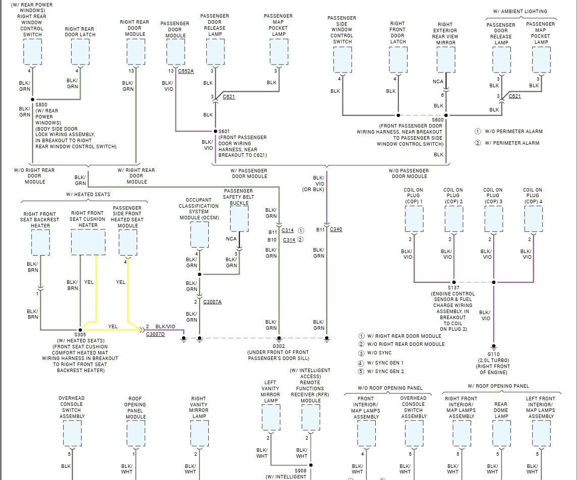

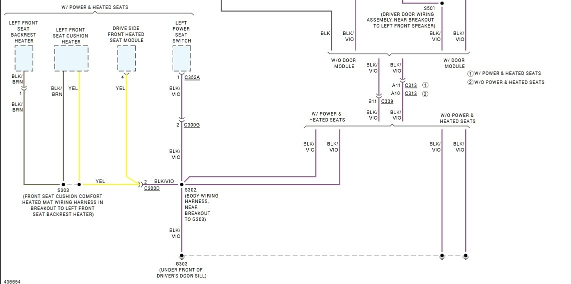

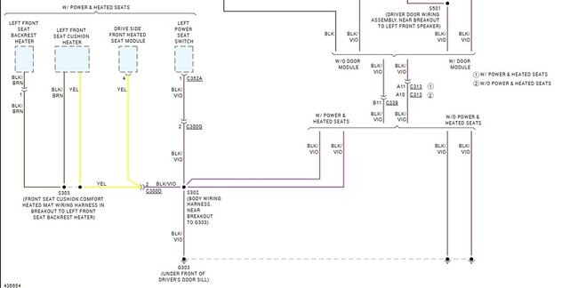

Yep, it sounds like you don't have a main system ground connected or one of the "mega" fuses has popped. Here is the location of the grounds and the mega fuses so you can check them out.
Check out the images (below). Let us know how it goes.

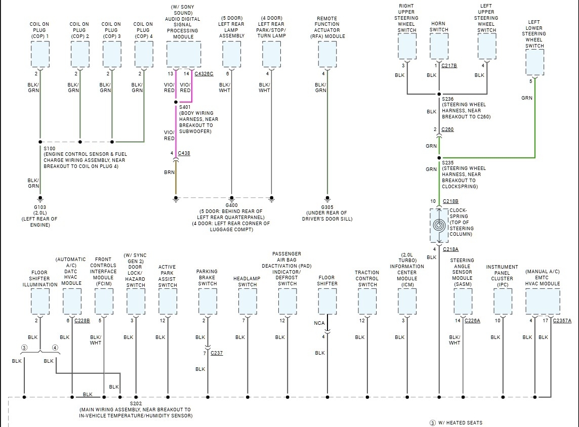

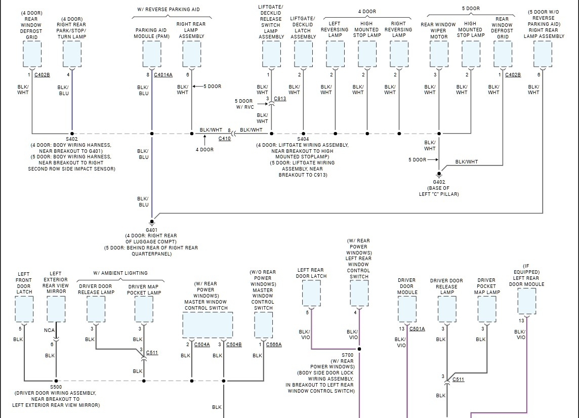

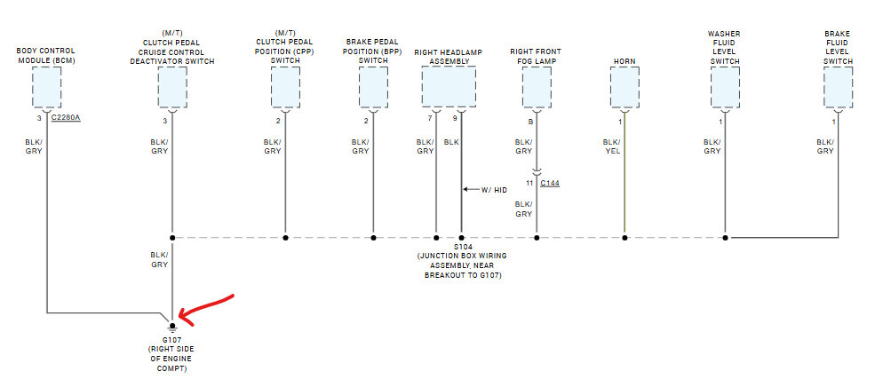

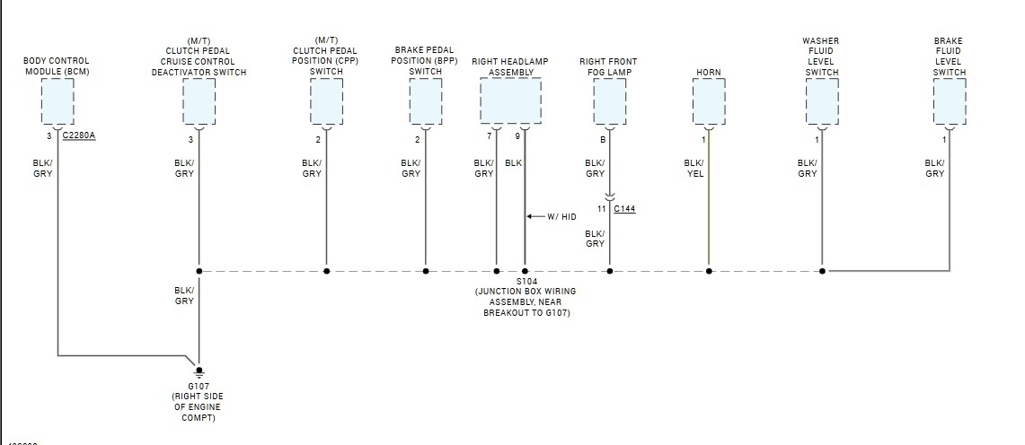

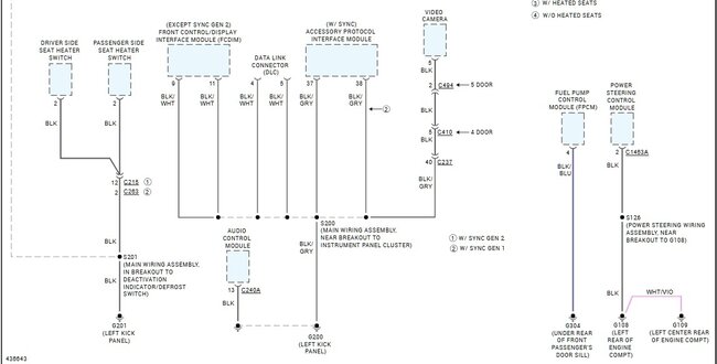

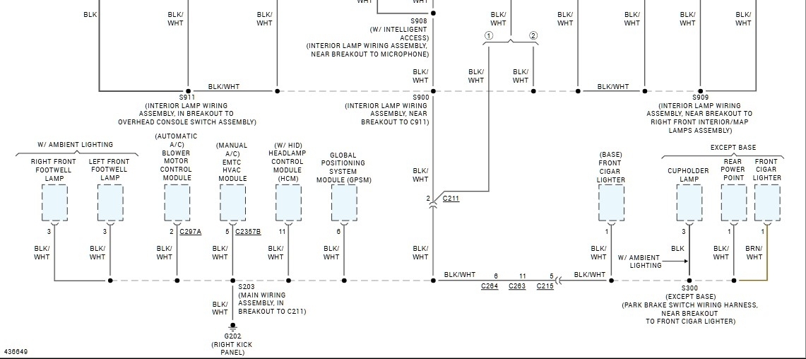

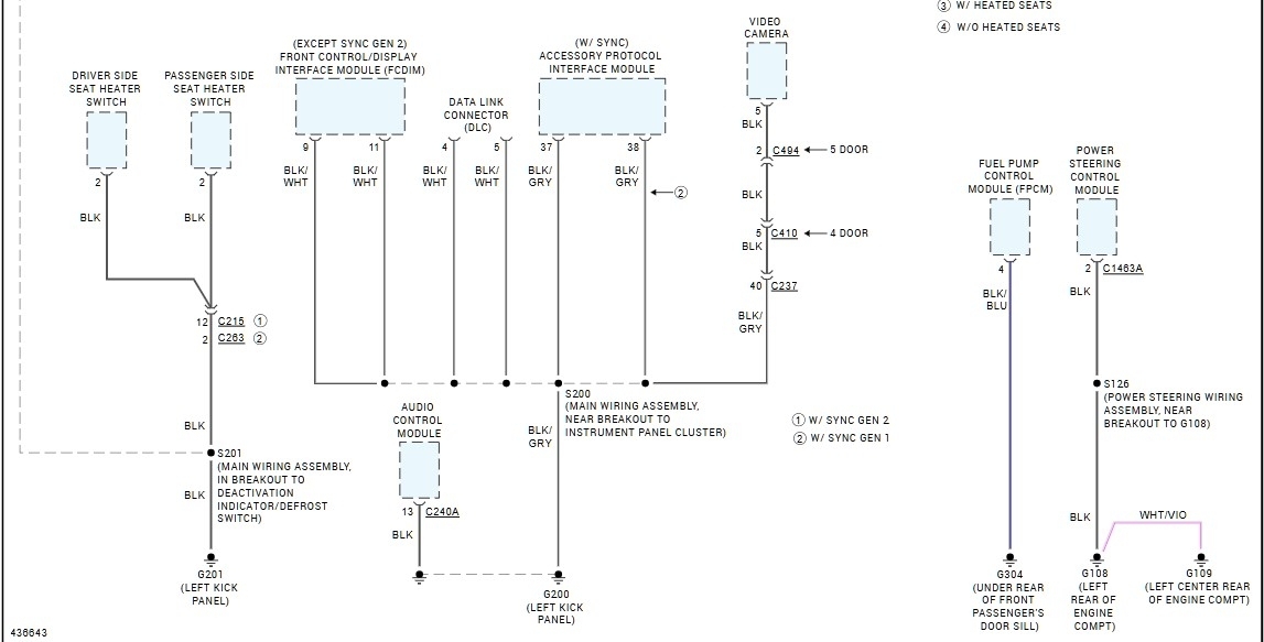

Here are all the Ground distribution diagrams, 1,2 top and bottom and so on.
