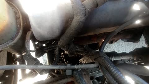

I have read up on possible other causes from blown piston to something as simple as the gasket going bad. What say you? I will add a video in a moment.

The vacuum leak could explain the hiss, the idle hunting or going up and down and even some of the misfiring, although I am wondering how the engine could have ran at all or even as well as you say with one bank having zero compression unless this just now happened.
I suppose you could have blown the head gasket in two spots between the front two cylinders on that bank and between the back 2 and the white smoke is actually the cooling being burnt in the combustion chamber. I would start with removing that head, checking and replacing the head gasket, fix that vacuum leak and see how that goes for now. Actually the head gasket will also have to be blown between a cylinder and the coolant jacket too in order for the white smoke and coolant being burnt.

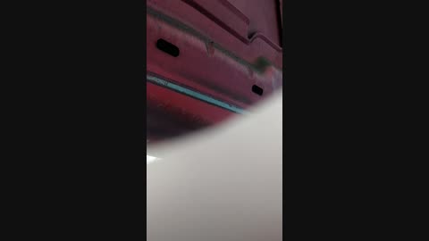

Video of exhaust kind of, lol.

You have a lot of blowby the piston rings, that is the reason for the steam/smoke out oil fill cap. It could be a broken piston ring or stuck oil control rings, or even clogged oil return holes in the head causing oil to backup and pool on top of the head, thus getting sucked in past valves and valve guides, even if the seals are good. Look for a leaking valve cover gasket, that is usually a sign them oil holes are clogged.
Did he show you the gauge on all them cylinders and if so, you must have watched him attach the gauge each time and crank the engine over with starter?
The steam/smoke might also or in addition to blowby, be caused by a blown head gasket between the crankcase passage and coolant and/or combustion chamber which leads me back again to removing that head to inspect the gasket and you might as well install new valve guides seals and check all the guides for any worn, that could suck in oil.

Sorry, I should have said tailpipe with the engine idling. I wanted to see if any smoke and what color if any smoke.
