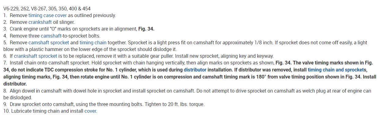

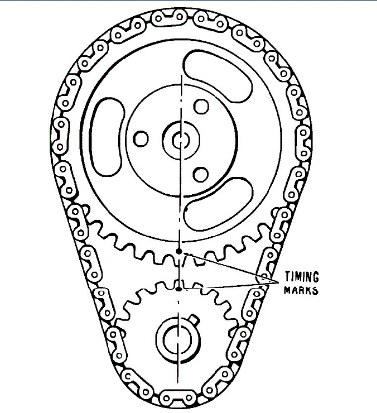

If you look below, I attached a pic of the timing marks and how they should be aligned. I don't know for sure what year the engine is, but the 350ci has been consistent.
Check this and let me know what you find. Also, if you could record it cranking so I can hear it, that may help me.
See pics below.
