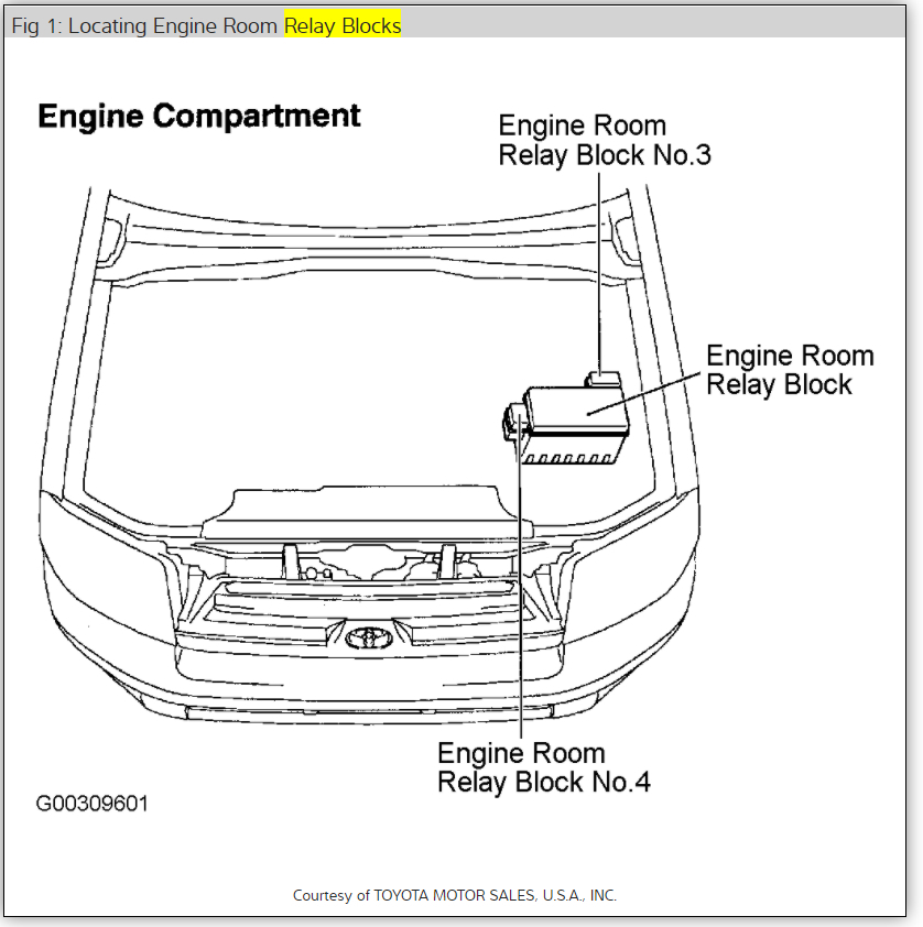

Car runs good but cannot scan it because of no communication with scanner.
Aug 19, 2018 at 9:05 AM
CERTIFIED EXPERT
53,854 POSTS

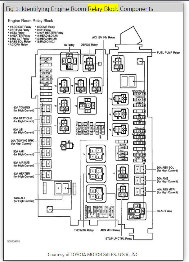

First make sure the scanner works on another car. Next check the OBD fuse under the hood. Here is a guide to help you with the fuse location and the wiring diagrams for the ALDL so you can see how then system works:
