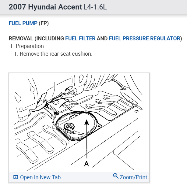

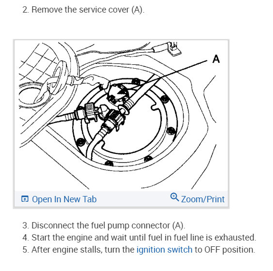

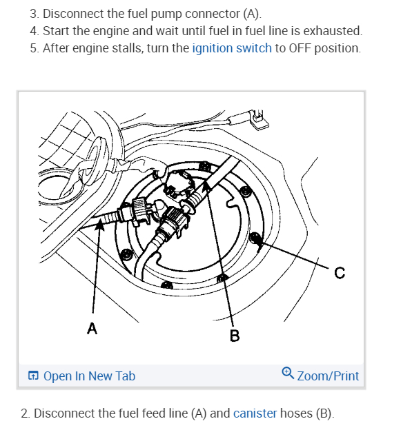

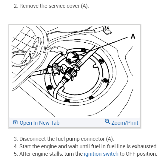

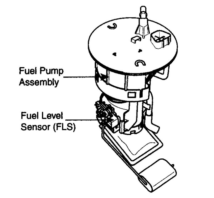

Since the car started running poorly after the fuel pump it sounds like a low pressure issue. I would replace the pump again with an OEM unit. Also reinspect the job you could have a line that is pinched off. This guide can help check the pressure to confirm with instructions below to show you how to replace the pump correctly:
