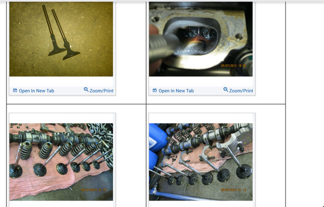

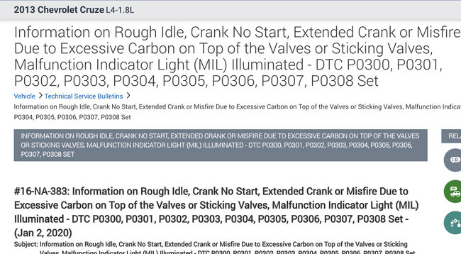

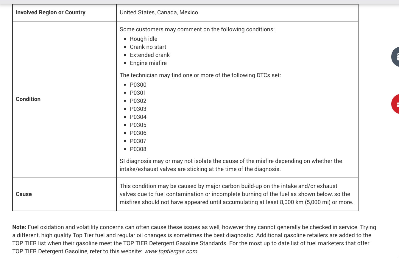

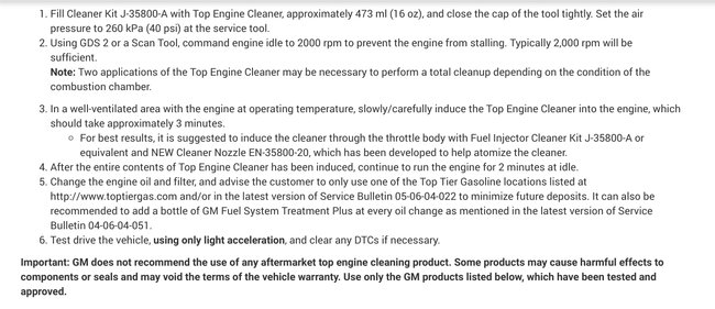

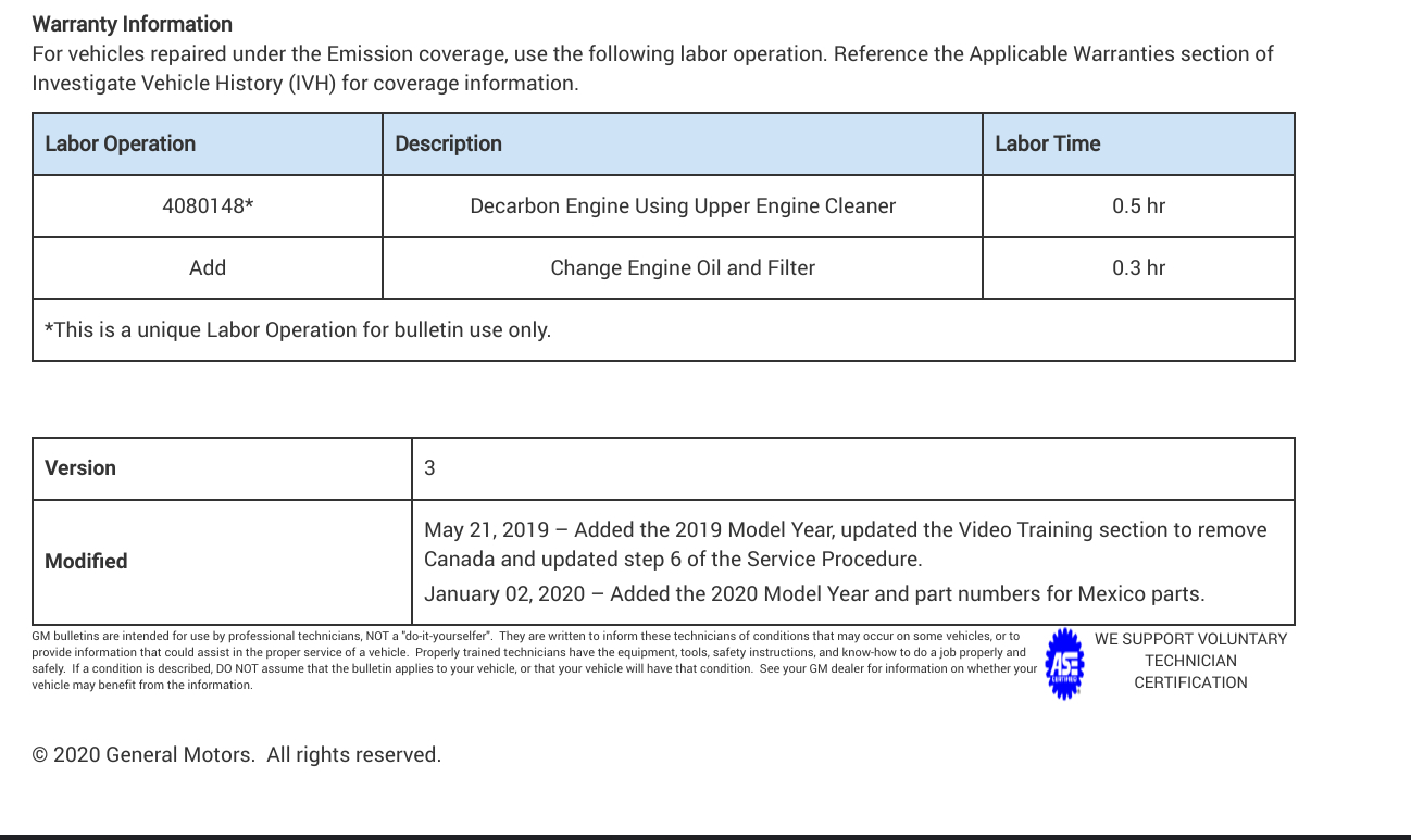

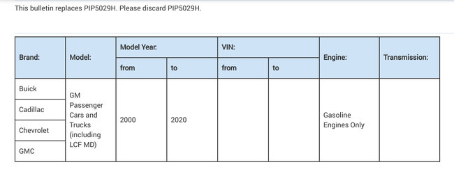

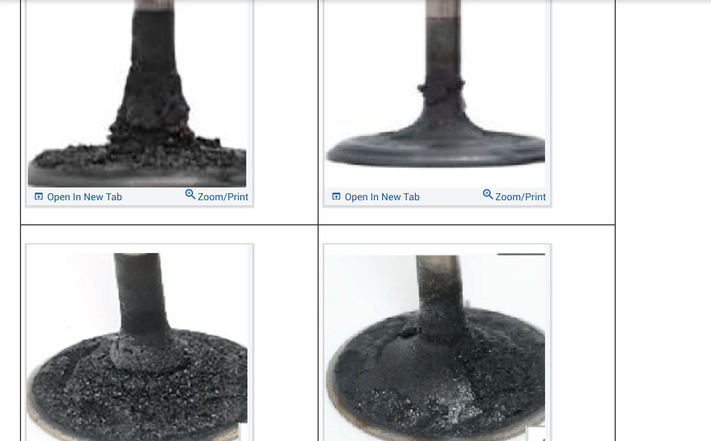

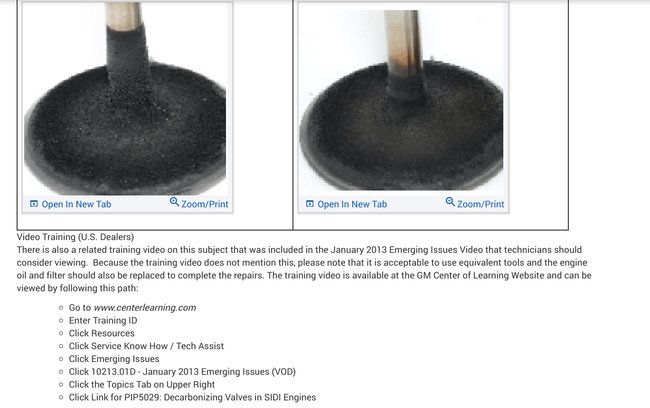

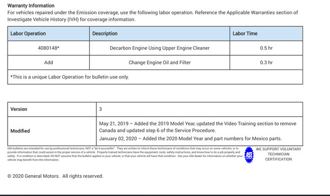

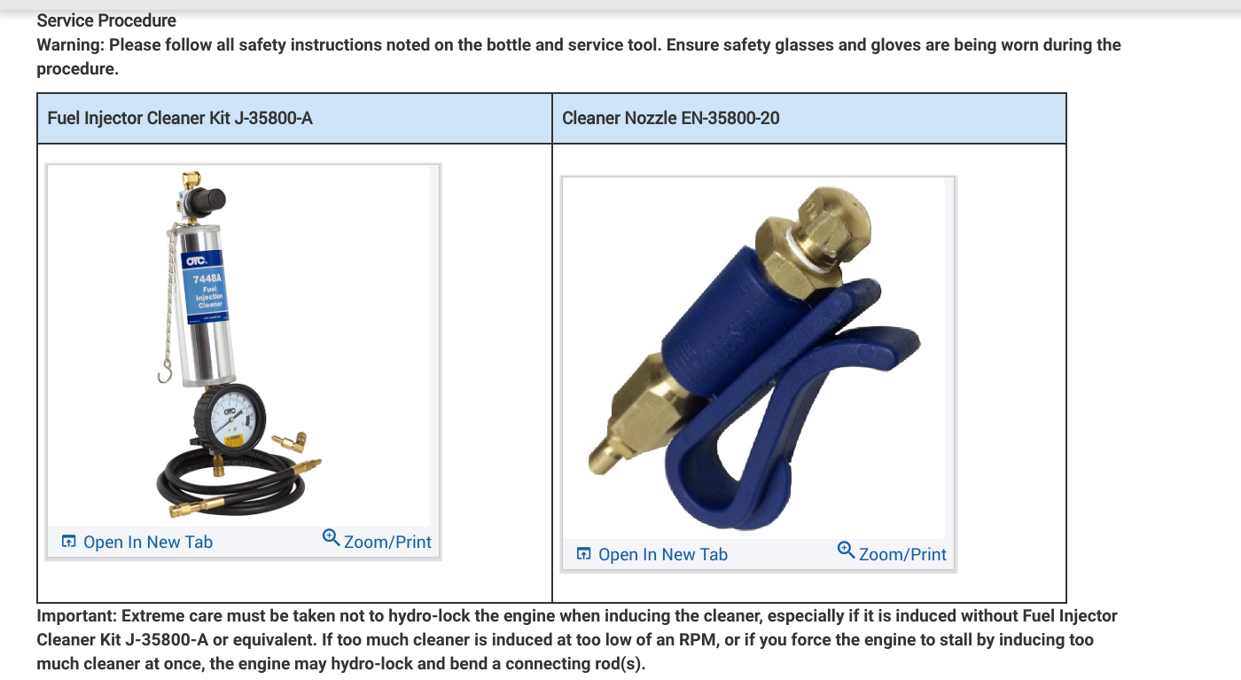

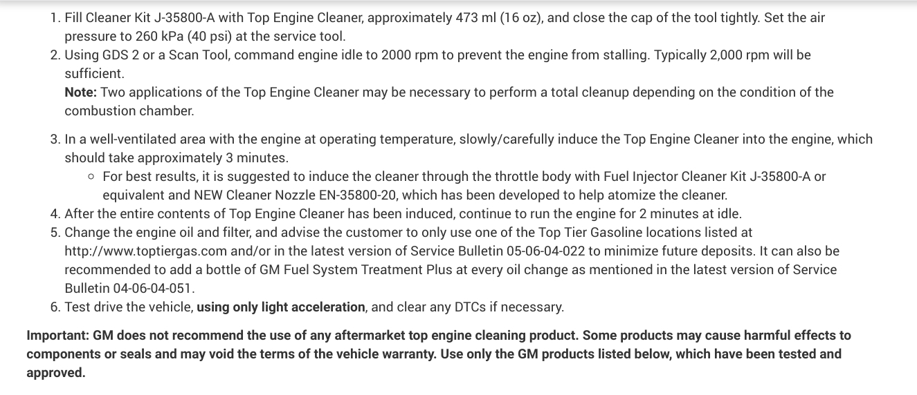

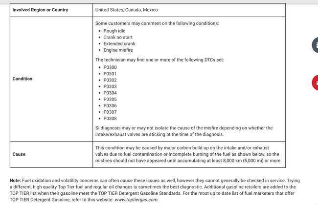

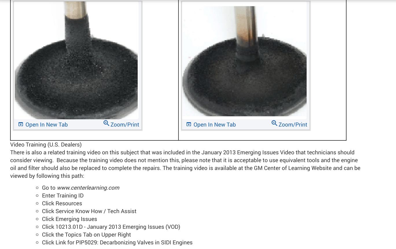

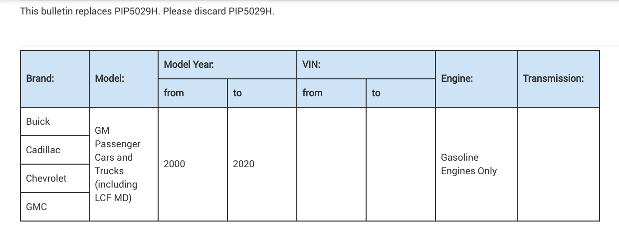

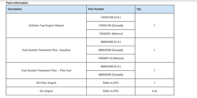

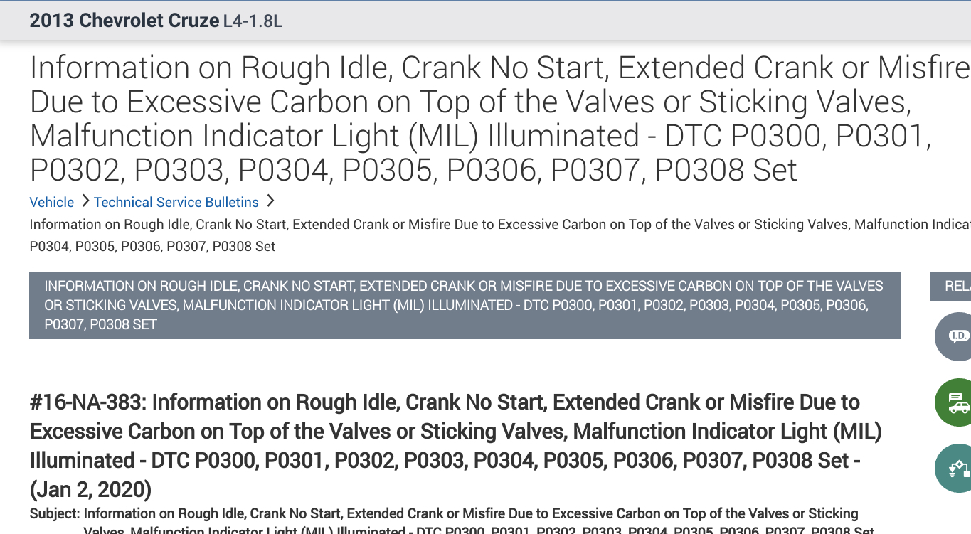

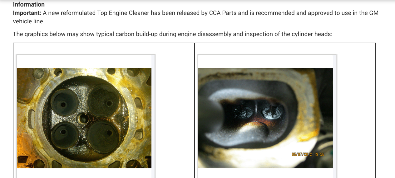

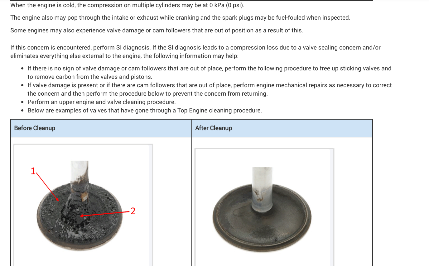

While researching this problem I came across this Technical Service Bulletin[TSB] for your vehicle's problem. You might want to contact your local dealership and talk to the service manager and see if you can get your vehicle fixed under warranty. Even if your vehicle's warranty is over, sometimes they can fix your vehicle and not charge you under customer locality. Please go through this TSB and get back to us with how everything turns out. I hope that this helps out.
Thanks,
Alex

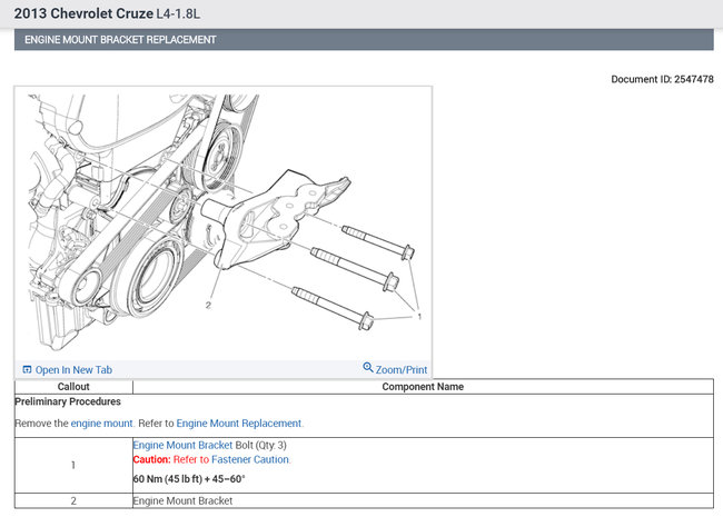

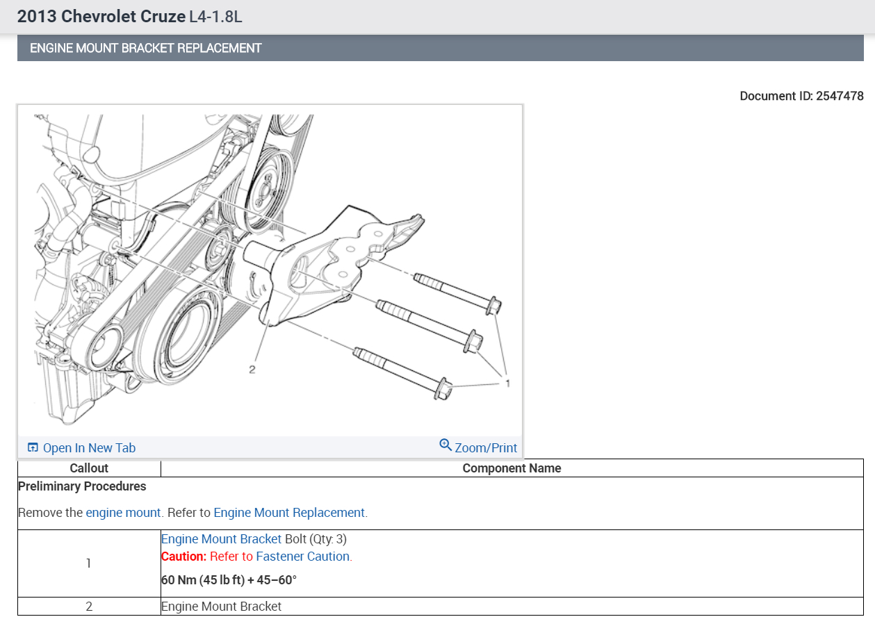

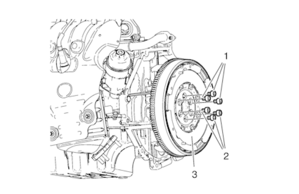

Yes it will, but I asked my buddy who works at the Chevrolet dealer he said these cars have issues with the engine mounts failing apart which can cause the vibration. Here are the instructions for replacement and inspection. Use a flashlight to inspect the harmonic balancer and look for anything shiny, rubber hanging out something like that. Check out the diagrams (below). Please let us know what happens.
Mar 20, 2020 at 11:12 AM
TOUGHDIVER
  • 224 POSTS

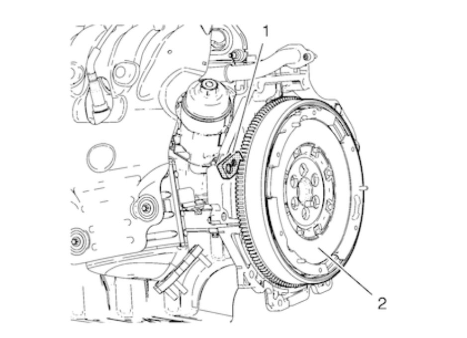

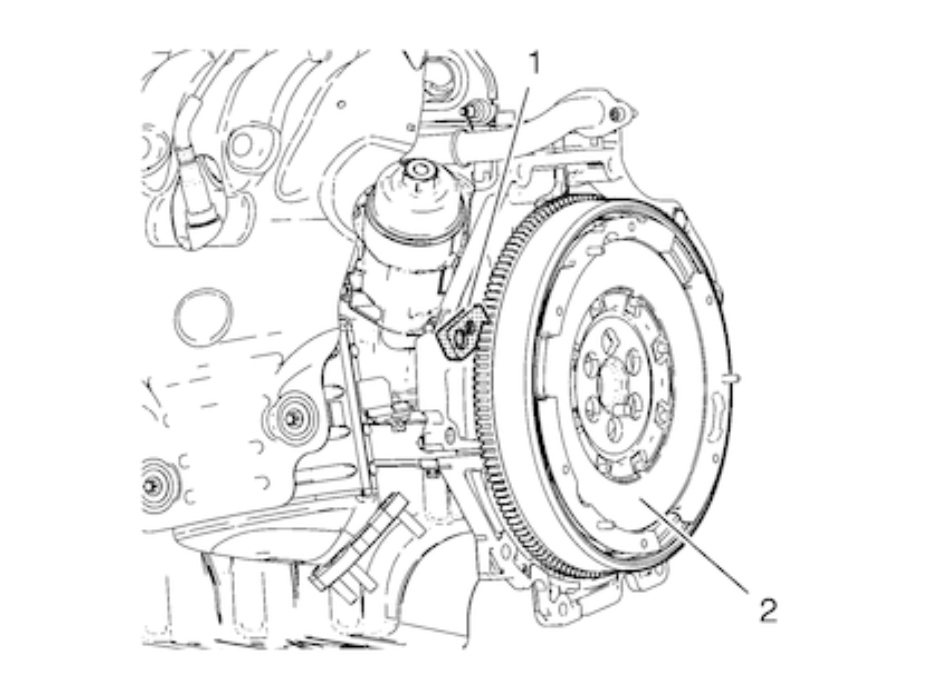

It could also be a engine flywheel that has excessive lateral runout, when combined with the extra mass of the clutch pressure plate and clutch driven plate, can produce a disturbance.
The clutch pressure plate and the engine flywheel are marked for proper indexing of the heavy-spot of one to the light-spot of the other. Improper indexing of the pressure plate to the flywheel can produce a disturbance.
An engine flywheel that is loose at the engine crankshaft or that is cracked, damaged and/or missing balance weights; and/or a clutch pressure plate and clutch driven plate that has loose springs, cracks, warpage, damage and/or missing balance weights – can produce a disturbance when their mass is combined. I'm attaching flywheel and clutch replacement below. Let us know if you need more information.
https://www.2carpros.com/articles/clutch-symptoms
https://www.2carpros.com/articles/how-to-replace-a-clutch
Thanks
Joe T.
