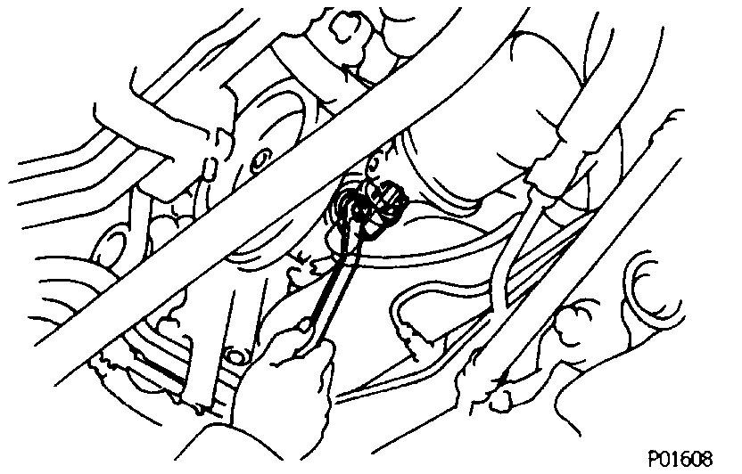

3. Disconnect crankshaft position sensor connector.
pic 1
4. Remove the bolt and crankshaft position sensor.
