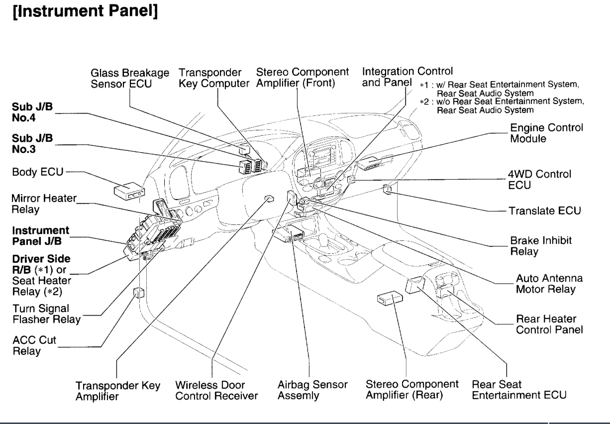

The first code is the clue C1203.
DTC C1203/95 is output when an incorrect ECU is installed
Did this car get a new computer or? It could be the ECU went bad as well here is the location so you can check the electrical connector for corrosion. Check out the diagrams (below). Please let us know what you find. We are interested to see what it is.
