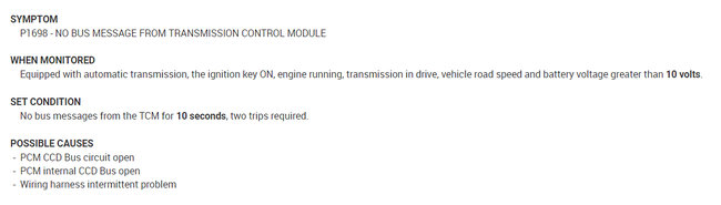

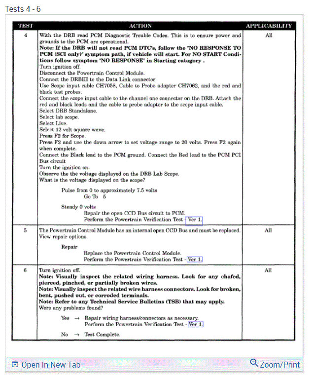

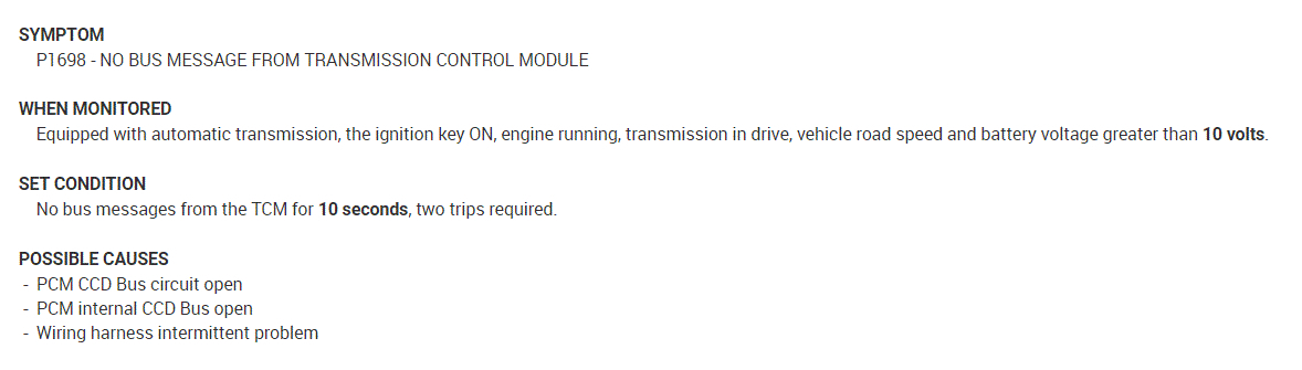

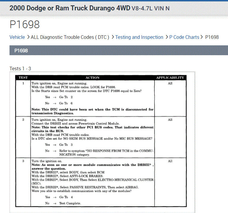

Do me a favor. Take a look through the attachments below. They are the diagnostics for a P1698. Let me know if this is something that you are comfortable doing.

See pics below.
