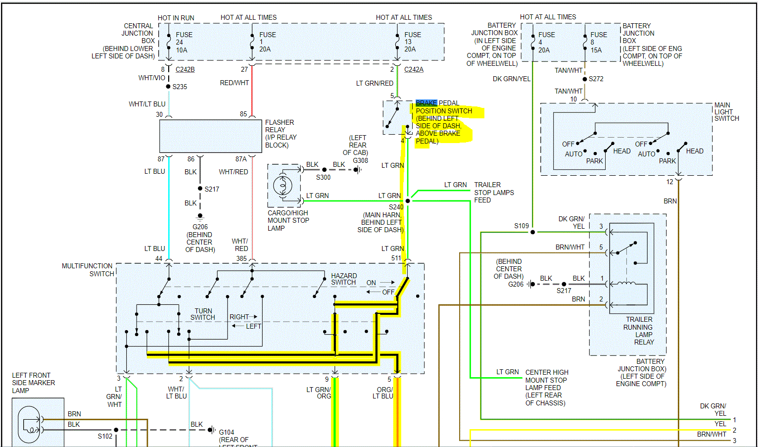

I have the truck listed above sd. my left turn signal started buzzing on me and stopped working. I checked all the fuses and changed a few and then my brake lights went. checked all the bulbs, the wiring and all that then my bright lights wouldn't cut off. Finally got them to cut off but I still have no left turn signal and no brake lights and the buzzing is still there. I've taken off the signal handle and cleaned it with contact cleaner and nothing still!! Please help any suggestions would be greatly appreciated!!

My first question is where is the buzzing coming from? If it is coming from the steering column, I suspect it is the switch.

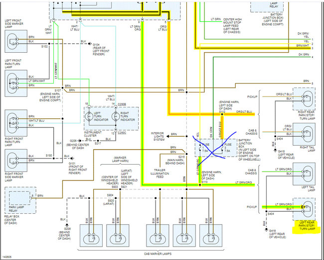

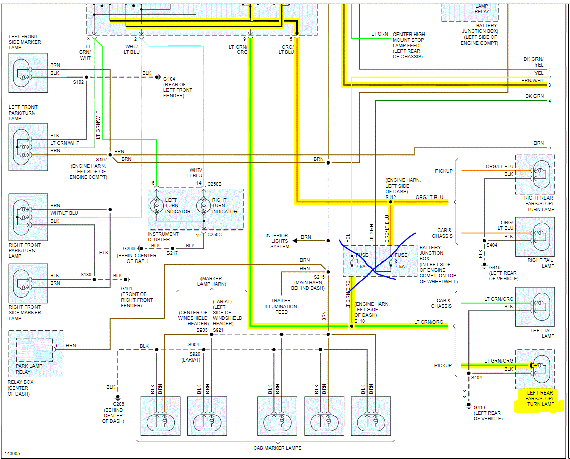

I attached the wiring schematic below. Note that in pic 2, I placed an X through a section of wiring. That wiring goes to the trailer wiring schematic.
Now, if you notice in pic 1, there are two fuses that provide power to the signals flasher. I don't feel at this time that is the issue because the right side works. However, if you look to the right, you will see the brake light switch. Note that it provides power to two locations on the multifunction switch (signal switch). In the switch, power from the brake light switch is distributed to the left and right lights in the rear via two separate wires/circuits in the switch.
I have a feeling that the connections for the left light which is built into the switch, has failed. You can check for power out to the light green wire at the switch when the signal and brakes are turned on. That will confirm if the switch is bad.

See pics below.

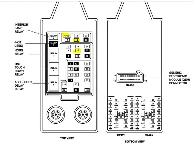

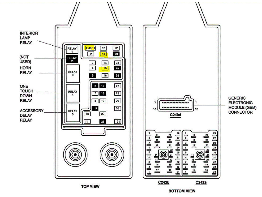

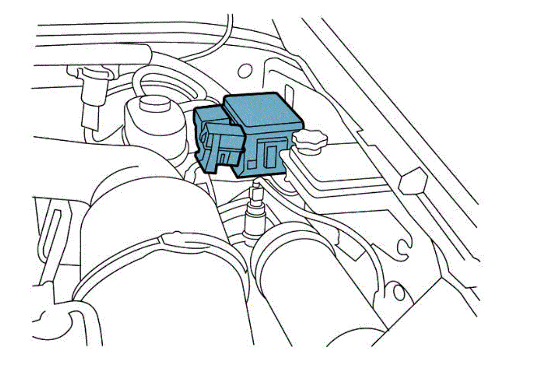

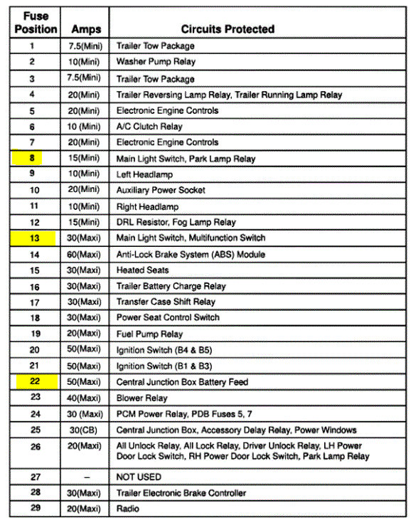

Here is the link again for testing a fuse. It explains what to do. You could have a good fuse and no power to it.

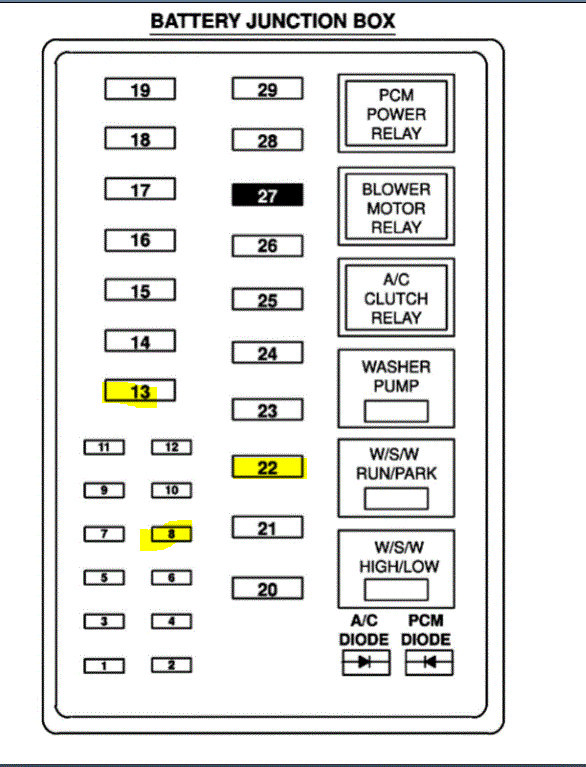

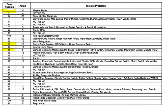

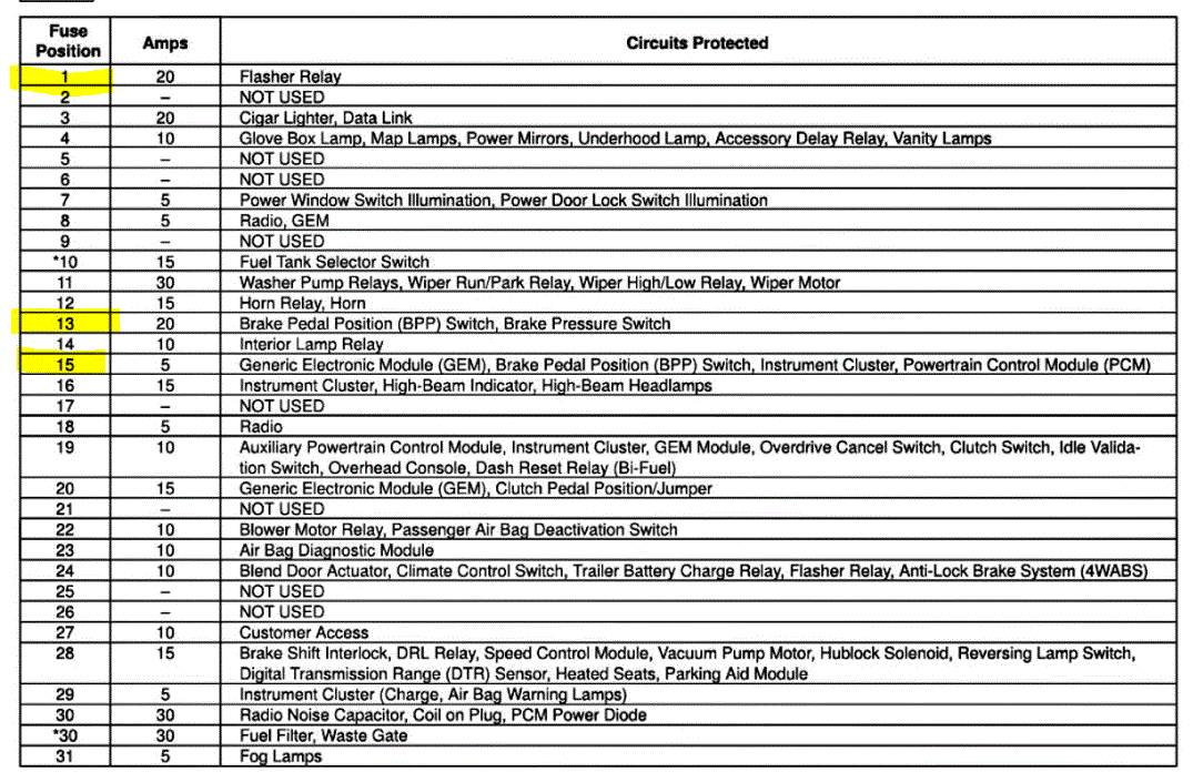

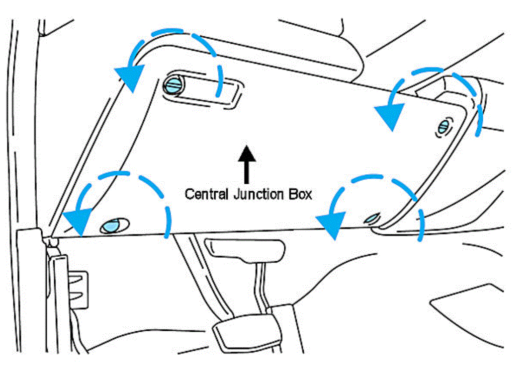

As far as the fuses, I attached the info below for you. First is the underhood fuse/battery box and the second section is the central junction box in the vehicle.
I attached three pics for both. One pic shows the location, one shows the layout and numbers of each fuse, and then the legend (what each fuse is for). I highlighted the fuses to check and highlighted what they are for on the legend.
Let me know if that helps and what you find. Also, please feel free to ask questions if you have them. If I can help, I will.
See pics below.

I did have a couple of bad fuses but not to any of my lights ones (I did not check the number 15 yet will do that here in a minute) I now have everything except for the cluster lights, come to find out it was the new LEDs that I put in (which i put in everywhere) but for some reason when i put the original blinker light back in the front everything started working fine. Even though everything has the LEDs. But still no cluster lights. Can't thank you enough for all of your help so far!

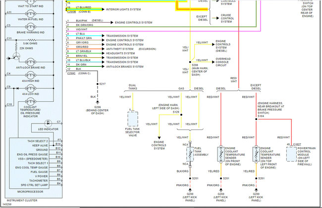

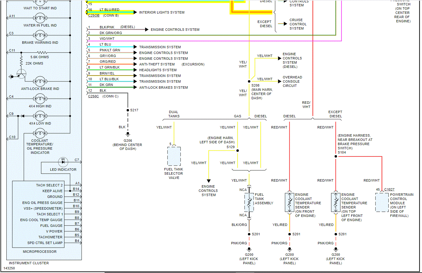

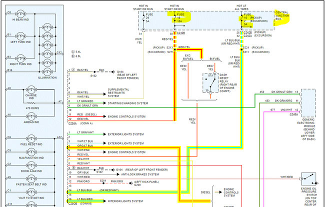

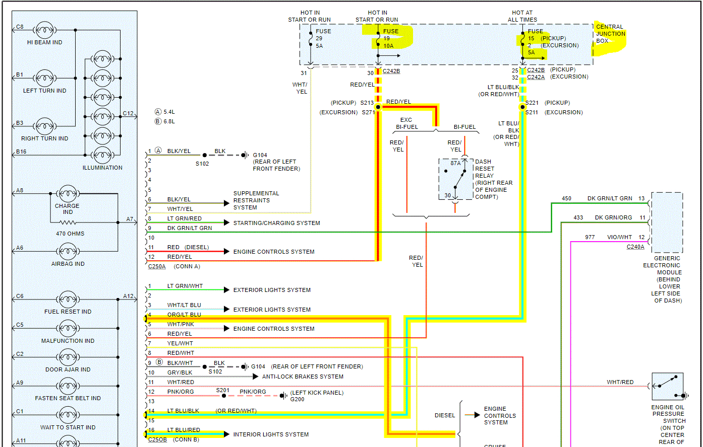

Absolutely no problem whatsoever. Have you checked fuse 15 yet? That powers the instrument panel lights.
I attached the wiring schematic below for the IC. Take a look through them and let me know if that fuse is good. Also, make sure to confirm power to the fuse.
